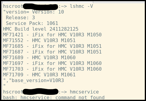

    • There is no 'F30' to press.
    • There is no "hmcservice"
    • Your AI-generated slop has no place here.

    --> But I never heard about hmcservice command, in that you are right.
    maybe a hmc cli command is meant here, but I don't know the command either.
    Follow Command exsist to reboot HMC on CLI Interface.
    hmcshutdown -t now -r  reboot the HMC (-t: timing in minutes, -r: reboot)

    hmcservice is not a valid command ( as many have pointed out).
    You can use the hmcshutdown command -
