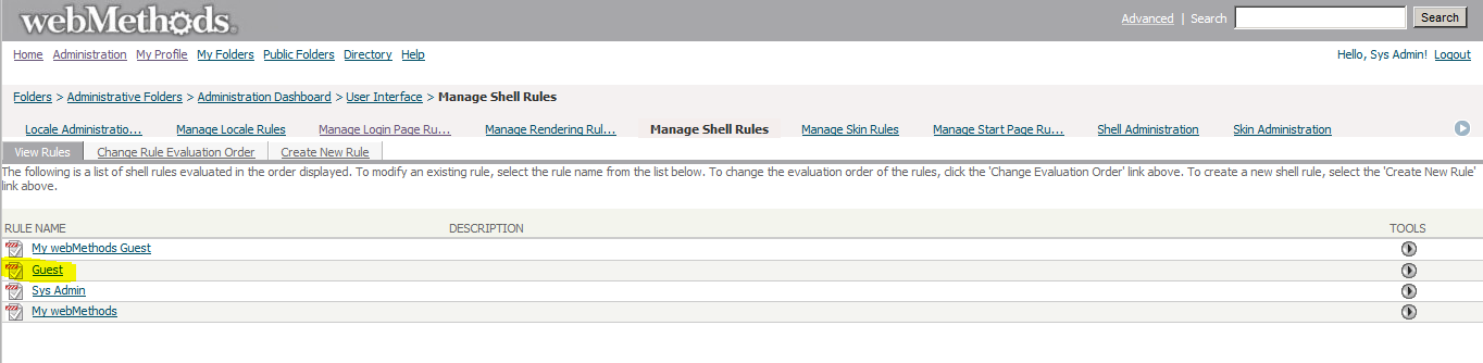

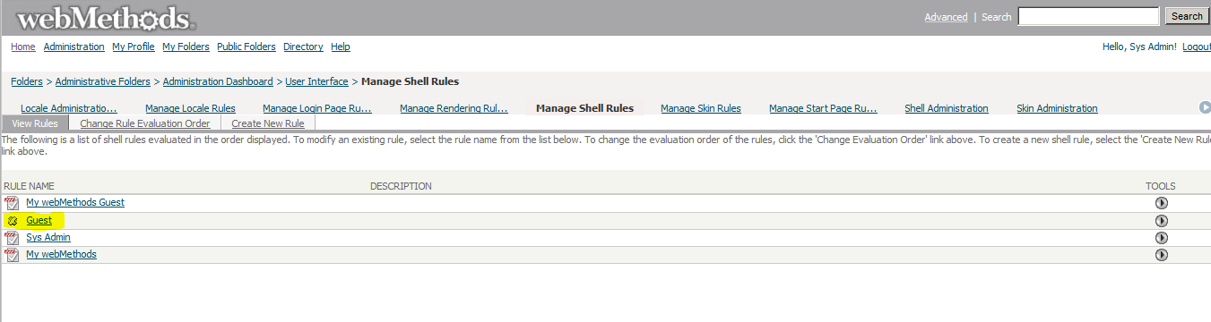

    I tried checking on those things.
    For now I am able to work on the MWS with Administrator user( I changed the password for this user from Sysadmin profile). But for “monitoruser” I am still facing the same issue.
    I am providing here the SS for the working one and the affected one.
    I am able to see the difference in Guest Rule, but I am not sure how to set that. If it is possible could you please help me with that.
    Please find the SS of Manage Shell Rules below:
    I have compared the “manage skin rules” and “manage start page rules” and I don’t fine any difference. If required I can provide the SS of that as well.

  • 10.  RE: Header and footer page not showing up in CAF page with sysadmin login
    Posted Tue July 11, 2017 12:51 PM
    Hi Priya,
    the icon should not be an issue.
    The evaluation order can be found on the next tab.
    The most selective ones should come earlier than the others.
    Regards,

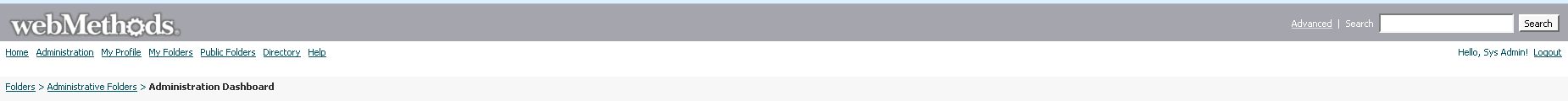

  • 11.  RE: Header and footer page not showing up in CAF page with sysadmin login
    Posted Wed July 12, 2017 02:03 PM
    Hi Holger,
    Checked with the evaluation order also.
    When compared with the working one, did not find any difference.
    Also, attaching the scree shot of the page I am getting when logging in using ‘monitoruser’.
    Regards
