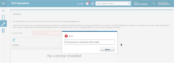

    Hi everyone!
    I've been working in Guardium V11 Demo and i realized that collector don't have the license installed so the GUI is limited to a few functions only.
    I read here in the community about the license should be installed only en CM, is right?
    I got an error trying to install the collector license in the collector itself :"The license Key is missing the LICR number" but the license i tried to install is the correct one. ¿?
    Thanks.
    Alex.

  • 6.  RE: Guardium v11 - Collector license
    Posted 06/01/20 10:55 AM
    Good Day Mark! Thanks for your help.  I talked with the person who downloaded the product and the key. It's a demo version and the key was downloaded from a Partner site.
    https://www.ibm.com/partnerworld/program/benefits/software-access-catalog.
    Redirects to ->
    https://www-03.ibm.com/isc/esd/dswdown/xxxxxxxx
    From the collector GUI :
    The license came in a bundle with the software. I'm a little confused, it shouldn't give that error. Any hint?
    Thanks and regards!
    Alejandro Diaschi

  • 8.  RE: Guardium v11 - Collector license
    Posted 06/02/20 09:39 AM
    Edited by Alejandro Diaschi 06/02/20 09:43 AM
    Good day! Mark, unfortunately i don't have other server or apliance(collector) to check it. My architecture is only :
    1 Aggregator
    1 Collector:
    1 DDBB Server
    I checked the license in the collector server mentioned via cli and the result is :
    <cli>license check (milicensenumber)
    License check OK.
    ok
    and then when i run..
    <cli>store license (milicensenumber)
    error: The license Key is missing the LICR number.
    License key has not been applied successfully.
    err
    Same error than GUI and i don't know why. Yes, the first use with this license. Maybe I should consider contacting the support as you said.
    Thanks for your support.
    Alejandro Diaschi
