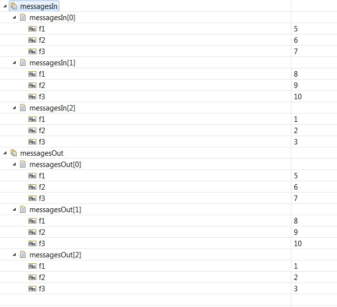

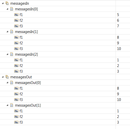

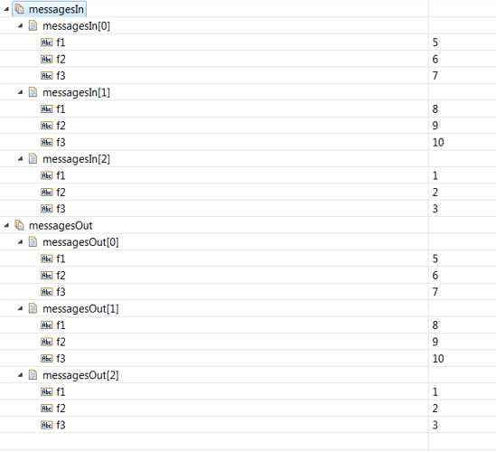

    I’ve attached 3 snippets - 1 shows the variables after the MAP step using For Each in DEBUG mode
    1 shows the mapping itself
    1 shows the results after the For Each MAP when just running the service without DEBUG

    So when you run the service it works perfect correct ie run-time wise?
    Can you try having it without it as transformer and see how it works in debug mode and wire all the fields source to target to see if that resolves the oddity?

  • 5.  RE: For Each Transformer in DEBUG
    Posted Fri June 09, 2017 07:38 PM
    Diane,
    What is your webMethods version with fix levels.
    When wM9.12 was released initially (without any fix levels) there was a note in readme about FOREACH - Debugging of ForEach mapping is currently not supported. I assume due to this you may have unexpected output during debug mode only.
    You may have to check with support if they have released any fix for it.

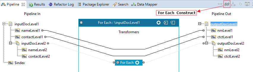

    For Each is an option (not a service component) available in the MAP (as transformer) and can work against arrays (the string list or document list).
    #Integration-Server-and-ESB

    Here you go
    You can check this link for quick demo 4 Game Changing Development Features in webMethods 9.12 – Integrate or refer to SAG docs.
