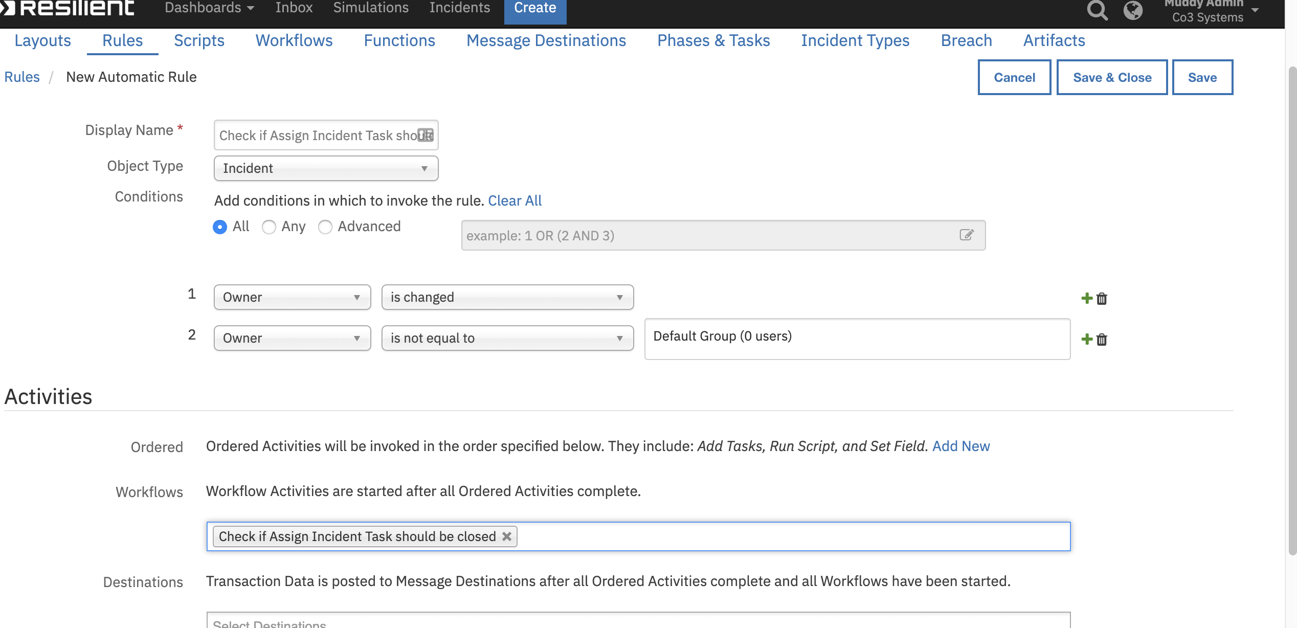

    Unfortunately the current in-product scripting won't help for this scenario. The reason is that the in-product scripting does not have access to the tasks for an incident rule (e.g. when an incident changes).
    You would have to use a workflow with function. The function, which would run outside of Resilient (inside Resilient circuits) would make a query for open tasks for the incident, find that specific task, and then close it if appropriate.
    So maybe set up an incident rule like this (see attached screenshot).
    The function would send the information off to a function. The function would query the tasks and close it as appropriate.
