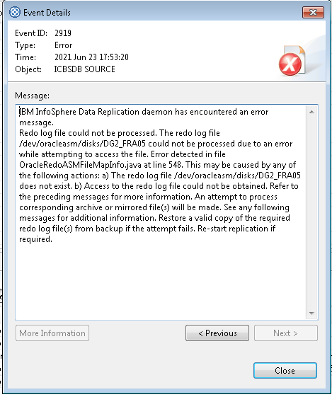

    Situation:
    Mirroring failed. It is a bookmarking method. The error messages are as following:
    redo log file
    I referred to the IBM support website. (InfoSphere Change Data Capture for Oracle Replication - A fatal error has been encountered while processing a redo log...Redo log file information not found. (ibm.com))

    Refresh is not an option for my case. The database user have "alter any table" privileges. Anyone know about this issues? Please help me if anyone have any idea. Thank you.

    You have tested that the Oracle database metadata knows about the log.
    The log file itself may not necessarily be present in the system - it may have been removed and the Oracle metadata not updated.
    Or the CDC user in the OS may not have read permission to the log files.
    Typically the CDC OS user would be a member of the dba and/or oinstall groups to ensure that it has read-only access at least to Oracle objects include log files
