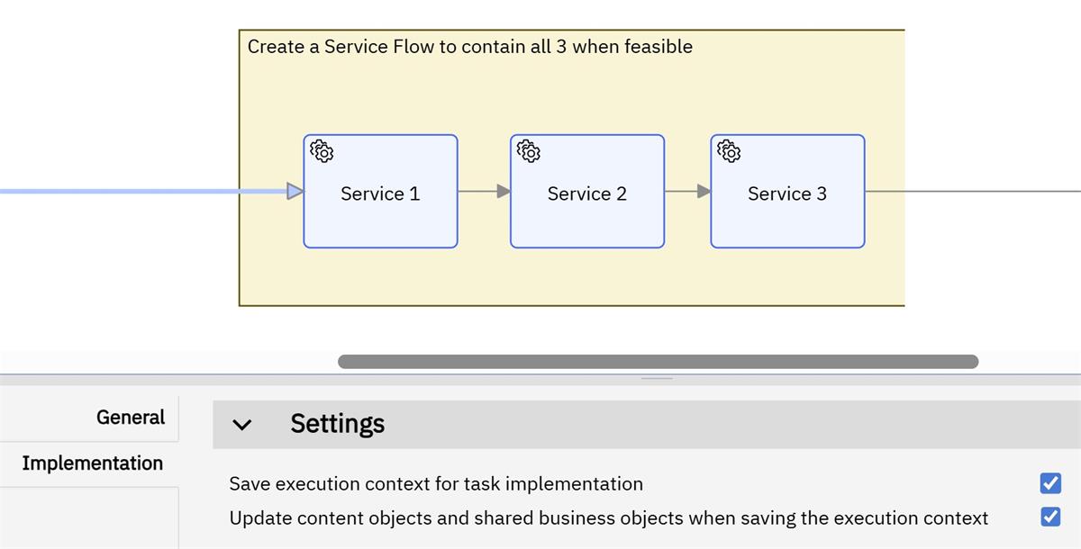

One subtle point to be aware of: if the connection leading to a Service Flow has Save enabled, the save operation is included with the Service Flow request. This avoids a second round trip, which is good, but if you’re measuring request times in the network profile, the numbers will include both save and Service Flow execution which can skew timing comparisons.
In some designs, saving task progress is the reason Service Flows are called individually from a CSHS. Since saves are only supported on connections in the CSHS diagram, any requirement to save between Service Flows means those Service Flows must be invoked from the CSHS with saving enabled between them.
Consolidate multiple Service Flows into one
