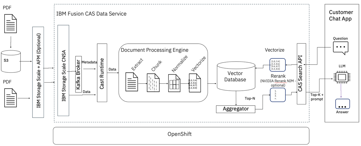

Semantic Search in IBM Fusion CAS
CAS search
As shown in the above figure, CAS uses the nv-ingest pipeline from NVIDIA to vectorize the chunks, and uses the llama-32-nv-embedqa-1b-v2 model to embed the chunks into 2,048 dimensional vector embeddings. The chunks are inserted into a ParadeDB instance and a DiskANN index is built on the embeddings using cosine similarity as the metric for nearest neighbor retrieval. At query time, the natural language question from the user is converted into an embedding and a vector search is applied to fetch an expanded set of top-N results (where N > K). A BM25 index is dynamically built upon the top-N results and a lexical search is run to score the top-N results. The scores from lexical search for all the top-N results are combined with their initial vector search scores using an aggregator.  Then, an optional re-ranker consumes the results along with their aggregate scores but re-ranks them based on cross entropy loss which is the logit score. Finally, a subset of the top-N which is top-K (where K < N) is returned using a weighted combination of  the earlier aggregate score and the logit score. The pipeline uses llama-32-nv-rerankqa-1b-v2 as the optional re-ranker. The top-K results are passed to an LLM as additional context along with the prompt (which is the user question) in a RAG pipeline. It should be noted that we evaluate CAS search w.r.t. how effective the top-K results are before they are passed to the LLM.
Typically, we use a value of N=100 to perform an expanded search for a target top-K value of 5, 10, 20, 50 etc..

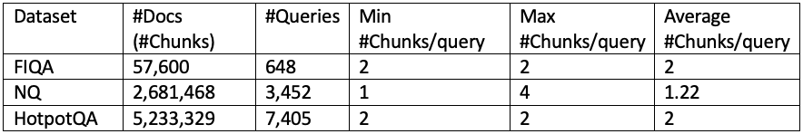

Evaluation Datasets
datasets
We chose three diverse datasets (as shown in the above table) with varying number of documents and queries used for evaluation. We followed the same chunking mechanism detailed in the BEIR arXiv paper for a consistent comparison with the recall numbers reported in the paper. On an average, the three datasets have 1 to 2 chunks per query in the gold-standard ground truth (expected result set) as shown in the table. This makes the search task highly selective and reasonably challenging.

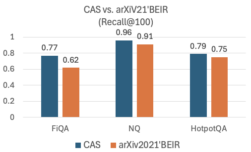

1. Comparison against the BEIR arXiv paper
We compare the question answering (QA) accuracy - recall@100 obtained by CAS against the best recall numbers published in the BEIR arXiv paper. As shown in the figure below, CAS surpasses the baseline significantly on the FIQA dataset and noticeably on NQ and HotpotQA. Following are the reasons for its better accuracy:
  1. Semantic search using DiskANN as the vector index is superior to the best performing methods reported in the paper which are
    •      BERT-based language models such as ColBERT (on NQ and HotpotQA).
    •      GenQ which is a transfer learning model (using unsupervised domain adaptation on synthetically generated data) on FIQA.
  2. NVIDIA embeddings generated by CAS feature 2048 dimensions, capturing language semantics more-effectively than BERT-based models which are limited to 768 (BERT-Base) or 1024 dimensions (BERT-Large).
CAS vs BEIRArXiv

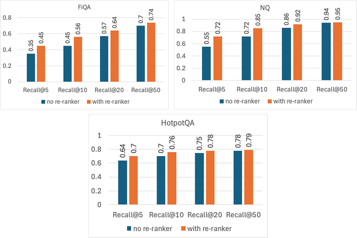

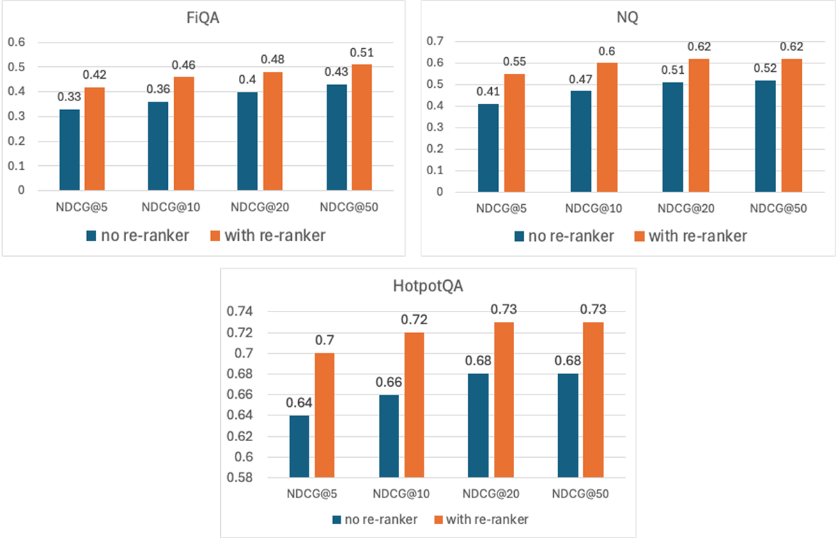

Since a top-K of 100 is significantly high, we evaluated the accuracy at lower values of K ranging between 5, 10, 20 and 50 which reflects a realistic setting deployed in real user searches.
a. Recall@k=5,10,20, 50 - Impact of re-ranker

b. nDCG@k=5,10,20, 50 - Impact of re-ranker

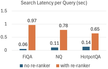

c. Average Latency - Impact of re-ranker
latency
As shown in the above charts, using the re-ranker boosts recall and nDCG by up to 25% but leads to a latency overhead of 16x, 7x and 4.6x compared to not using re-ranker. We also have an additional resource overhead in using a re-ranker w.r.t. needing a GPU to control the re-ranking latency. A user unwilling to bear the overhead of additional search latency and GPU resource requirements may choose not to enable a re-ranker.
Therefore, depending on how latency sensitive the search is, a re-ranker can be optionally enabled.
