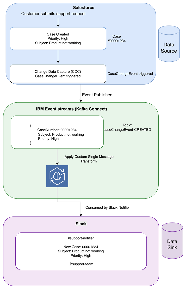

Use Case Introduction
The purpose of this use case is to demonstrate how Salesforce CDC events can be ingested into an IBM Event Streams pipeline using Kafka Connect.
The use case is intentionally simple:
  • Salesforce acts as the event producer.
  • IBM Event Streams acts as the event backbone.
  • Slack acts as a lightweight downstream consumer.
    This example is not intended to position Slack notifications as the primary value. Instead, it is used to illustrate how events flow once they enter IBM Event Streams through the Salesforce Source Connector provided by the Connectivity Pack.

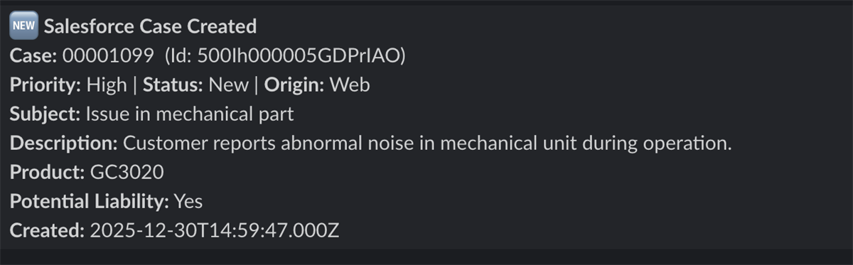

High-Level Flow
  • A support Case is created in Salesforce.
  • The connectivity pack Salesforce connector emits a CDC event (CaseChangeEvent).
  • The Salesforce Source Connector publishes the event to a Kafka topic.
  • The event becomes available to any downstream consumer.
  • An HTTP Sink Connector forwards the event to Slack.

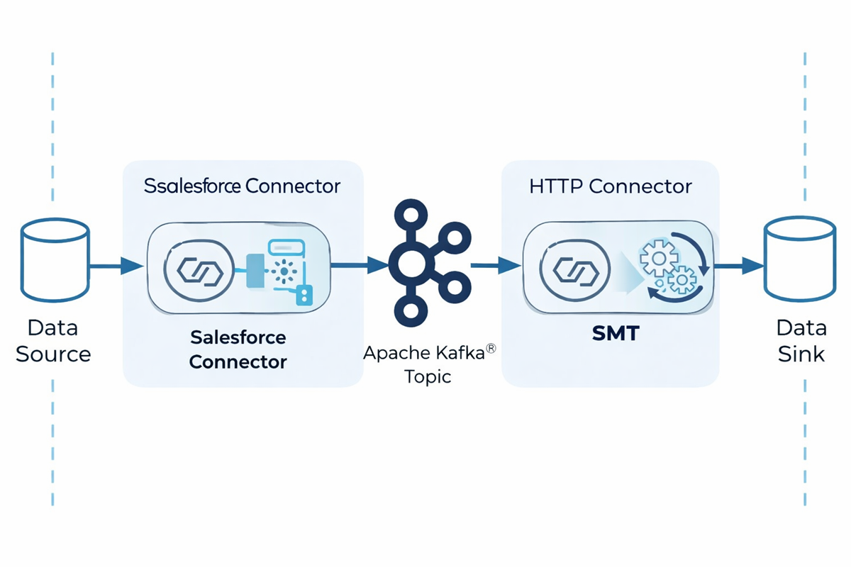

Kafka Connector configuration in IBM Event Streams
⬅️ Salesforce Source Connector Configuration
Create a Kafka Connector in IBM Event Streams using the following configuration.
apiVersion: eventstreams.ibm.com/v1beta2

➡️ HTTP Sink Connector configuration
The HTTP Sink Connector consumes records from a Kafka topic and sends them to an external HTTP endpoint.
In this pipeline:
    • Source topic: caseChangeEvent-CREATED.
    • Target endpoint: Slack Incoming Webhook.
    • HTTP method: POST.
The connector demonstrates how IBM Event Streams can push events to external systems without writing custom consumer code.

🗨 Single Message Transforms (SMTs)
Salesforce CDC events contain a rich payload, including metadata and fields that may not be required by downstream consumers.
In this pipeline, the HTTP Sink Connector posts events to a Slack Incoming Webhook. Slack notifications work best when the message is compact, readable, and formatted (for example, highlighting Case number, priority, subject, and tagging the support team).
To construct a clean Slack message payload (for example {"text": "...formatted message..."}) directly inside the Kafka Connect pipeline, we use a custom Single Message Transform (SMT).

What the SMT Does
The custom SMT performs the following steps:
    1. Accepts Salesforce CDC events coming from the Kafka topic.
    2. Checks the entityName and processes only Case CREATE events.
    3. Extracts a small set of useful fields (CaseNumber, Subject, Priority, Status, etc.)
    4. Constructs the Slack message text in a readable format.
    5. Outputs a Slack webhook-compatible JSON body (for example: {"text":"..."}), so the HTTP Sink Connector can post it directly to Slack.

Step 2: Salesforce Publishes a CDC Event
After the Case is created:
    • Salesforce generates a Change Data Capture (CDC) event.
    • The event type is CaseChangeEvent.
    • The event represents a CREATE operation on the Case object.
Step 3: Event Is Published to Kafka topic (Kafka connect)
    • The Salesforce connector as part of connectivity pack receives the CaseChangeEvent from Salesforce.
    • The Kafka connect Salesforce Source Connector publishes the converted event to an IBM Event Streams Kafka topic.
    • In this example, the event is written to the topic: caseChangeEvent-CREATED.

Step 4: Event Is Delivered to Slack
    • The HTTP Sink Connector consumes records from the caseChangeEvent-CREATED topic.
    • A custom SMT formats the event into a Slack-friendly message.
    • The connector sends the message to the Slack support-ticket channel using an Incoming Webhook.
Message in Slack channel Support Notifier.
