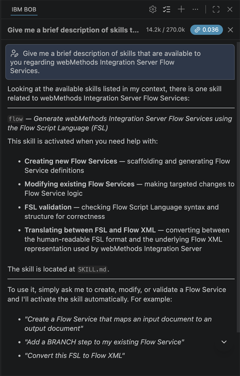

Step 3. Verify the Skills are Loaded
Open your AI assistant and send the following message:
Give me a brief description of skills that are available to you regarding webMethods Integration Server Flow Services.
Your assistant should respond with a summary of the available skills: Flow Service generation, unit testing, diagramming, and documentation. Note that you may have to open a workspace to get the agent to acknowledge the skills.
Verification that Skill Files Loaded
If your assistant responds generically with no mention of FSL, Flow Services, or skill files, the skills have not loaded correctly. Check that:
  1. The copy command completed without errors - confirm the destination directory exists and contains files
  2. Your AI assistant has been restarted since the skills were installed
  3. The path used in the copy command points to the correct source. Confirm the (Mac) skills/flow/ or (Windows) skills\flow\ directory exists in your extracted ZIP folder

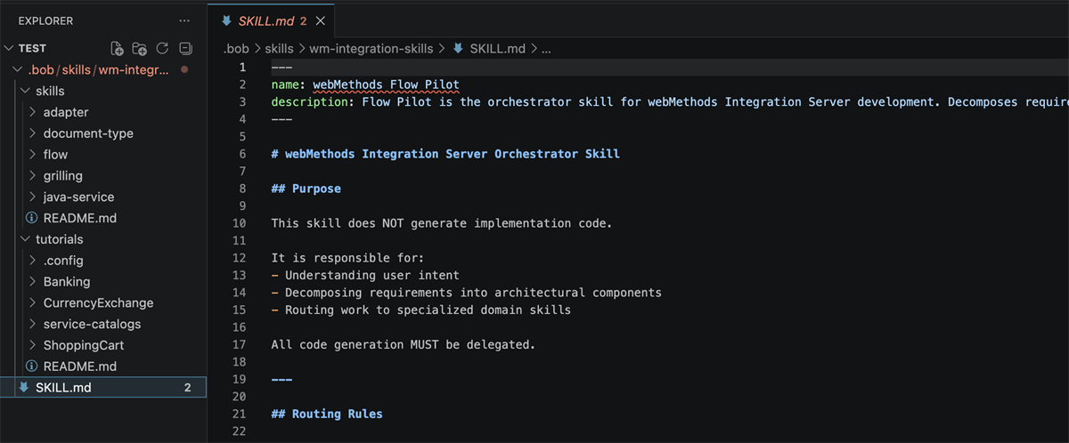

An Aside About the VS Code Extension
When using the Flow Pilot VS Code Extension, you can add the skills to a hidden ./bob directory in your local workspace via the "webMethods Flow Script: Install Skills into Workspace Folder" command. The local .bob/ directory includes additional supporting documentation (tutorials, orchestration skills, etc.). It is still a workspace-local setup rather than a global installation. In the case that the skills are not added with this command (i.e. the Flow Pilot extension does not recognize your agent), the global install of the skills will give your agent the context it should need to create flows.
