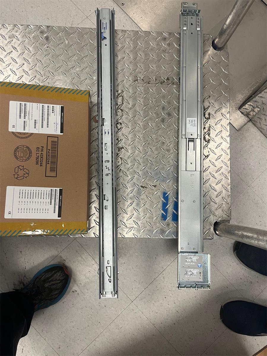

While performing an install 2 of the 3 E1150s came with mismatched rails. It appears (to me based on E1050 experiences) the wider one is from an E1050 and the thinner one is new to the E1150. One E1150 did come with both thinner rails.  Now, they did work and seem to be compatible but just odd and suspect its simply a parts shortage.
Unsure if it's related to the combo of the rails, but when sliding it into the rack the bottom back right corner about 1/32" was rubbing the vertical rail in the rack. We had to pop a handle back on near it it give it a nudge. Speaking of the handles, though a set ships with every system, and they are disposable as they are only attached to load the system, its a good idea to keep one complete set handy. So years down the road when they are removed from the rack it can be done so in a similar fashion. Just reuse the one set as needed.
