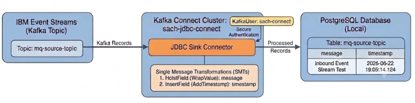

Architectural overview
The message is assumed to be published to Kafka as a byte array with a null key and the original message as the value, and is sent to the configured. Once the message reaches Kafka, Single Message Transforms (SMTs) are applied to structure and enrich the payload. The raw message is first wrapped into a JSON object, after which additional fields, such as a timestamp, are appended. The transformed message is then consumed by the sink connector and written to the PostgreSQL database, where the JSON fields are mapped to the corresponding table columns.

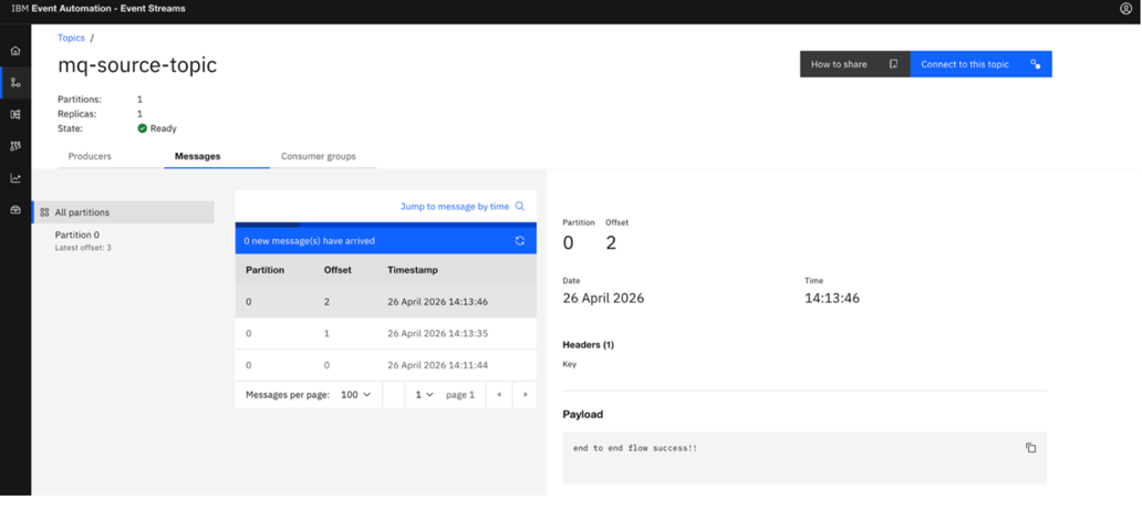

STEP 2: Verify the message arrived in Event Streams
2a. Open the Event Streams UI (the link appears on the right-hand side of the ES instance page in OCP).
2b. Log in with the Kafka user you configured. To get the password, navigate to the Kafka user's resources section and scroll down to copy it.
2c. Select Topics from the left menu, open mq-source-topic, go to the Messages tab, and refresh. Your test message should appear as shown below.

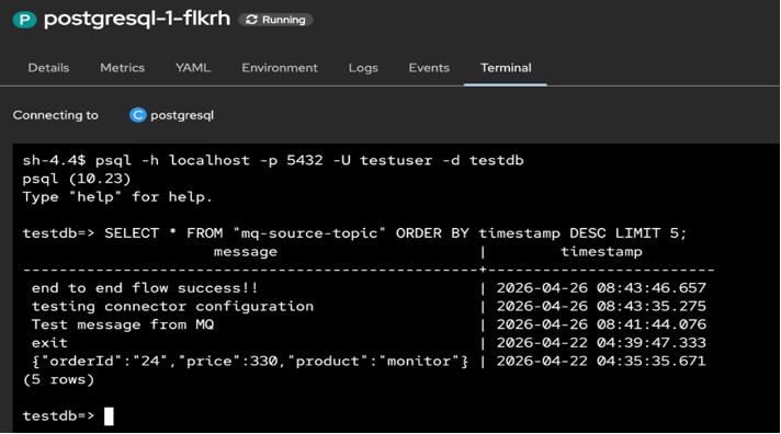

3b. Using OCP UI:
1. Go to Workloads → Pods, find the PostgreSQL pod, and open Terminal.
2. Connect to the database: psql -h localhost -p 5432 -U <db-username> -d <db-name>
3. Run your query: SELECT * FROM "mq-source-topic" ORDER BY event_timestamp DESC LIMIT 5;
