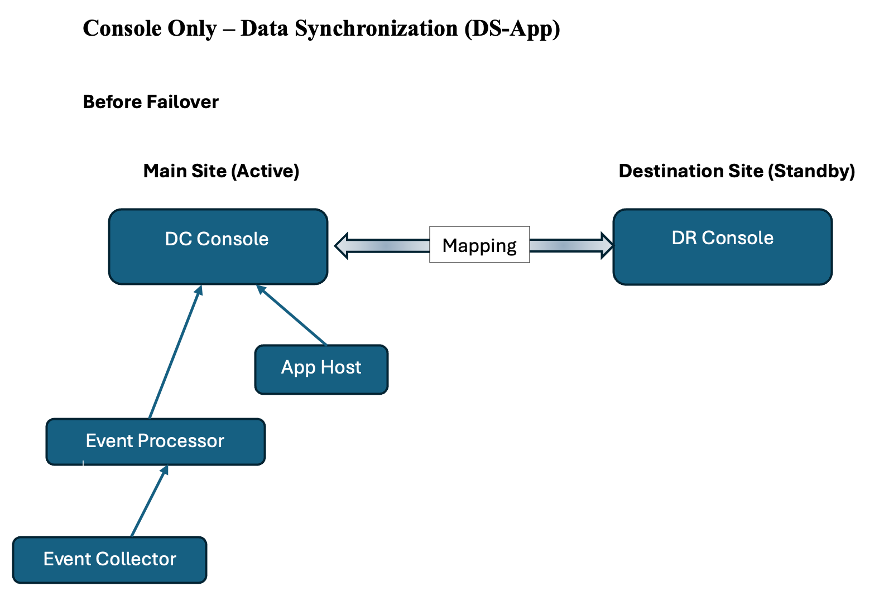

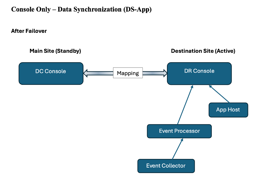

Understanding the Architecture
Before jumping into action, it’s important to understand how the setup works.
  • Main Site (DC) → Active production system
  • Destination Site (DR) → Standby system, waiting for activation
  • Data Sync App → Handles backup transfer + restore
At any time:
  • One site is ACTIVE
  • Other is STANDBY
Workflow (Failover and Failback)
Console Only Before Failover
Console Only After Failover

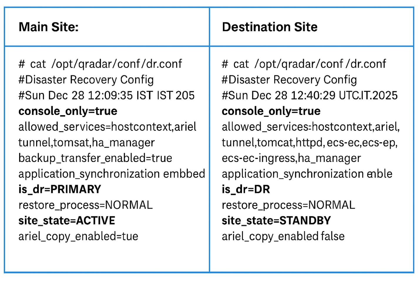

At a deeper level, the configuration file (/opt/qradar/conf/dr.conf) defines the role of each system. The Main site should be marked as PRIMARY and ACTIVE, while the Destination site should be DR and STANDBY. This distinction is important because it determines how data synchronization and restoration behave during failover.
A sample dr.conf file is as below:
dr.conf
Verify the dr.conf file in your environment against the sample file provided above. If it does not match, it indicates that the configuration is not in the expected state. In such cases, the recommended approach is to perform a factory reset of the Data Sync App on both sites to restore a clean and consistent baseline.

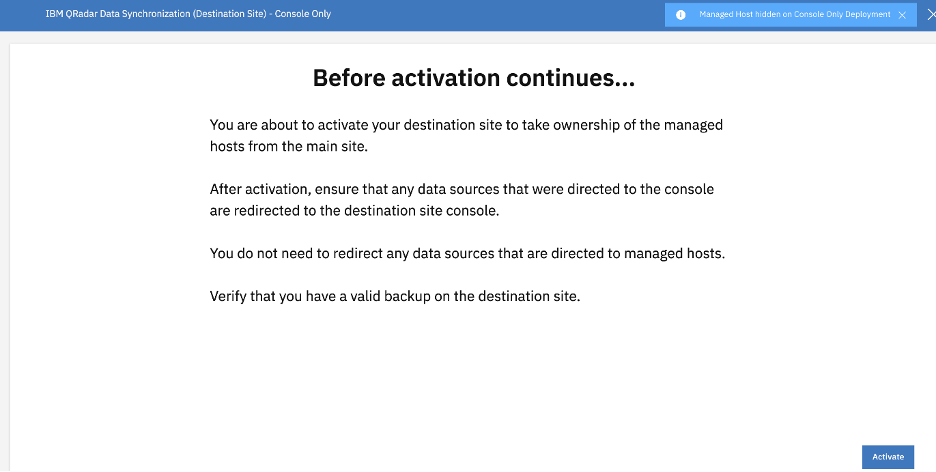

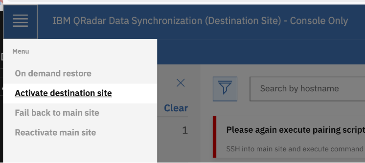

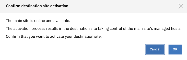

Once everything is validated, the failover is initiated from the Destination site by selecting “Activate Destination Site” in the Data Synchronization App.
On the destination QRadar Console, click Admin > Data Synchronization app.
Open the app menu and select
Activate destination site.
Activate Destination site
Click Activate and then confirm the activation.
Activate
Click Ok
Ok

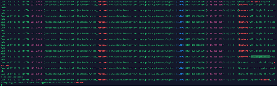

At this point, QRadar begins a controlled restoration process. The restoration process uses the latest synchronized backups between both sites to ensure consistency before activating the Destination site. The restoration starts on the main site first. Once that is complete, the destination site restoration begins using the latest backup from the main site. This two-step restoration ensures that both systems are aligned and consistent.
You can monitor this process in real time through the logs (/var/log/qradar.log), where restoration activity will be clearly visible.
qradar.log

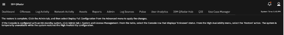

After the restoration is complete, a full deployment must be performed to apply all configuration changes across the system.
restoreComplete

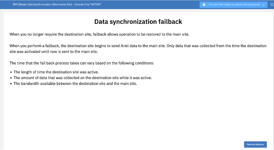

Failback is initiated from the Destination site by selecting “Failback to Main Site” in the Data Synchronization App. The system then performs a series of internal validations, such as verifying backup integrity, updating configurations, and preparing data synchronization.
Once initiated, QRadar transfers (synchronizes) the latest data from the Ariel database back to the Main site. The restoration process again follows a sequence: first restoring on the Main site, followed by restoration on the Destination site.
After restoration is complete, all data sources must be redirected back to the Main site, ensuring that log flow resumes correctly.
To finalize synchronization, the seal file must be cleared on the Main site. This allows proper resynchronization of data between the systems.
The final step is to reactivate the Main site from the Data Synchronization App. Once this is done and changes are deployed, the environment returns to its original state, completing the failback process.
Step By Step Guide: Failback Process:

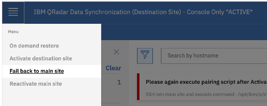

In the QRadar Console on the destination site, go to Admin > Data Synchronization App.
Open the app menu and select Failback to Main Site.
fail back to main site

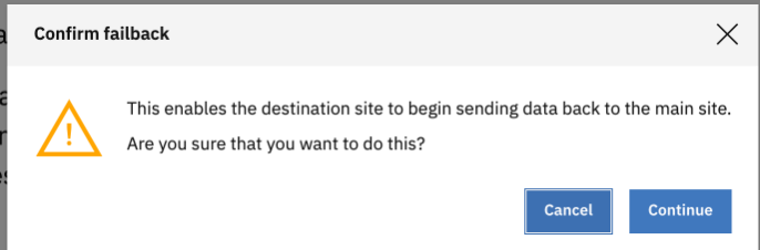

Click Perform Failback, and then confirm.
Activate
Click Continue.
continue

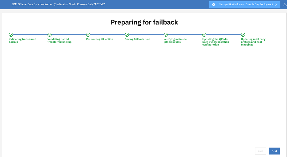

After clicking Continue, the QRadar Data Synchronization process performs several validation steps to ensure the failback can proceed successfully. These include:
  • Validating the transferred backup
  • Re-validating the paired transferred backup
  • Performing High Availability (HA) actions
  • Saving the failback timestamp
  • Verifying iptables rules on the main site
  • Updating the QRadar Data Synchronization configuration
  • Updating Ariel copy profiles and host mappings
Once all validations are completed successfully, click Next to proceed.
checks

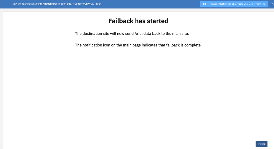

Once the process is complete, click Finish.
Failback

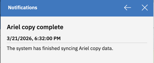

After clicking Finish, the Destination site begins sending data back to the Main site. You will receive a notification once the Ariel copy is completed.
Ariel Copy complete
Next, point all data sources that were directed to the destination site back to the main site.

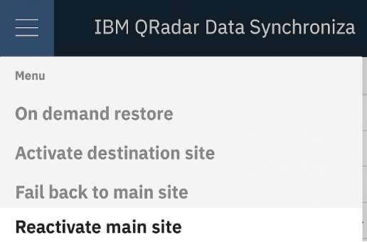

After clearing the seal files, the Main site must be reactivated from the QRadar GUI.
Navigate to:
Admin → Data Synchronization App
From the application menu, select Reactivate Main Site, then click Reactivate and proceed by clicking Next.

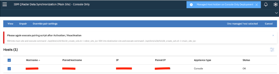

Once the reactivation process is initiated, go to the Admin tab on both the Main site and Destination site Consoles and click Deploy Changes. After the deployment completes successfully, the Main site becomes active again, indicating that the failback process is complete.
3.5 Re-establish Pairing Between Sites
After reactivation, the pairing connection between the Main and Destination sites is removed automatically. To restore synchronization capability for future operations, you must manually re-establish the pairing.
Run the following command on the Main site Console:
/opt/ibm/si/dr/bin/dr_create_ssh.sh -i <destination_site_ip>
Then run the following command on the Destination site Console:
/opt/ibm/si/dr/bin/dr_create_ssh.sh -i <main_site_ip>
This step ensures secure communication is re-established between both sites.

Restore only the necessary applications, preferably starting with smaller ones. For larger environments, consider migrating applications to an App Host before restoration to maintain system performance.
During restoration, always follow the standard UUID-based restore method. Do not restore the Data Synchronization application, as it is required to maintain system state and support future failover/failback operations.
If any application enters an error state after restoration, restart it using:
/opt/qradar/support/qappmanager
