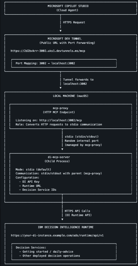

Architecture Overview
Architecture of exposing an IBM Decision Intelligence decision service as an MCP server, published through a Microsoft Dev Tunnel and consumed by a Copilot Studio agent,
Flow Explanation
  1. Copilot Studio Agent sends an HTTPS request to the Dev Tunnel public URL
  2. Dev Tunnel forwards the request from the public URL to localhost:3002
  3. mcp-proxy (listening on port 3002) receives the HTTP request at /mcp endpoint
  4. mcp-proxy converts the HTTP request to stdio communication with its child process
  5. di-mcp-server (running in stdio mode) receives the request via stdin
  6. di-mcp-server makes HTTPS API calls to IBM DI Runtime
  7. IBM DI Runtime executes the decision and returns results
  8. Response flows back through the same chain in reverse
Key Port Details
  • Port 3002: Fixed HTTP port where mcp-proxy listens (stable endpoint)
  • Random Internal Port: mcp-proxy manages stdio communication with di-mcp-server internally (no fixed port needed)
  • Dev Tunnel Port: Maps public URL to localhost:3002
What You Will Build
You will create this flow:
  → Dev Tunnel public URL
  → mcp-proxy on localhost:3002
  → di-mcp-server running in stdio mode
  → IBM Decision Intelligence runtime

Why mcp-proxy is Needed
di-mcp-server works well with stdio, but Copilot Studio expects a remote MCP endpoint over HTTP. mcp-proxy solves that by:
  • Starting the DI MCP server as a child process
  • Talking to it over stdio (no fixed port needed for di-mcp-server)
  • Exposing a fixed HTTP MCP endpoint such as http://localhost:3002/mcp
That fixed port can then be published through Dev Tunnel.

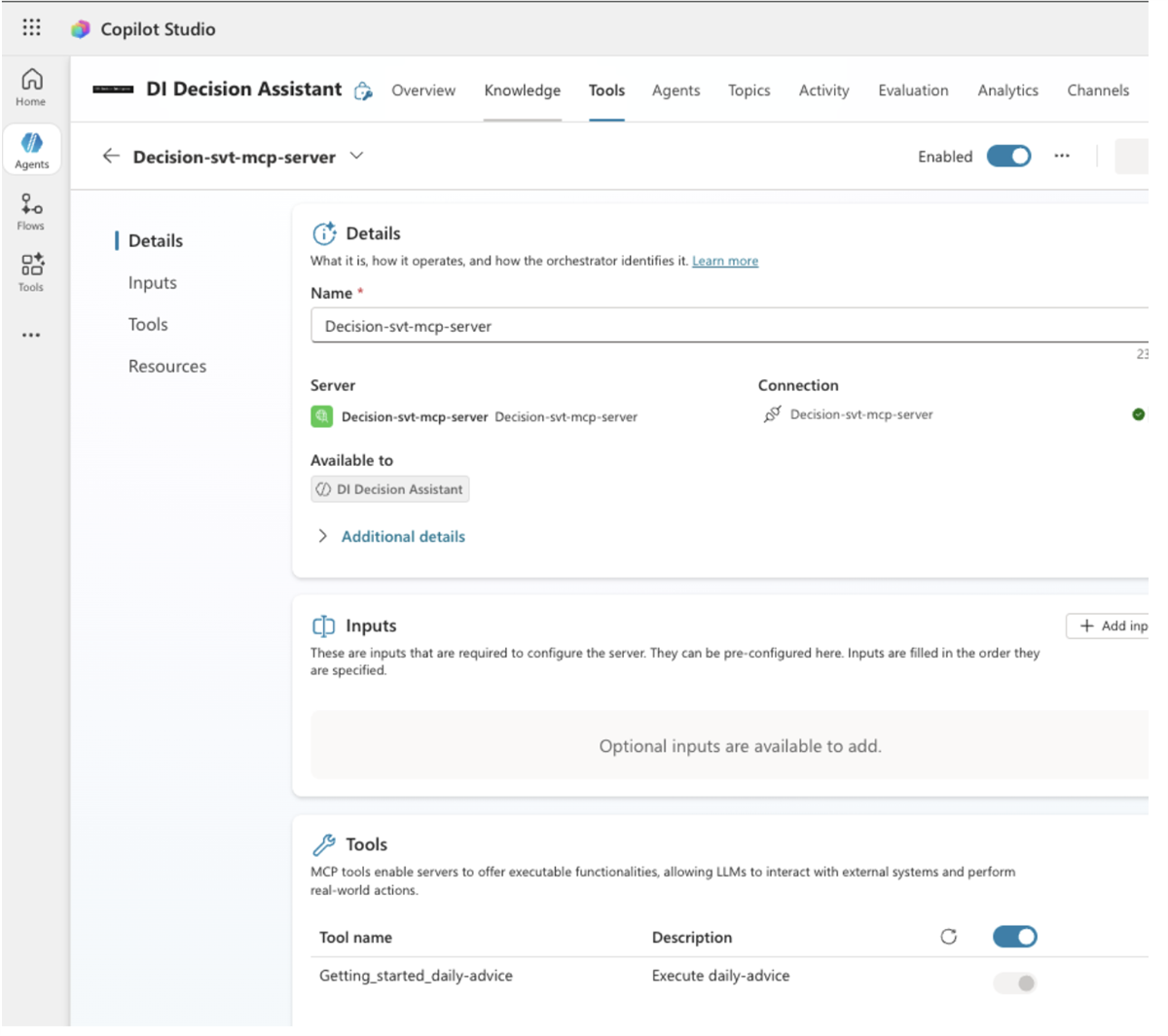

Step 6: Confirm the Tool Appears
Once Copilot Studio connects successfully, it should import the decision operation as a tool.
In the tested setup, the tool appeared as:
Getting_started_daily-advice
This name is derived from:
  • Decision service name: Getting started
  • Operation ID: daily-advice
MCP server successfully configured and connected in Copilot Studio, with the decision tool (Getting_started_daily-advice) discovered and available for use by the agent.

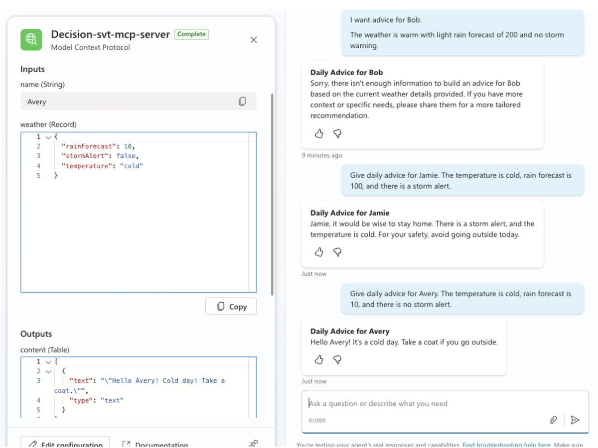

Step 7: Test the Tool from Agent Chat
Now you can test the integration with various scenarios. The decision service expects the following input schema:
  • name: string
  • weather.rainForecast: integer
  • weather.stormAlert: boolean
  • weather.temperature: one of cold, hot, warm
Test Cases
Below are three comprehensive test cases that validate different aspects of the decision logic.
Test 1 — Storm Scenario
Prompt to ask Copilot:
Give daily advice for Jamie. The temperature is cold, rain forecast is 100, and there is a storm alert.
Expected tool input:
  "name": "Jamie",
  "weather": {
    "temperature": "cold",
    "rainForecast": 100,
    "stormAlert": true
Expected result:
Hello Jamie! It would be wise to stay home. There is a storm alert.
What this validates:
  • ✅ Boolean handling for stormAlert = true
  • ✅ Correct decision branch for storm conditions
  • ✅ Successful MCP tool invocation
Test 2 — Cold Day Scenario
Give daily advice for Avery. The temperature is cold, rain forecast is 10, and there is no storm alert.
  "name": "Avery",
  "weather": {
    "rainForecast": 10,
    "stormAlert": false
Expected result:
Hello Avery! Cold day! Take a coat.
Testing of the MCP tool within Copilot Studio, where different user prompts trigger the decision service and return contextual daily advice based on weather conditions such as temperature, rain forecast, and storm alerts.
  • ✅ Enum handling for temperature = cold
  • ✅ Low rain without storm
  • ✅ Correct rule path for cold weather advice
Test 3 — Rainy Day Scenario
Give daily advice for Robin. The temperature is cold, rain forecast is 90, and there is no storm alert.
  "name": "Robin",
  "weather": {
    "rainForecast": 90,
    "stormAlert": false
Expected result:
Hello Robin! Rainy day! Take an umbrella.
  • ✅ Numeric threshold handling for rain
  • ✅ No storm path
  • ✅ Correct rainy-day business rule
