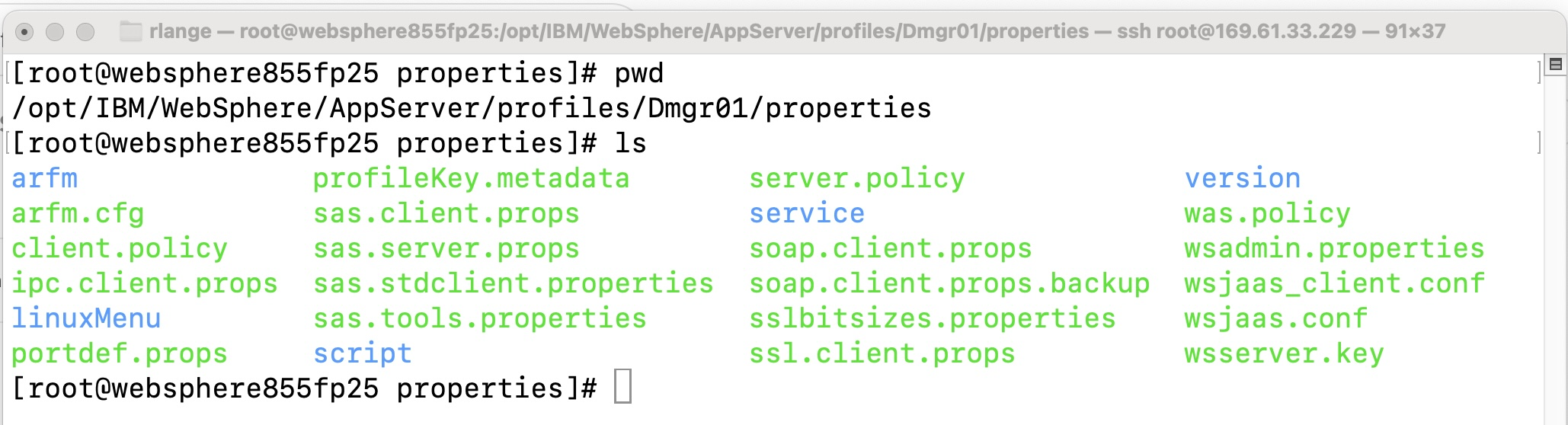

1.        Login to your WebSphere deployment manager host using ssh or other terminal connection methods.
2.        Change directory to <WASND_INSTALL_ROOT>/AppServer/profiles/Dmgr01/properties
# cd /opt/IBM/WebSphere/AppServer/profiles/Dmgr01/properties
3.        Make a backup of the soap.client.props file as shown above
# cp soap.client.props soap.client.props.backup

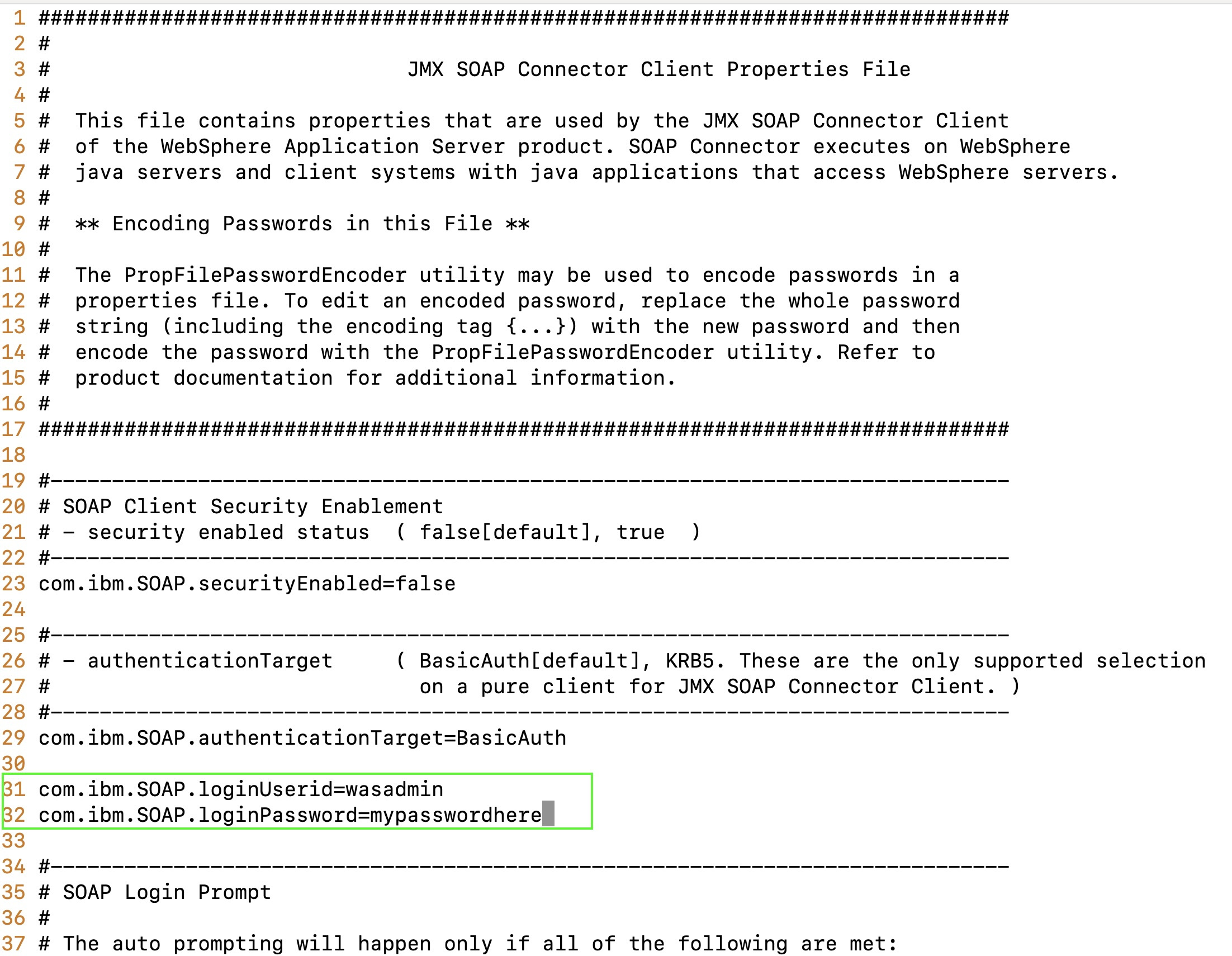

4.        Edit the soap.client.props and update the loginUserid and loginPassword properties as shown below on lines 31 and 32:
5.        Save your changes
6.        You have completed the necessary update to the WebSphere Deployment Manager.   We now will move to the DevOps Deploy web console to make the next set of updates.

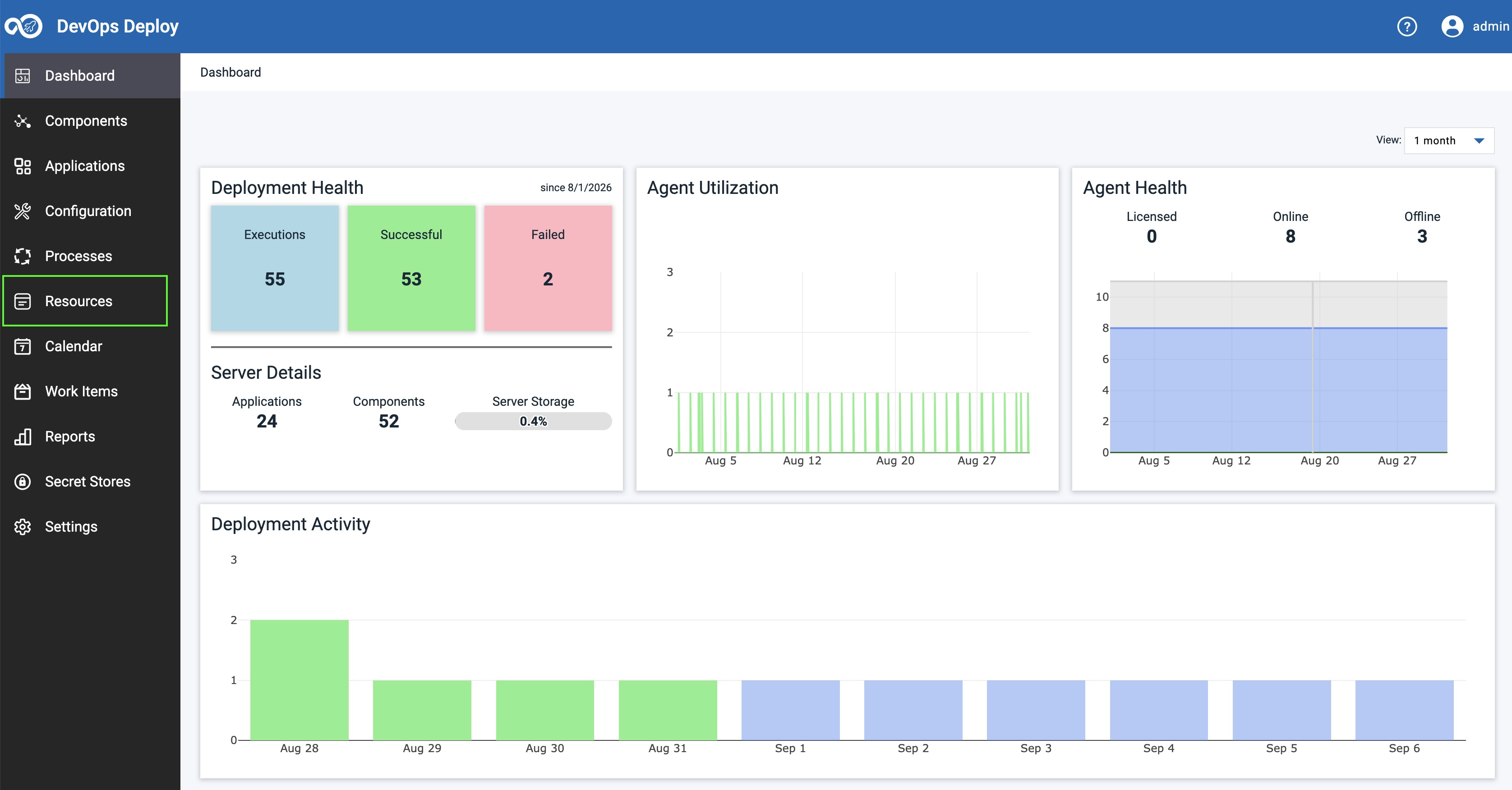

1.        Login to your IBM DevOps Deploy web console
2.        Click on the Resources tab found in the left-hand navigation as shown below:

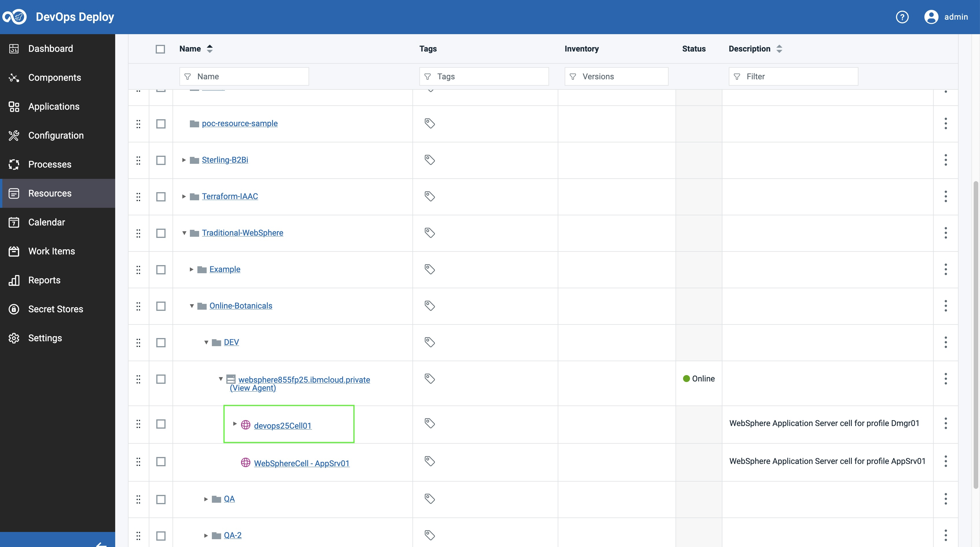

3.        Navigate in your resource tree to find your WebSphere cell as shown below:

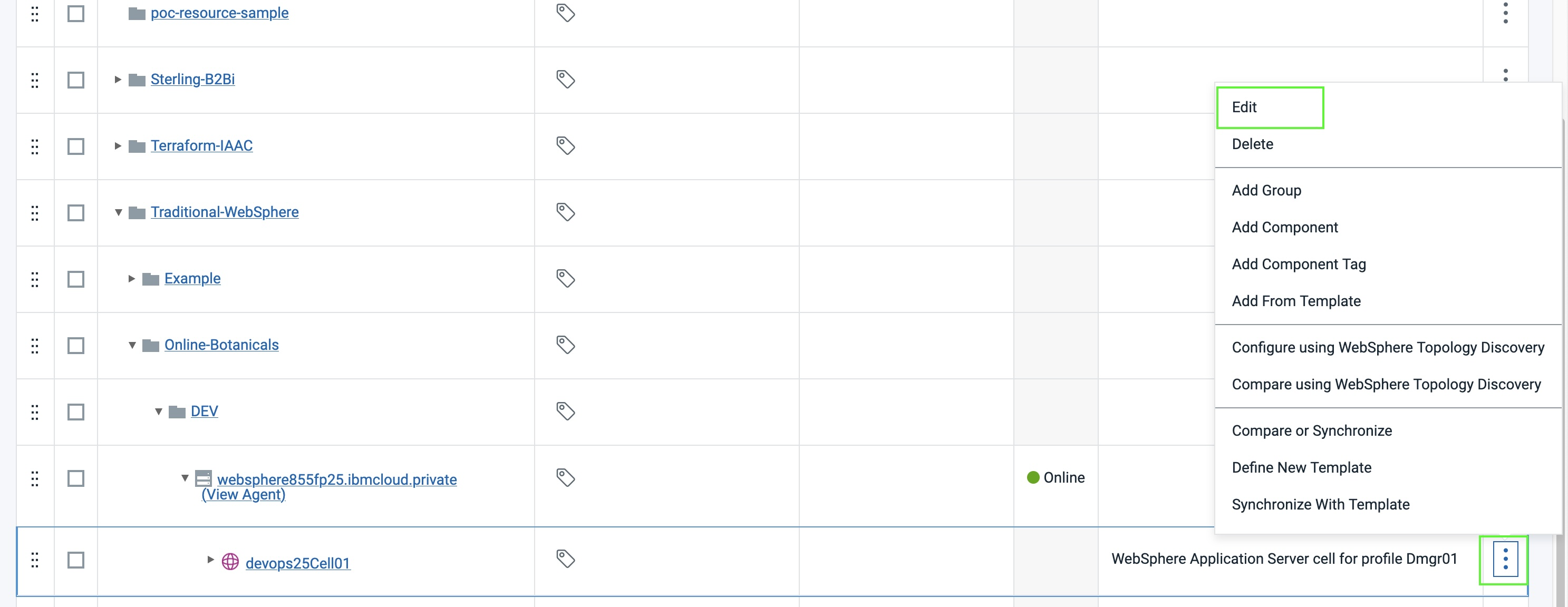

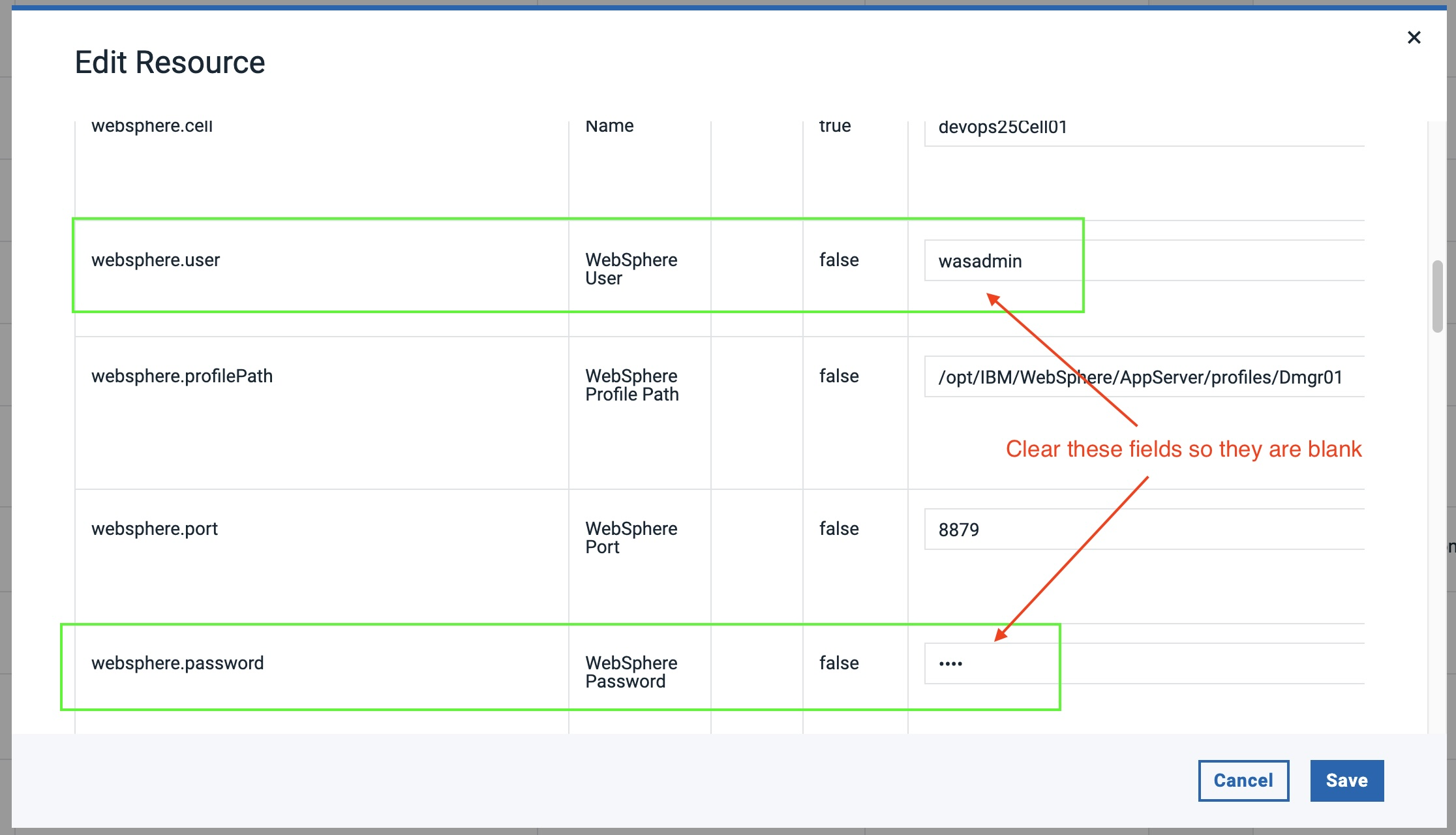

4.        Click the ‘three dots’ pulldown menu at the far right and select ‘Edit’ from the pulldown list as shown below.

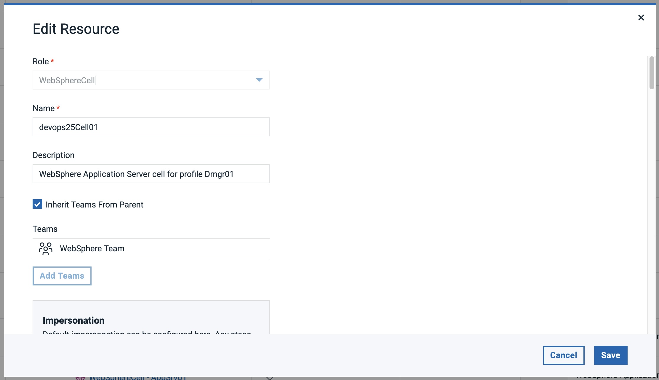

5.        An Edit Resource dialog window will appears as shown below:
6.        Using the scrollbar, scroll down to the ‘websphere.user’ value as shown below and update the field so it has an empty string value (i.e. clear the value):
7.        Scroll down and clear the ‘websphere.password’ value so it is an empty value as well shown in the image above.
8.        Click Save.
With these changes completed, when a DevOps Deploy process executes to deploy a WebSphere application to an environment, our ‘WebSphere – Deployment’ plugin will recognize that the websphere.user and websphere.password fields are left blank in the Resource Tree.   It will then revert to the WebSphere soap.client.props file to get the websphere.username and websphere.password details to authenticate with the cell.

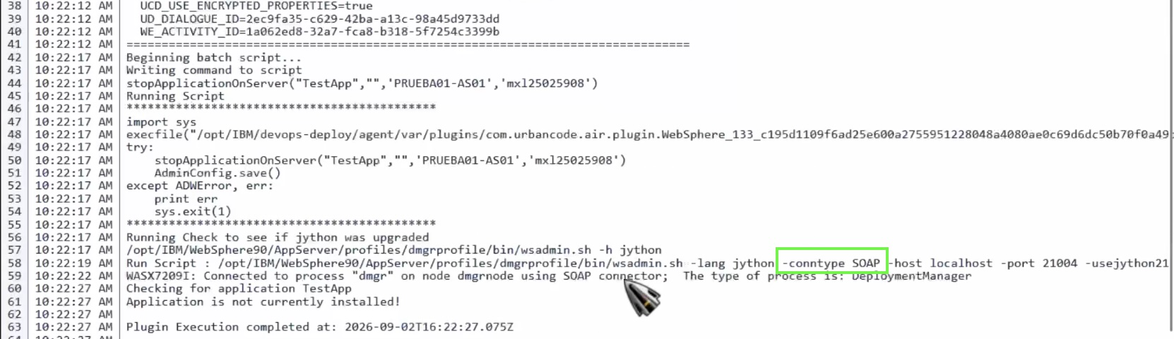

When you execute a deployment to your WebSphere environment following the changes made above, you should be able to see it is using SOAP for the connection type as shown below:
Notice the ‘-conntype SOAP’ in the wsadmin.sh script execution above rather than trying to use username/password parameters.   This is why making sure in IBM DevOps Deploy that the websphere.user and websphere.password properties in the Resource Tree are empty strings as we configured earlier in the blog.
