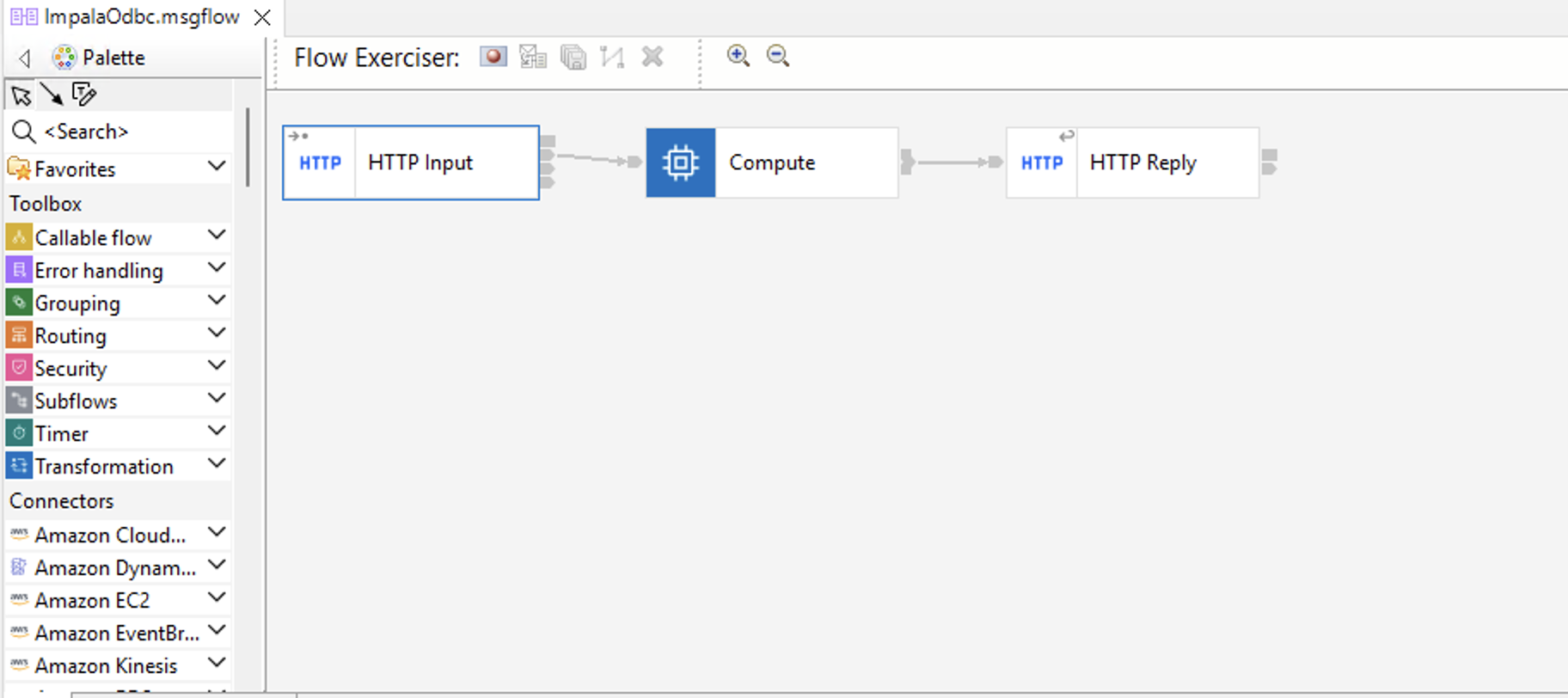

Step 7: Build the Employees Message Flow
The flow retrieves employee data via HTTP.
Nodes used:
  • HTTP Input Node → Receives requests
  • Compute Node → Executes SQL query
  • HTTP Reply Node → Returns response

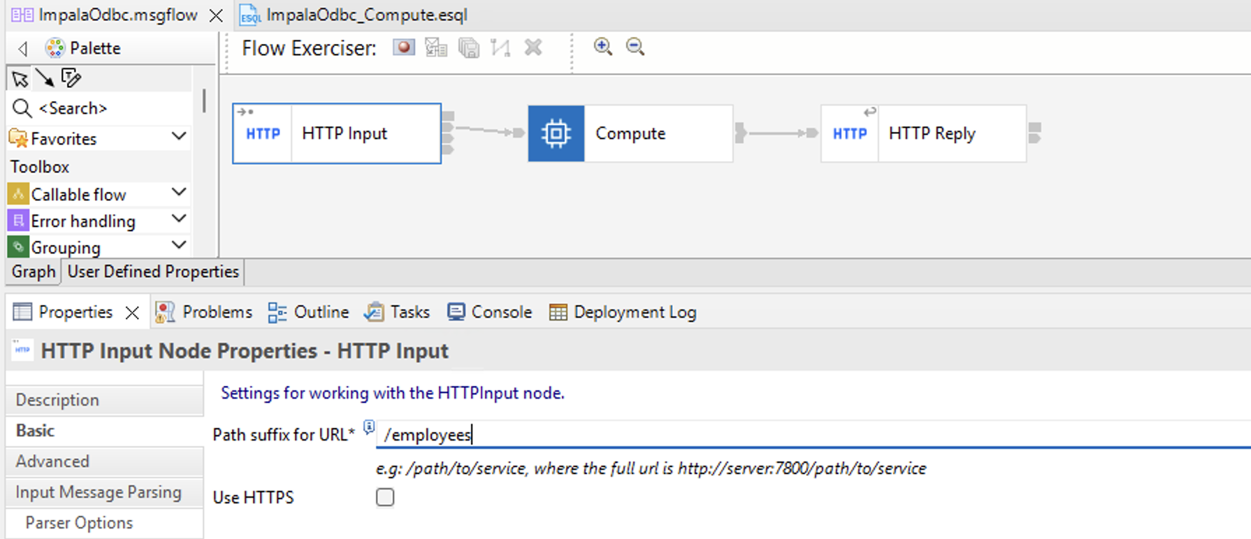

HTTP Input Node → Set Path suffix for URL to /employees

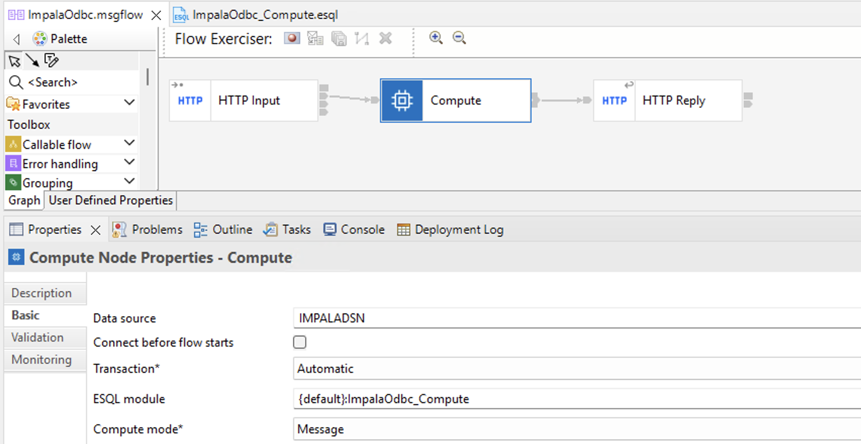

Compute Node → Set Data source to IMPALADSN (ensure consistency with DSN name)

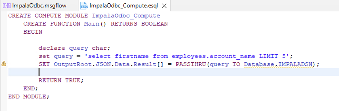

Compute Node ESQL Example:
Save, deploy, and execute the flow.
