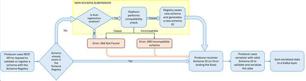

How does client-side validation work?
Simply taken, these are the steps required for client-side validation and publication of events.

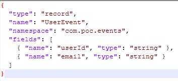

I’m using a simple Avro schema to validate the events I’ll be sending:

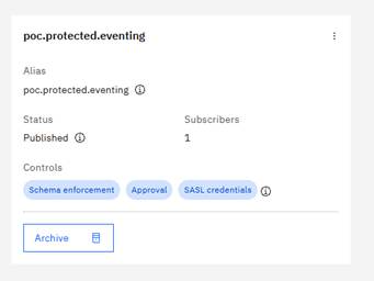

·         poc.protected.eventing (protected by IBM Event Endpoint Management)

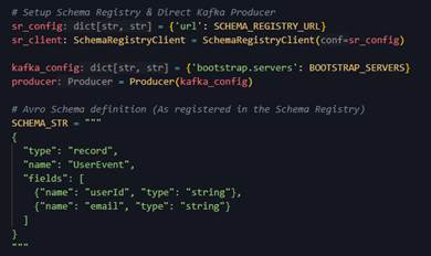

I’m using python scripts to create different producers supporting my cases. I’ll share parts of the code to show what I’m doing. Important: The code shown is quickly made without any intention of promoting it to any other environment than this demo. So, it is not production ready by any means.
For the third use case, I’ve installed an IBM Event Endpoint Management (EEM) with an Event Gateway on OCP. In EEM I’ve configured my local confluent as a cluster so I can expose my confluent topics in my portal and add security and validation options. Options configured:

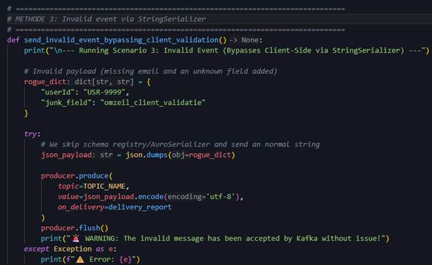

Even though we have registered a schema, using the StringSerializer, we can still send events to the topic. Using the AvroSerializer, this would have been blocked on client-side.
Risk: Consumers believe it to be safe, but we are still depending on the producer to send valid events.

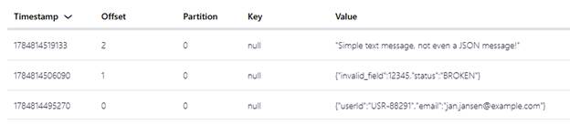

CASE 1: Create a topic on Confluent and produce directly to it (No validation)
As you will see in the next screenshot. I’m able to send any event I like, even if it is not compliant the schema.  Although it seems (as shown in the image) that the schema is linked to the topic. Kafka does not enforce any validation.
Schema:
Command line sending events
Results shown in confluent
Conclusion
This shows how much the consumer relies on the producer to provide high-quality data.

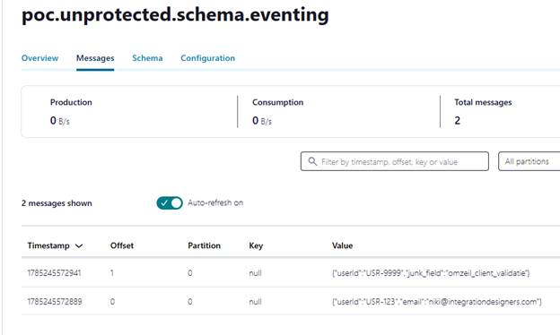

CASE 2: Create a producer with a StringSerializer
I’ll be sending data using the AvroSerializer and the StringSerializer to show how different the client reacts.

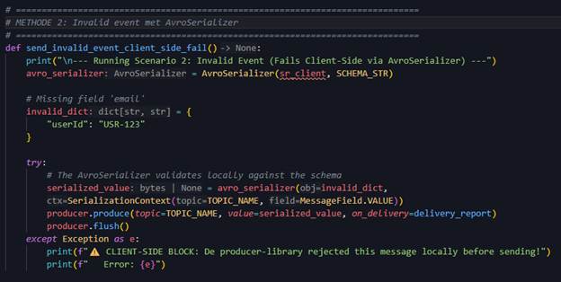

2.1 Client side AvroSerializer
Show that when using the Schema Registry and the AvroSerializer, on client side we will be blocked from sending invalid events
2.3: Client side StringSerializer

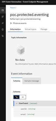

CASE 3: Create a topic in EEM and add schema enforcement
In this case, we won’t be going directly to the Kafka topic in Confluent, but we will be addressing the topic through an event gateway. This gateway will implement schema validation for us.
Topic and schema validation configured in EEM:

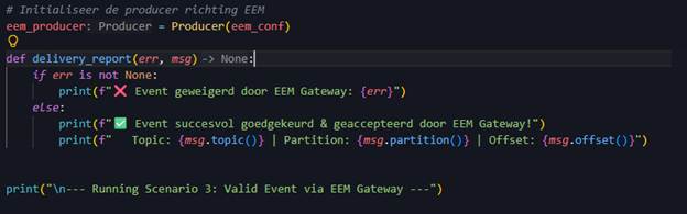

First we will be sending a valid event, next an invalid event
Valid
Invalid
