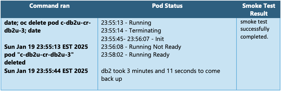

3.1 Test Scenario 1: Single Pod Deletion
     In this test, we randomly deleted a single Db2 pod to simulate a crash or accidental termination.
  Objective:
     To observe how quickly the system recovers and the Db2 instance becomes operational again.
   Result:
  •        The pod was automatically rescheduled by OpenShift.
  •        Db2 container reinitialized and passed readiness checks.
  •  Average recovery time: 3 minutes and 10 seconds
    The data below illustrates the outcome of a single-node soft failure test iteration
