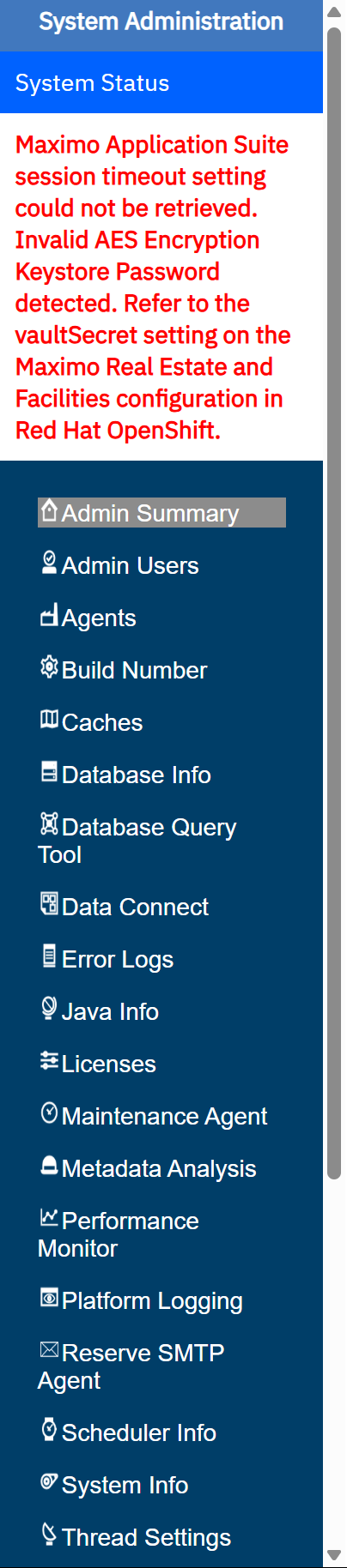

The menu. The red text at the top is System Status : warnings the platform wants you to see first.
The menu. The red text at the top is System Status: warnings the platform wants you to see first.

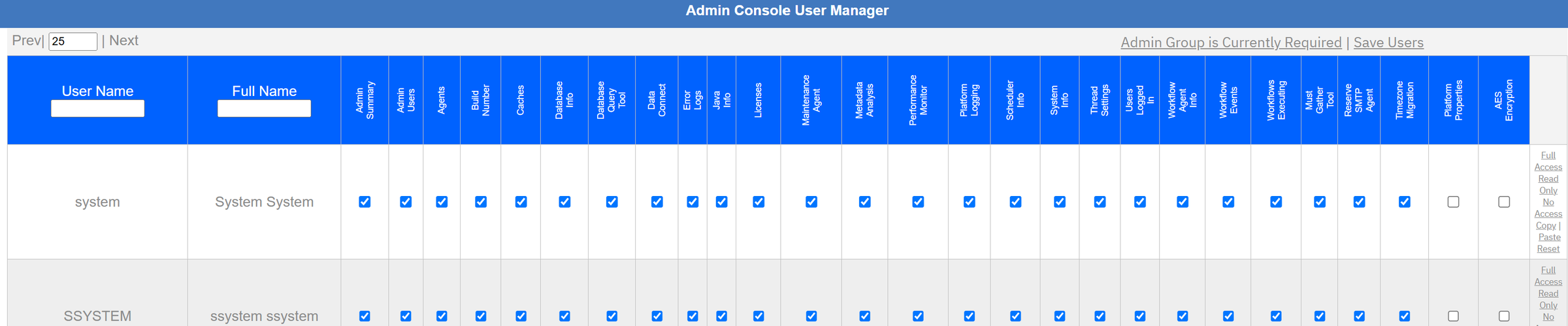

Access is per page, per user: see Admin Users below. A user with "Read Only" on a page can look but not press its buttons.

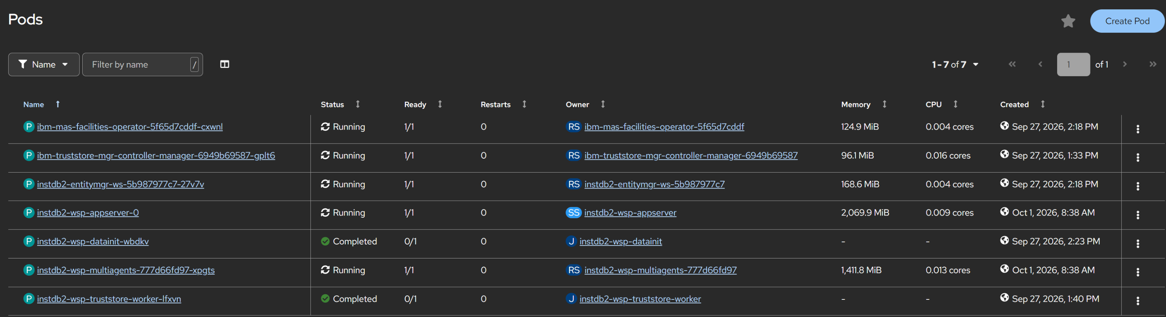

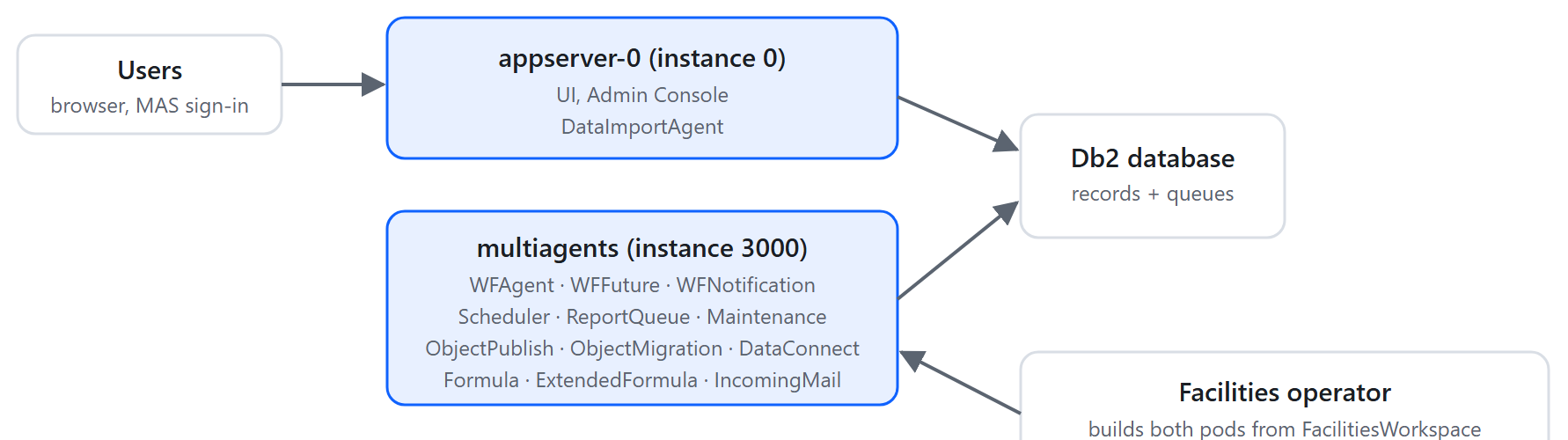

On Maximo Application Suite, MREF is not one server. The Facilities operator builds it from a custom resource (the FacilitiesWorkspace) into several pods in its own namespace. On this system, mas-instdb2-facilities:
MREF on OpenShift: users reach the appserver pod; the multiagents pod runs the agents; both share the Db2 database; the operator builds both from the FacilitiesWorkspace
OpenShift console → Workloads → Pods in the MREF namespace.
Pod What it is Agents on it
instdb2-wsp-appserver-0 The UI server (Liberty). Users and the Admin Console talk to this one. Instance ID 0. DataImportAgent only
instdb2-wsp-multiagents-… A second Liberty server with no users, dedicated to background work. Instance ID 3000. All the others
ibm-mas-facilities-operator-… The operator: turns the FacilitiesWorkspace settings into pods, secrets and routes, and keeps them that way. none
instdb2-entitymgr-ws-… MAS workspace entity manager: connects MREF to MAS users and licences. none
…-datainit, …-truststore-worker One-off jobs: database setup at install, certificate truststore. "Completed" is normal. none
So when the Admin Console says an agent is "Running On instdb2-wsp-multiagents-3000", it means the multiagents pod. Its log (/home/wiotp/log/server.log inside that pod, or the pod's Logs tab in OpenShift) is where that agent's errors go, not the Error Logs page of the UI server.

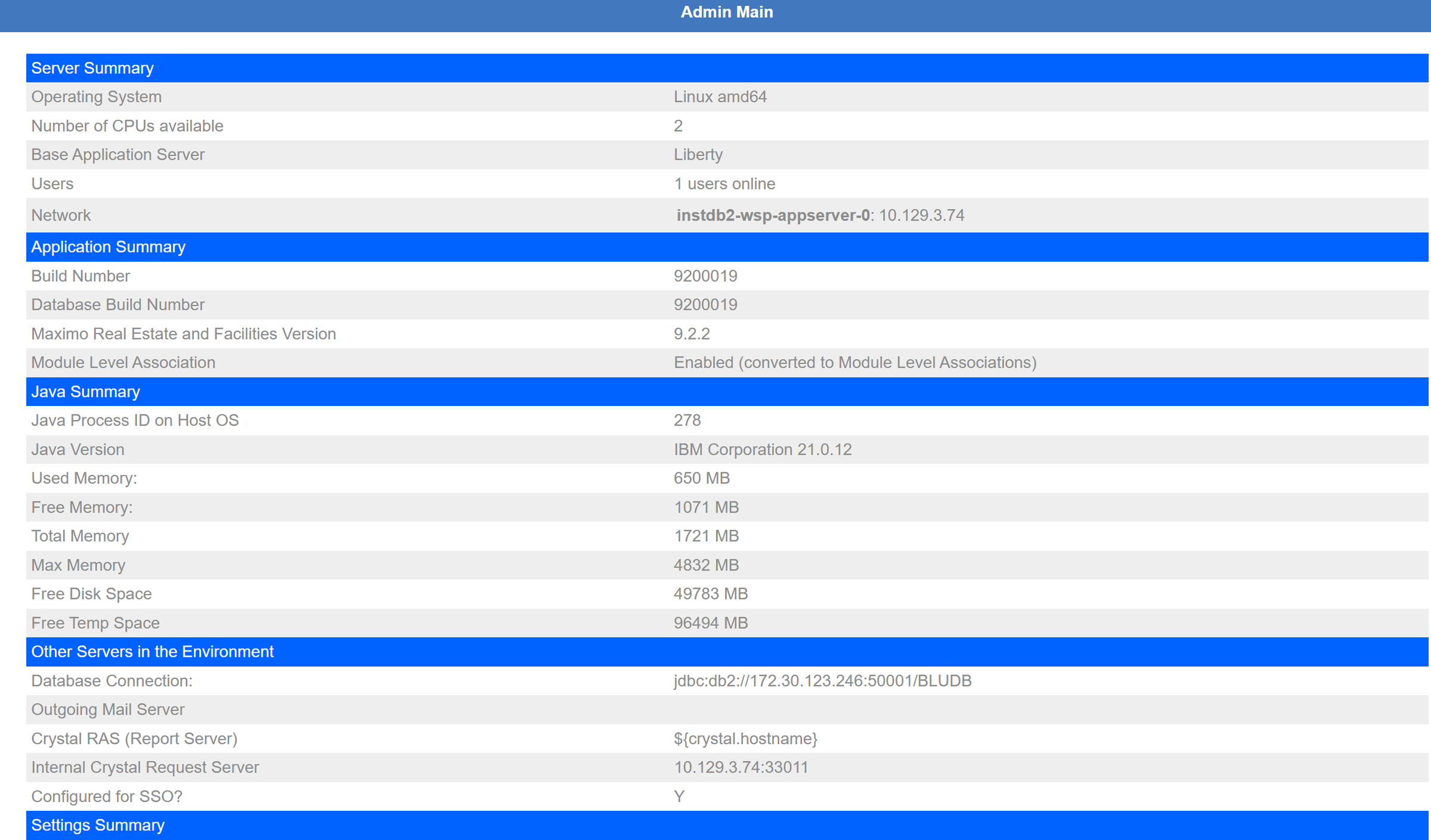

Admin Summary and the red warnings
Admin Summary of the UI server.
Line Value here What it means
Operating System, CPUs Linux amd64, 2 What the container sees: the pod's CPU limit, not the size of the OpenShift node.
Base Application Server Liberty WebSphere Liberty, as for Manage.
Users 1 users online Sessions on this server. Details: Users Logged In.
Network instdb2-wsp-appserver-0: 10.129.3.74 The pod name and its internal IP. It changes when the pod is recreated.

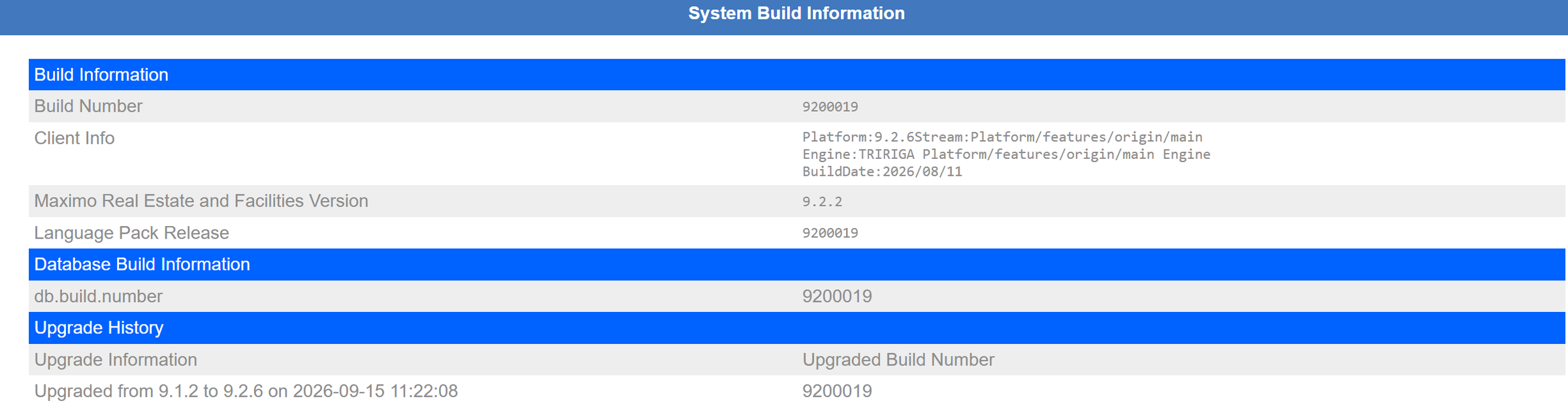

Build Number, Database Build Number 9200019, 9200019 Code and database must match. A mismatch after an upgrade means the database upgrade did not finish.
MREF Version 9.2.2 Application version (the platform underneath is 9.2.6, see Build Number).
Module Level Association Enabled (converted…) Associations are stored per module. Matters when you create new modules (see our first guide).
Java Process ID, Java Version 278, IBM 21.0.12 The JVM inside the pod.
Used / Free / Total / Max Memory ~0.9 GB / ~0.8 / 1.7 / 4.8 GB Java heap. Total grows towards Max as needed. Watch Used against Max, not against Total.
Free Disk / Temp Space ~49 GB / ~96 GB Disk seen by the pod (log and user-file volumes).
Database Connection jdbc:db2://…:50001/BLUDB The JDBC URL from the MAS JDBC configuration. Port 50001 is Db2 over TLS.
Outgoing Mail Server empty No SMTP configured, so workflow notification e-mails cannot be sent.
Crystal RAS, Internal Crystal Request Server ${crystal.hostname}, 10.129.3.74:33011 Legacy Crystal Reports server. The placeholder means it is not configured; BIRT is the report engine in use.
Configured for SSO Y Sign-in goes through MAS (OIDC), not a TRIRIGA password.
Base Currency, Portal refresh US Dollars, 60 System-wide settings.
The red System Status text
The two messages above the menu on this system:
  • "Maximo Application Suite session timeout setting could not be retrieved." MREF asks MAS for the session timeout so both log users out at the same time. The server log shows the call is refused (HTTP 401). Users can still work; MREF falls back to its own timeout (System Info → User Session Timeout, 30 minutes here). Worth fixing so sessions behave consistently.
  • "Invalid AES Encryption Keystore Password detected. Refer to the vaultSecret setting…" MREF encrypts some stored values with an AES key kept in a keystore. Its password comes from the vault secret named in the FacilitiesWorkspace (vaultSecret). The warning means that password does not open the keystore. Fix it in OpenShift, by correcting the secret, never by editing anything in the console. Until then, features that rely on encrypted values may fail.
In Maximo terms
Like the Manage "System Health" warnings, or a mxe.security.crypto.key mismatch after moving a database: the system runs, but anything that needs to decrypt stored secrets will not.

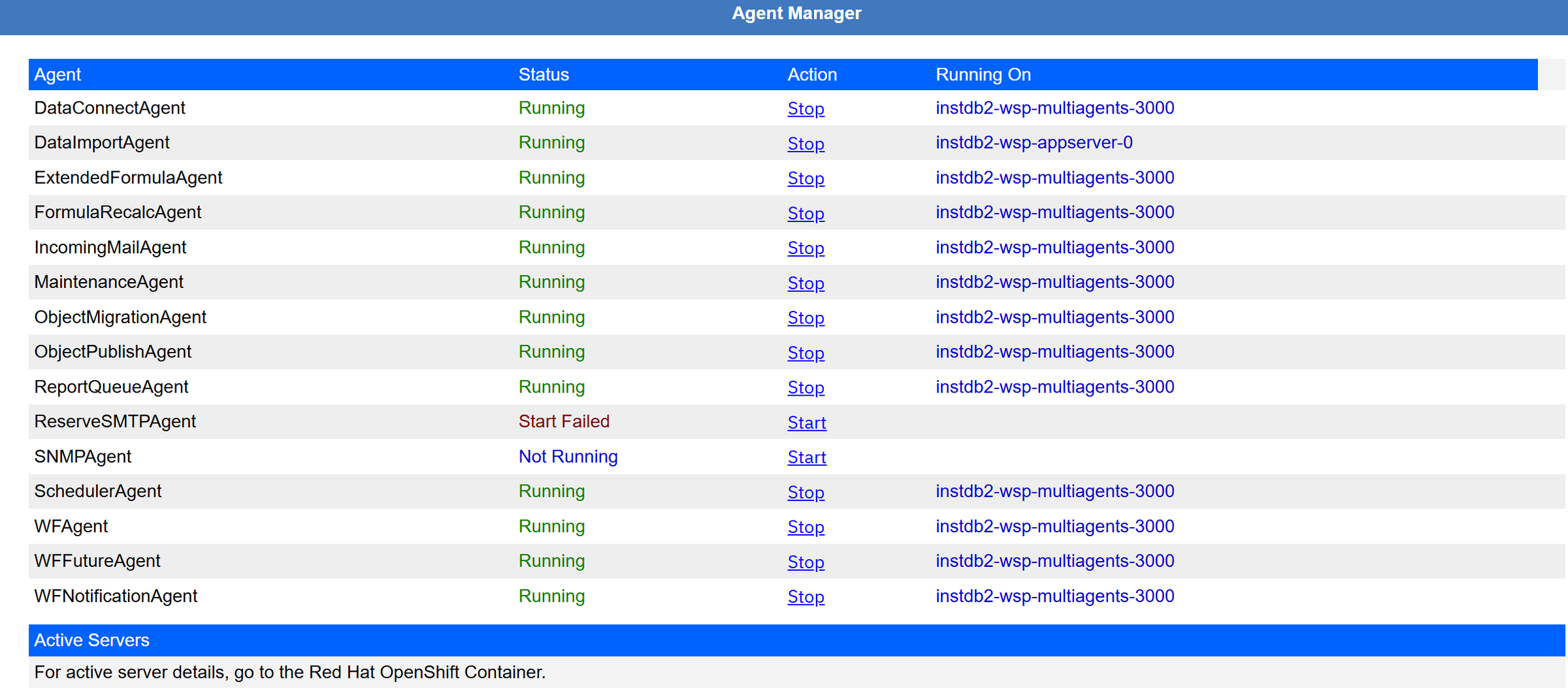

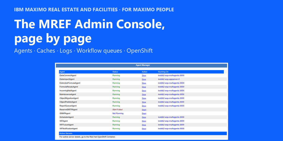

Agents, the background workers
An agent is a background process inside a Liberty server that wakes up regularly, looks for queued work in the database, and does it. Almost everything that is not a user clicking a button is done by an agent: asynchronous workflows, scheduled events, imports, publishing, cleanup.
Agents page: status, the Stop/Start link, and the server each agent runs on.
Agent What it does Maximo equivalent Here
WFAgent Runs asynchronous workflows: picks events from the workflow queue (WF_EVENT) and executes them. The most important agent. Workflow and automation scripts run by a cron task Running, multiagents
WFFutureAgent Holds workflow actions dated in the future (WF_EVENT_FUTURE) and posts them to the queue when their time comes. Escalation with a time condition Running
WFNotificationAgent Sends workflow notifications (e-mail and in-app). Communication templates / e-mail send Running (no SMTP configured)
SchedulerAgent Fires scheduled events and recurring tasks: preventive maintenance schedules, job scheduler, recurring jobs. PM generation cron task, Cron Task Setup Running
ReportQueueAgent Runs reports that were queued or scheduled instead of run on screen. Report scheduling / report queue Running
DataImportAgent Processes Data Integrator uploads (tab-delimited files loaded through the UI). Data import (MIF flat file), MXLoader Running, appserver
DataConnectAgent Moves rows from staging tables into business objects (DataConnect integration). MIF interface tables Running
ObjectPublishAgent Publishes business objects after a Data Modeler change: alters tables, regenerates metadata. Apply Configuration Changes (ConfigDB) Running
ObjectMigrationAgent Imports and exports Object Migration packages. Migration Manager deploy Running
FormulaRecalcAgent Recalculates formula fields for many records, for example after a formula changes. No direct one (bulk formula refresh) Running
ExtendedFormulaAgent Recalculates "extended formulas" that depend on other records, from a queue. No direct one Running
MaintenanceAgent The cleanup agent: removes old workflow instances and stale records, runs database maintenance on a schedule. Housekeeping cron tasks Running
IncomingMailAgent Reads an inbound mailbox and turns mails into records or workflow events. Email Listener Running
ReserveSMTPAgent Receives meeting-room booking mail for the Reserve (room booking) feature. None Start Failed
SNMPAgent Answers SNMP monitoring queries. None Not Running
Reading the statuses
  • Running with a server name: normal.
  • Not Running: not started. Fine for agents you do not use (SNMP here).
  • Start Failed: something tried to start it and it could not. Here the Reserve SMTP agent is switched on for the multiagents pod but Reserve mail is not configured (its domain is still the sample reserve.tririga.qa.tririga.com). Harmless if you do not use Reserve; otherwise fix the configuration.
Where an agent runs, and why
On OpenShift the multiagents pod is started with agent switches such as WF_AGENT=enabled, SCHEDULER_AGENT=enabled, MAINTENANCE_AGENT=enabled and RESERVE_SMTP_AGENT=enabled; the operator sets them from the FacilitiesWorkspace (agentsSpecs, empty here, means "use the defaults"). Each Liberty server has an instance ID (0 for the appserver, 3000 for multiagents), which is the number you see after the pod name.
Stop / Start are live switches
The Stop link really stops that agent across the system. Stop the WFAgent and every asynchronous workflow queues up and nothing happens until someone starts it again; stop the ObjectPublishAgent and every Publish waits. On a shared system, do not use these links to "see what happens". If an agent is stuck, restarting its pod from OpenShift is usually cleaner.
In Maximo terms
Agents are cron task instances, and Stop/Start is the Active flag. The difference: an MREF agent is a long-running worker that polls its queue, not a task that fires on a fixed schedule.

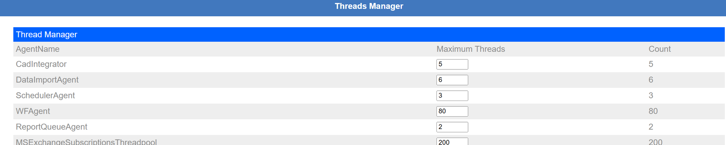

Thread Settings
Maximum worker threads per agent: WFAgent 80, DataImportAgent 6, SchedulerAgent 3, ReportQueueAgent 2.
How many things each agent may do at once. More WFAgent threads means more workflows in parallel, but also more database connections and memory. These values come from FACILITIES.properties (WFAgentMaxThreads=80 and so on); on MAS, change them there, not here.

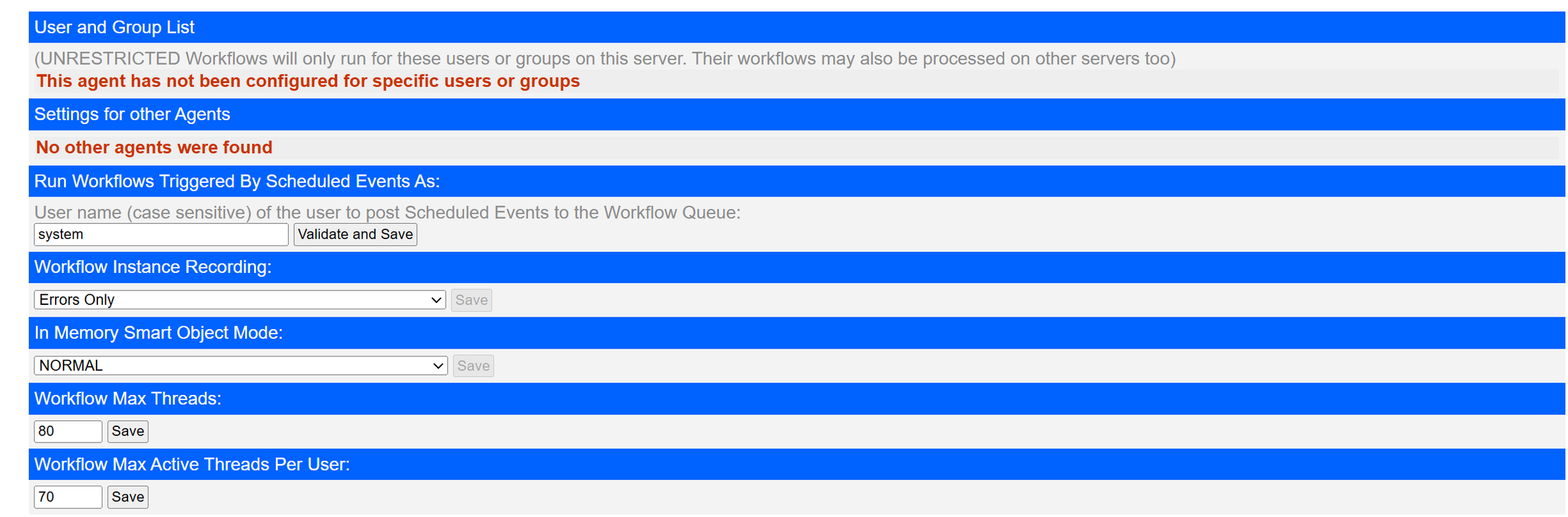

Workflow Agent Info
Workflow agent settings.
  • User and Group List: you can dedicate a workflow agent to certain users (for example, a heavy integration user). Not used here.
  • Run Workflows Triggered By Scheduled Events As: the user that scheduled workflows run as (system).
  • Workflow Instance Recording: Errors Only: instances are kept only for failed workflows. Switch to "All" briefly when you debug a new workflow, then back: recording everything fills the database.
  • Workflow Max Threads 80, Max Active Threads Per User 70: the per-user limit stops one user (or one integration) from taking every thread.

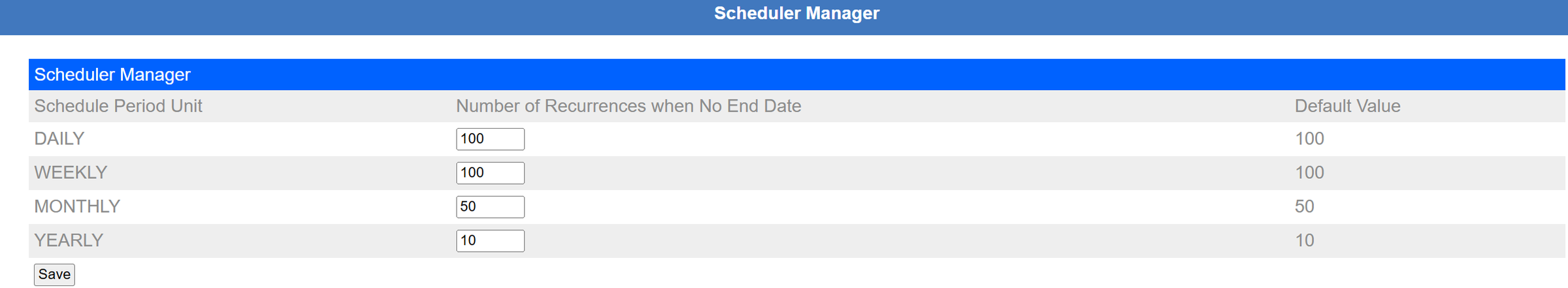

Scheduler Info
How many occurrences a schedule with no end date generates ahead.
A recurring schedule with no end date would create endless events, so the scheduler only creates the next 100 daily or weekly, 50 monthly or 10 yearly occurrences, and tops them up later.

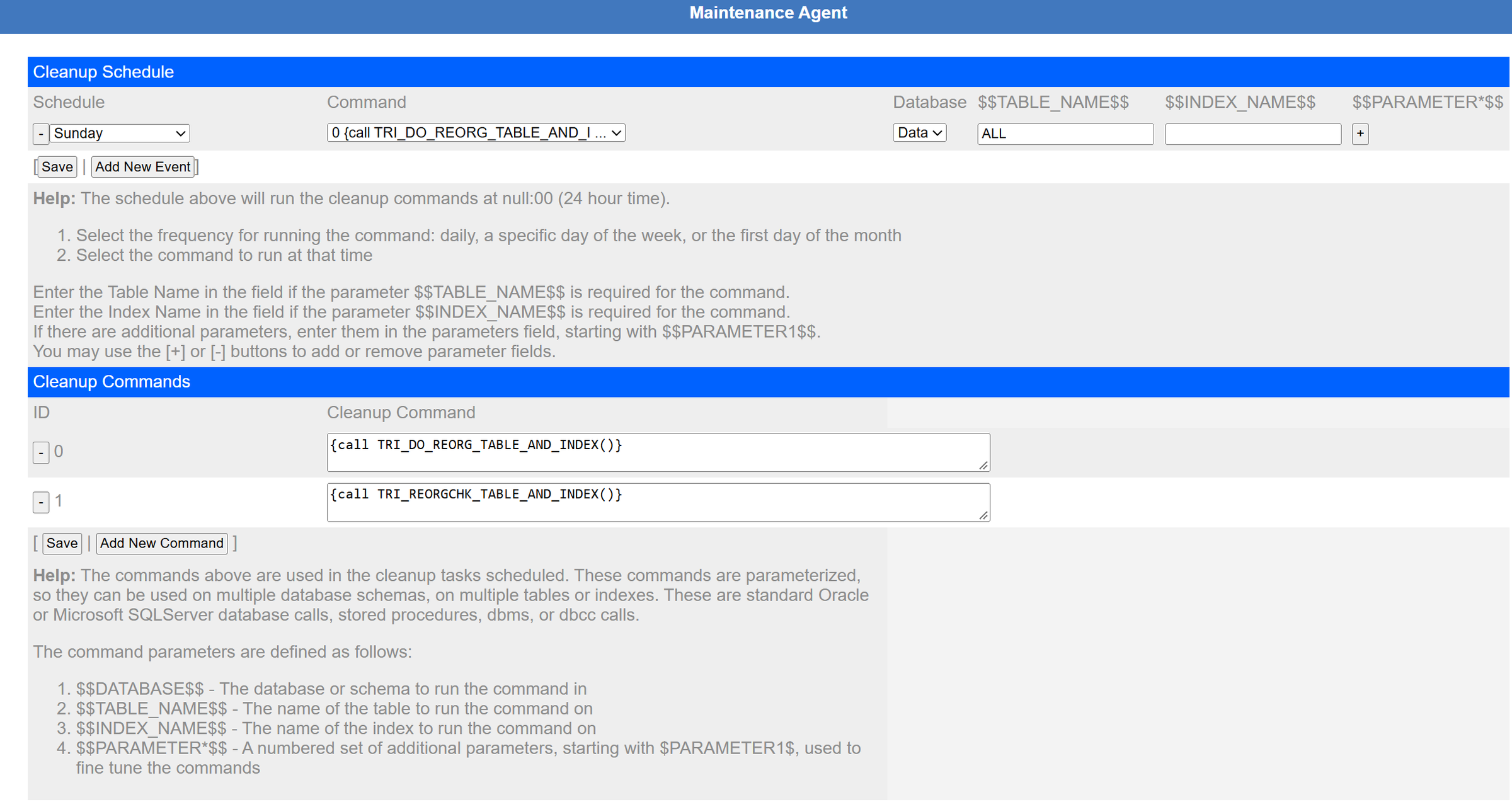

Maintenance Agent
Database maintenance commands and when to run them.
A small scheduler for database housekeeping: here Db2 table and index reorganisation (TRI_DO_REORG_TABLE_AND_INDEX) every Sunday. The cleanup itself (old workflow instances, stale records) runs daily at CLEAN_HOUR from FACILITIES.properties (0 here, midnight UTC). Agree this with your DBA: on MAS the database is often managed separately.

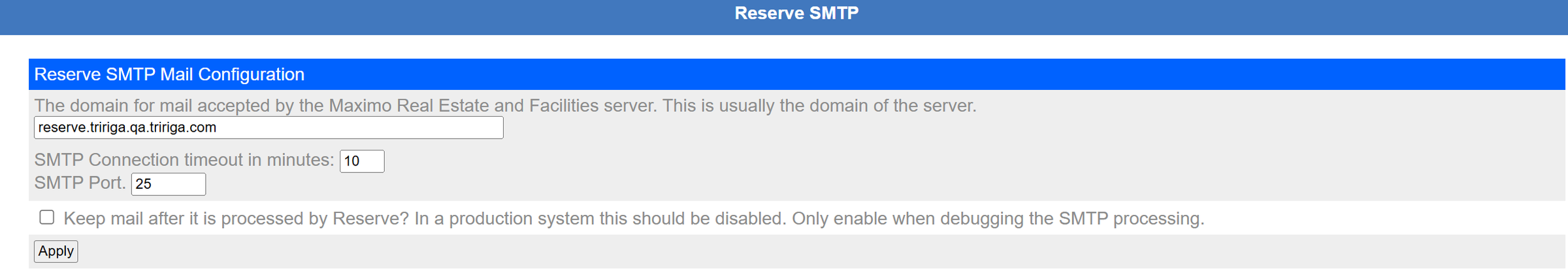

Reserve SMTP Agent
Inbound mail settings for room booking. Still the sample domain here, which is why the agent shows Start Failed.

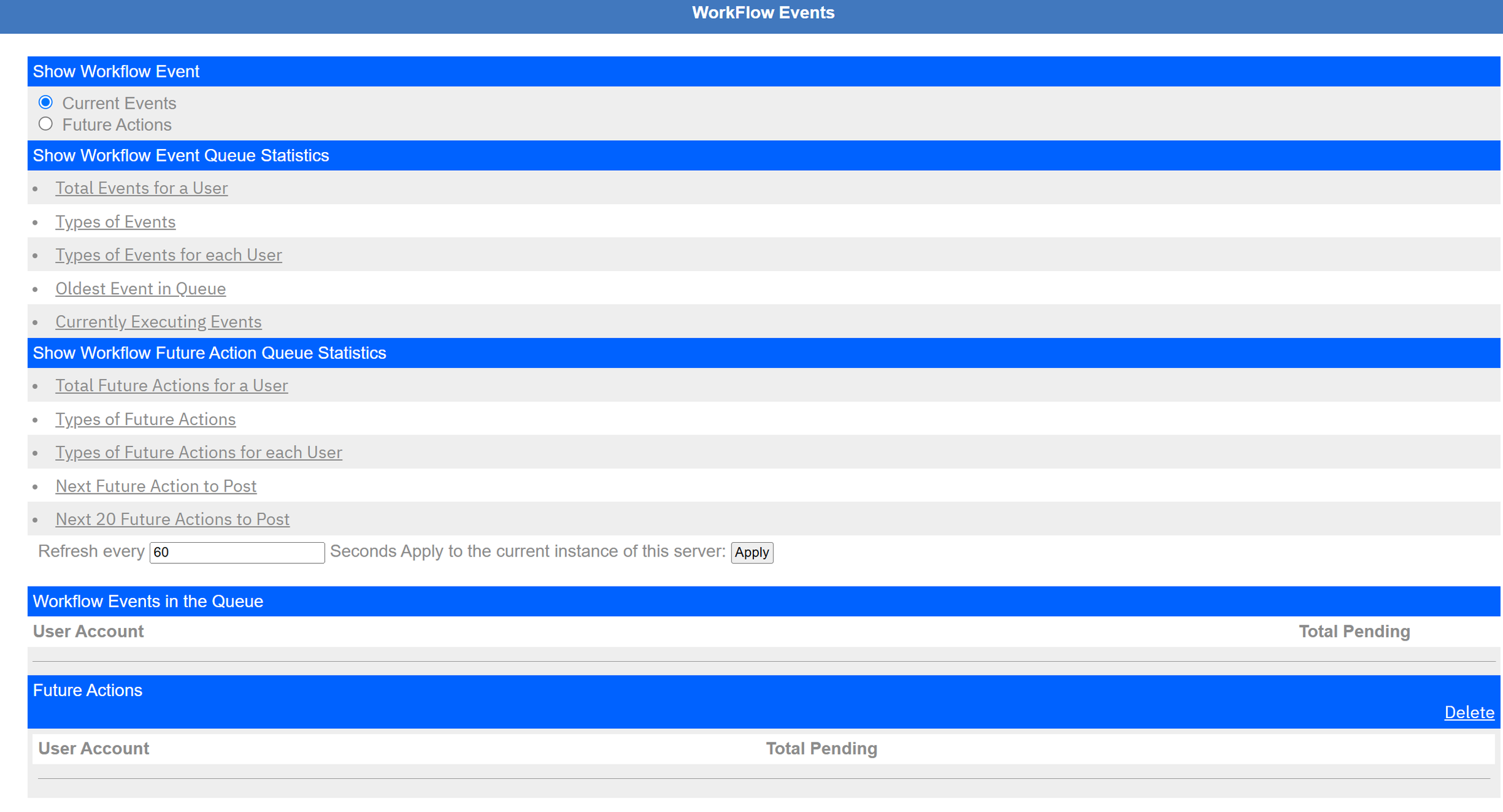

Workflow Events: what is waiting in the queue (current events) and what is scheduled (future actions).
  • Workflow Events in the Queue: pending events per user. Empty is good. A number that only grows means the WFAgent is stopped, overloaded or failing.
  • Oldest Event in Queue: how far behind the agent is.
  • Future Actions: actions waiting for a date (WFFutureAgent).

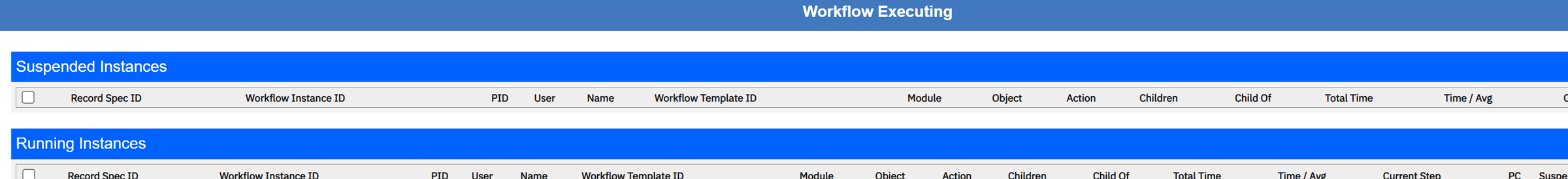

Workflows Executing: running and suspended workflow instances, with Stop, Suspend and Resume.
A workflow that never finishes (a loop, a lock) shows here with its current step and run time. Stop it here rather than restarting the server.

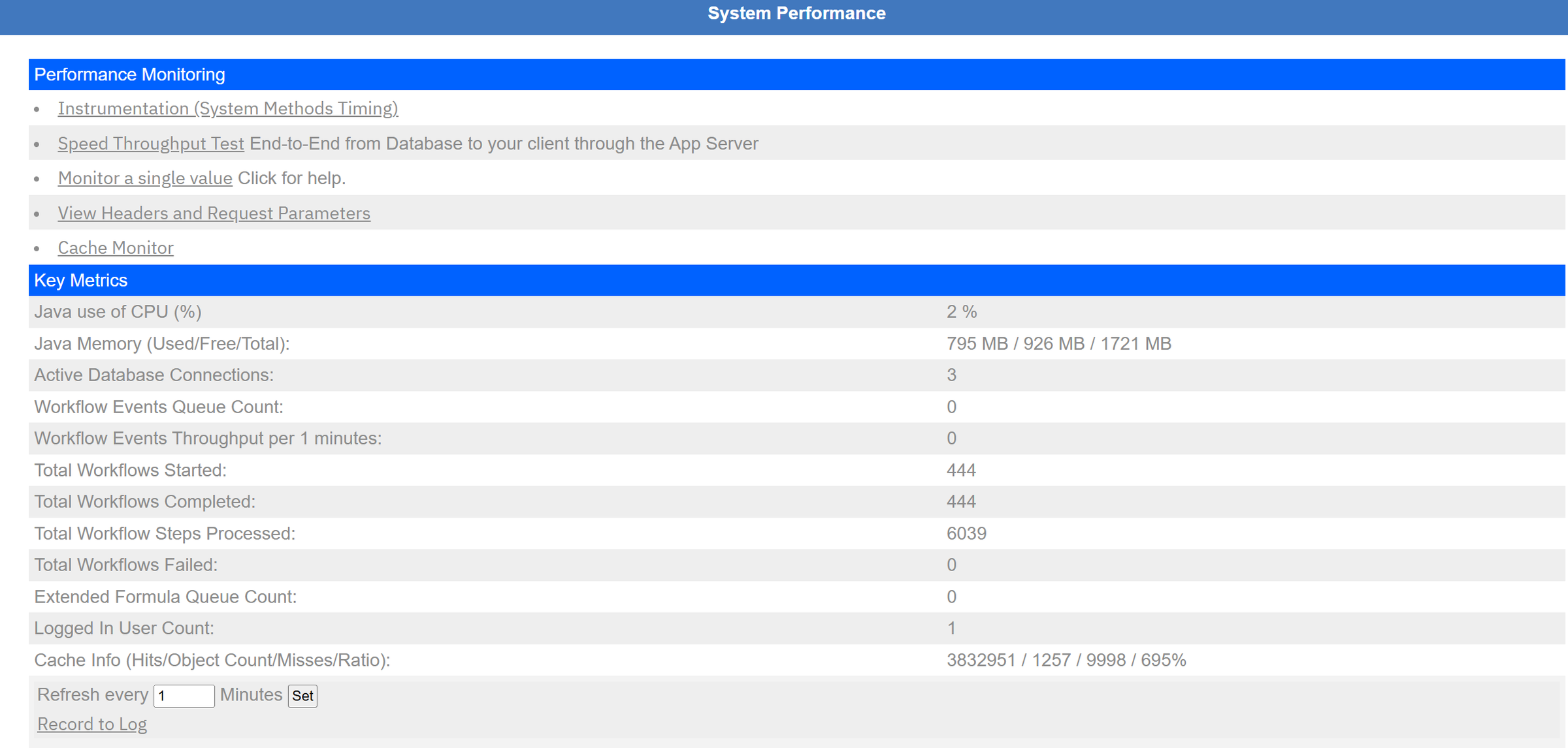

Performance Monitor: key metrics, refreshed every minute.
The quickest health check: CPU, heap, open database connections, workflow queue count and throughput, workflows started, completed and failed (since the server started), extended formula queue and logged-in users. "Record to Log" writes the numbers to the log, handy before and after a load test.

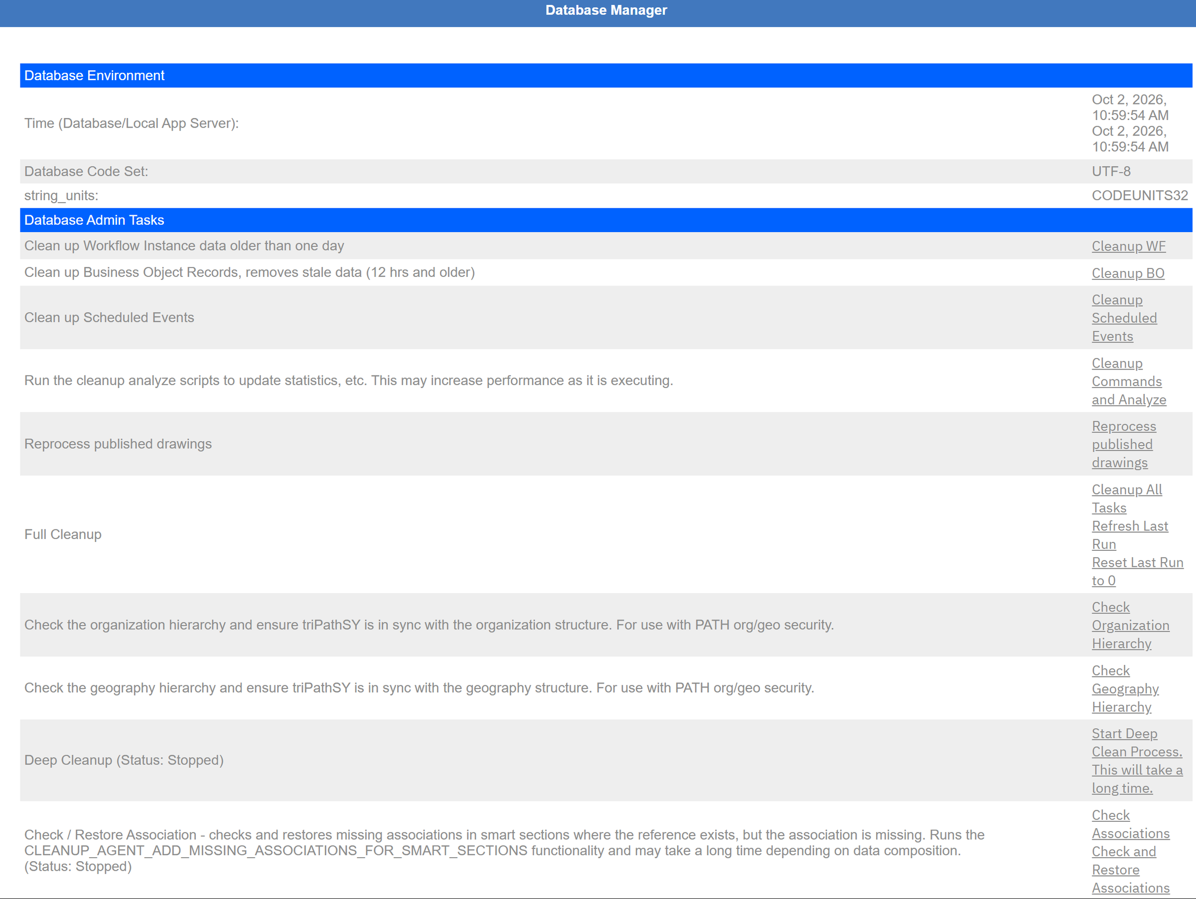

Database Info
Database clock, code set and one-click maintenance tasks.
The top checks that the database and server clocks agree, and that the database is UTF-8 (CODEUNITS32 on Db2). The Database Admin Tasks run the cleanup jobs now instead of at night: clean up workflow instances, stale records, scheduled events, re-analyse statistics, check the organisation and geography hierarchies, deep cleanup, check and restore associations. They change data and can run for a long time: use them on purpose, outside business hours, with a recent backup.

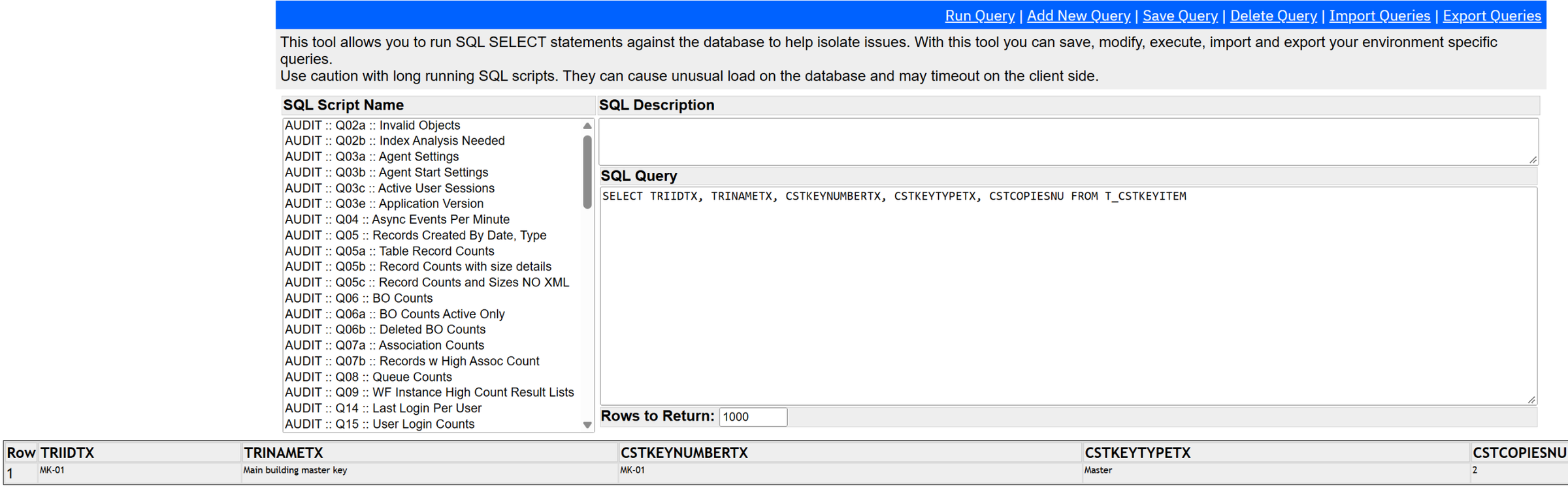

Database Query Tool
SELECT-only SQL against the MREF database, with IBM's library of audit queries on the left.
Runs SELECT statements only. The list on the left is a library of ready-made audit queries (agent settings, record counts, workflow queue counts, logins). It is the fastest way to answer "did the workflow run?" (WF_EVENT_HISTORY) or "what is in this record?" (the T_<BO> table).

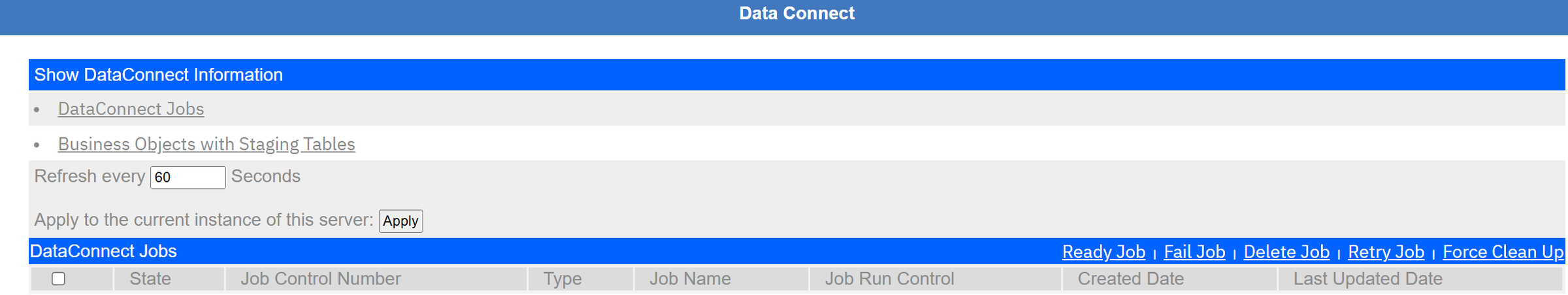

Data Connect
DataConnect jobs: one row per integration batch, with Ready, Fail, Retry, Delete.
When an external system writes rows into staging tables, DataConnect turns them into records in batches ("jobs"). This page shows each job's state and lets you retry or fail it. Empty here: no DataConnect integration is running.

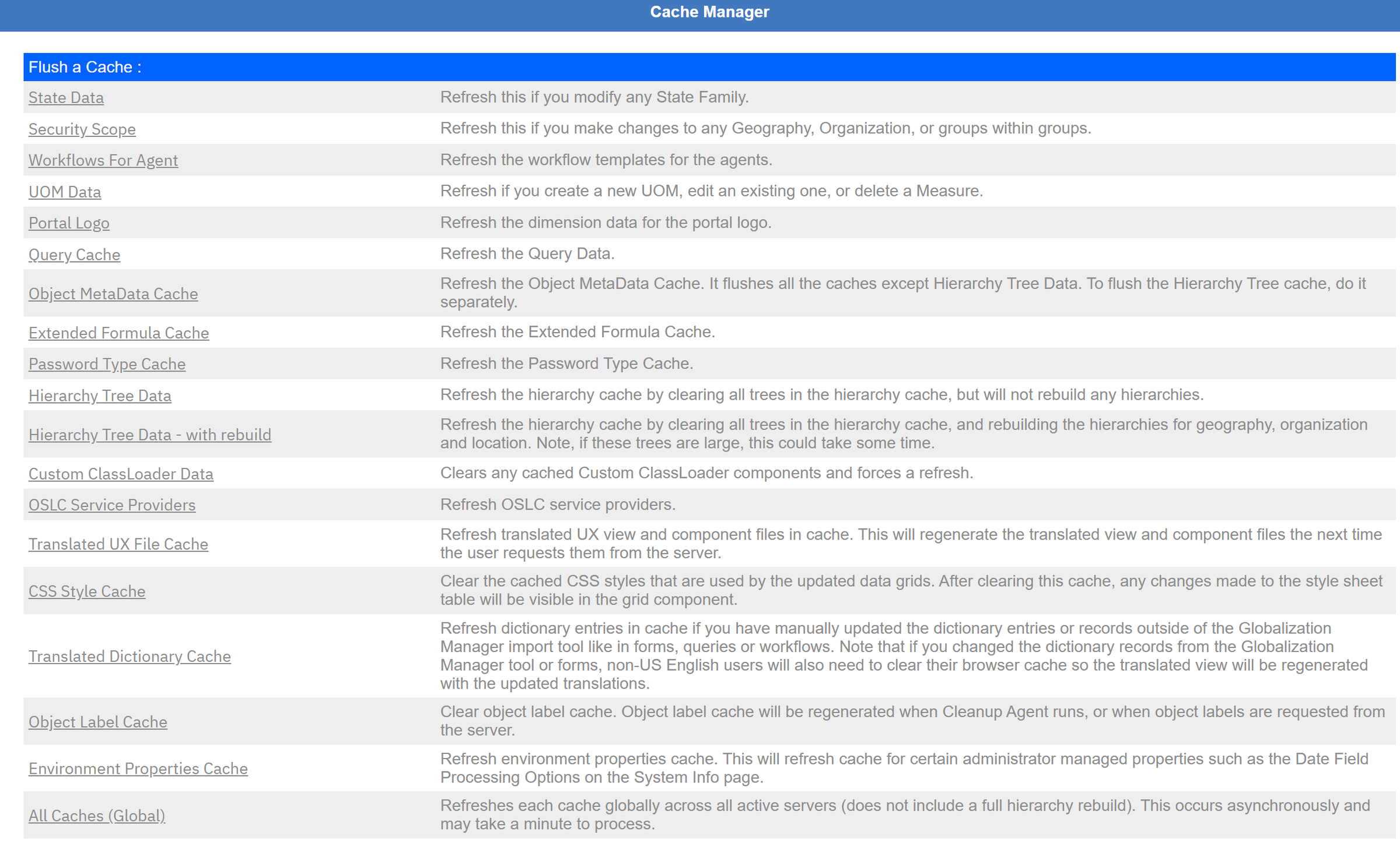

Caches
Every cache, and what to flush after which change.
MREF keeps metadata in memory for speed. When a change does not show up, flush the matching cache rather than restarting: Workflows For Agent after publishing a workflow the agent does not pick up, Security Scope after organisation or group changes, Query Cache after query changes, Object MetaData Cache after Data Modeler work. All Caches (Global) flushes everything on every server; it is safe but makes the next minutes slower for everyone.
In Maximo terms
The equivalent of the "refresh" actions you trigger after changing System Properties, security groups or domains, collected on one page.

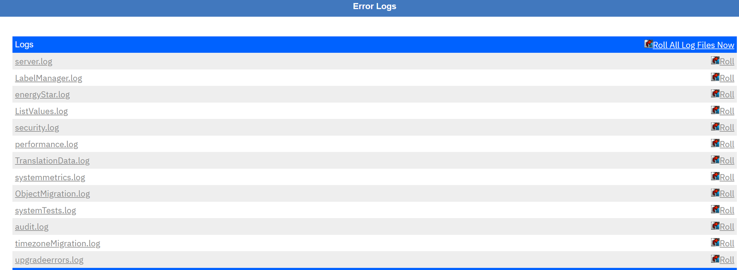

Error Logs
The log files of this server and the last 20 major exceptions.
Click a log to read it, "Roll" to start a fresh file. server.log is the main one. Remember it is the log of the UI server; agent errors are in the multiagents pod's log.

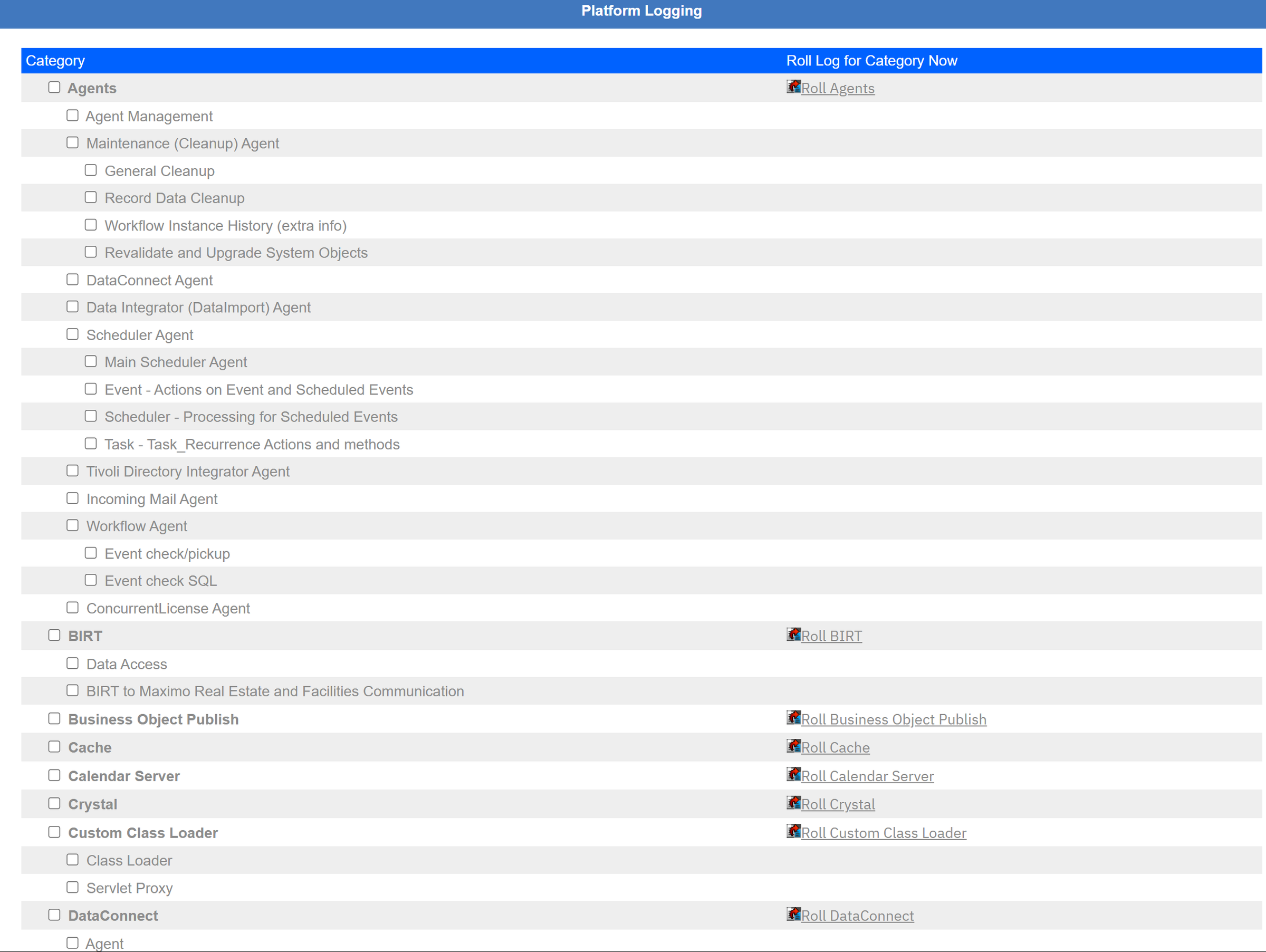

Platform Logging
Debug switches per area: agents, BIRT, publish, cache, DataConnect and more.
Tick a category to add DEBUG output for it to the log: for example Workflow Agent → Event check/pickup when workflows do not start. Untick it when you are done: debug logging is large and slows the server.
In Maximo terms
The Logging application: per-logger levels, applied immediately.

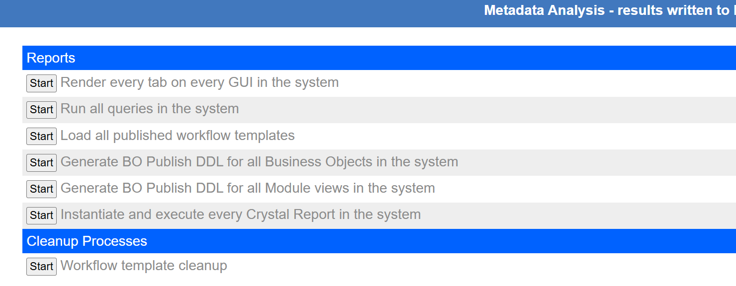

Metadata Analysis
System-wide self-tests; results go to the log.
Renders every form, runs every query, loads every workflow, generates publish DDL. Useful after an upgrade or a big migration to find broken metadata. Each one is heavy: run it on a test system or at night.

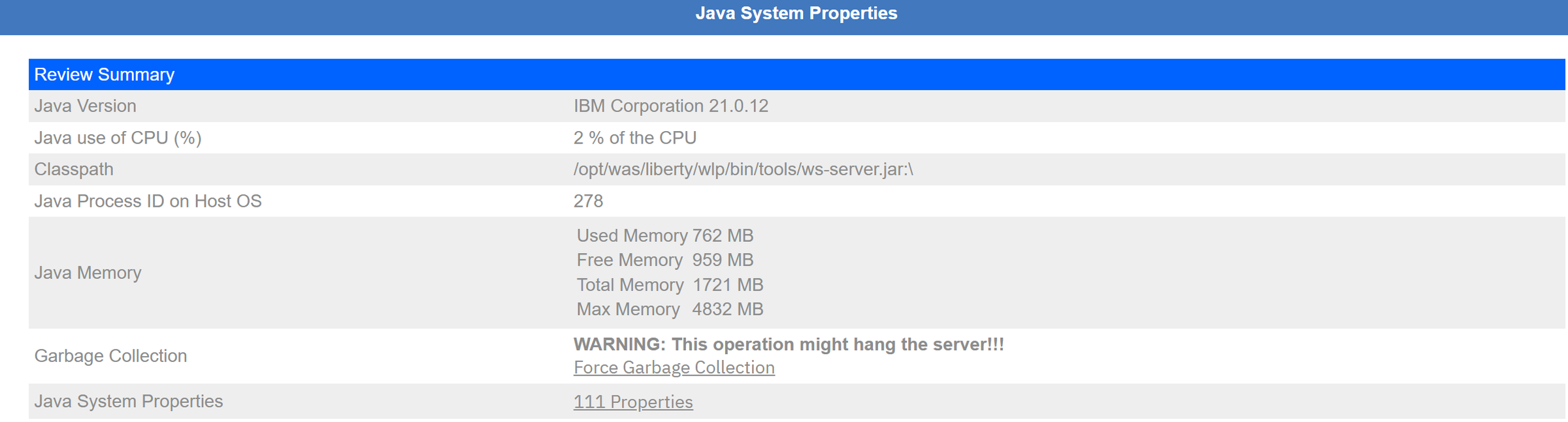

Java Info
JVM version, CPU, heap and the Java system properties.
Note the warning on Force Garbage Collection: it can pause the server. Leave it alone.

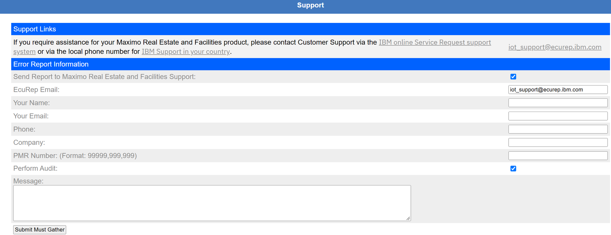

Must Gather Tool
Collects logs and settings into a package for IBM Support, linked to your case number.
Use it when IBM Support asks for it. On MAS, also collect the OpenShift side (the MAS must-gather) so support sees the pods too.

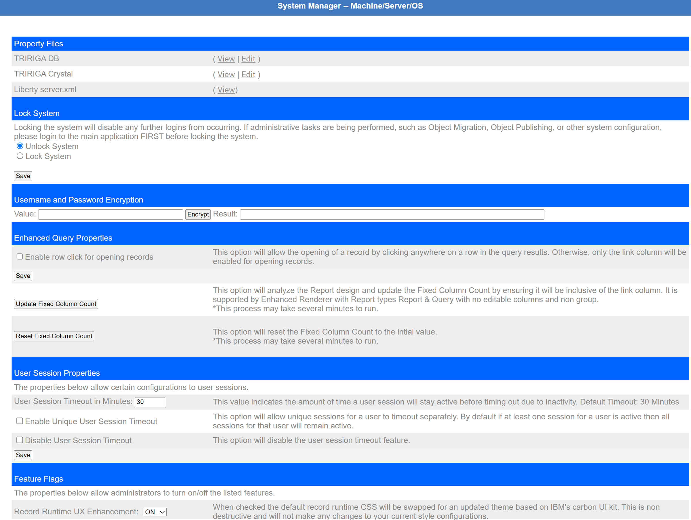

System Info
Property files, Lock System, value encryption, query and session settings, feature flags.
  • Property Files: view the TRIRIGA properties and Liberty server.xml of this pod. On MAS, edit them through the FacilitiesWorkspace secrets, not here.
  • Lock System: blocks new logins, for example during an Object Migration. Sign in to the application first, or you lock yourself out.
  • Username and Password Encryption: encrypts a value for use in a properties file.
  • User Session Timeout: 30 minutes here (the fallback while MAS's value cannot be read).
  • Feature Flags: switches for newer behaviour, such as the Carbon-style record pages.
Build Number
Application 9.2.2 on platform 9.2.6, and the upgrade history (from 9.1.2 on 15 September 2026).
The first page IBM Support asks about. Code build, database build and language pack should all match.

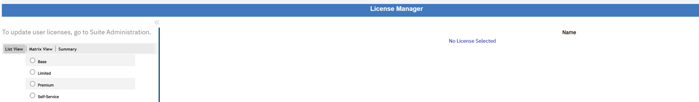

Licenses
Licence types and what each one allows. User licences are managed in MAS.
On MAS, who gets which licence (and AppPoints) is decided in Suite Administration; this page only shows what each licence type unlocks.
Admin Users
Who may open which console page, one tick per page.
Two pages, Platform Properties and AES Encryption, are not ticked even for system: they are hidden from the menu until someone grants them. Keep it that way unless you need them.

Workflow Events statistics

Database Admin Tasks, Deep Cleanup

Agent A background worker inside a Liberty server that polls a queue and does the work. Maximo: a cron task instance.
Instance ID Number of a server in the cluster: 0 for the UI pod, 3000 for multiagents here.
Multiagents pod The MAS pod that runs the agents and serves no users.
FacilitiesWorkspace The OpenShift custom resource the operator reads to build MREF. Where settings really live.
