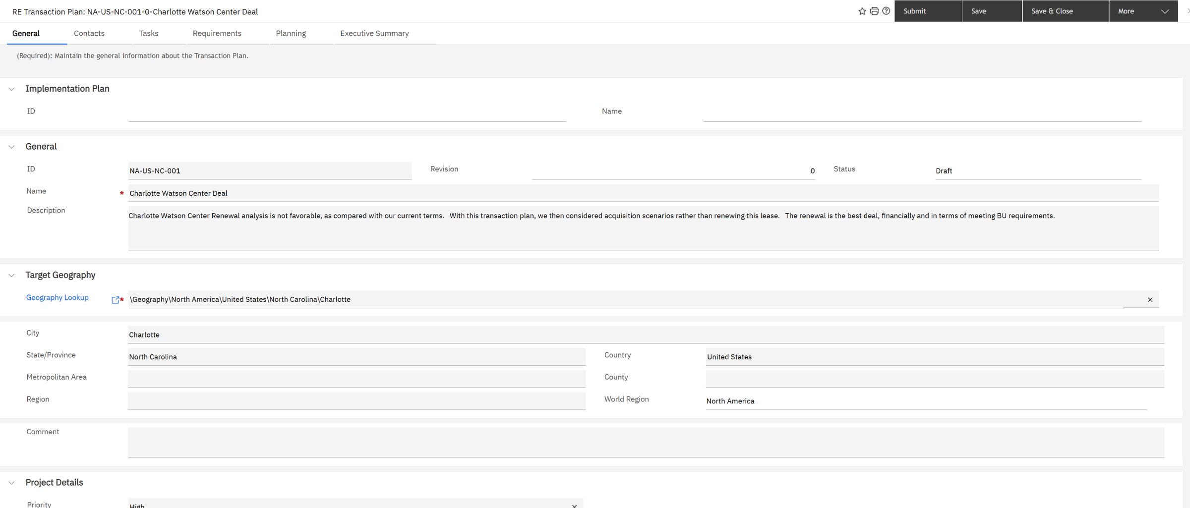

Everything starts with one record: the RE Transaction Plan. Its General tab says what the deal is, where, how urgent it is, and who works on it.
Transaction plan "Charlotte Watson Center Deal": status Draft, Charlotte geography, priority High.
Read the tabs from left to right and you have the whole method: General (what), Contacts (who: brokers, lawyers, the business sponsor), Tasks (the work to do), Requirements (what the business needs), Planning (the options) and Executive Summary (the comparison).

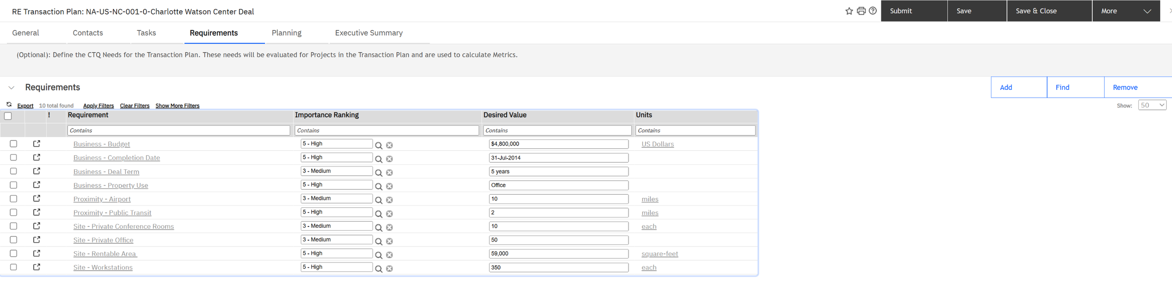

Before looking at any building, the plan records the requirements as measurable targets, called CTQs (critical to quality, a Six Sigma term). Each one is a number or a date that an option either meets or misses.
Requirements: ten CTQs, from budget and completion date to rentable area, workstations, offices and distance to the airport.
Requirement Target Why it matters
Budget $4.8M The ceiling the business will fund.
Completion date 31 July 2014 When the team must be in.
Lease term 5 years How long the business wants to commit.
Rentable area 59,000 sq ft What will be paid for.
Workstations / offices / conference rooms 350 / 50 / 10 Headcount the space must hold.
Airport / public transit within 10 mi / 2 mi Location constraints that rule buildings out.
Use Office Zoning and building type.
Do the math
59,000 sq ft ÷ 350 workstations ≈ 169 sq ft per workstation, rentable. That is within the range of a typical office (roughly 150–250 sq ft per seat, common areas included), so the requirement is consistent. If it came out at 100, the brief would be asking for too many people in too little space, and you would catch it here, before any deal.
Key idea · Requirements first
Writing the targets down before the options keeps the comparison honest: each option is scored against the same CTQs, not against whatever its sponsor chose to highlight.

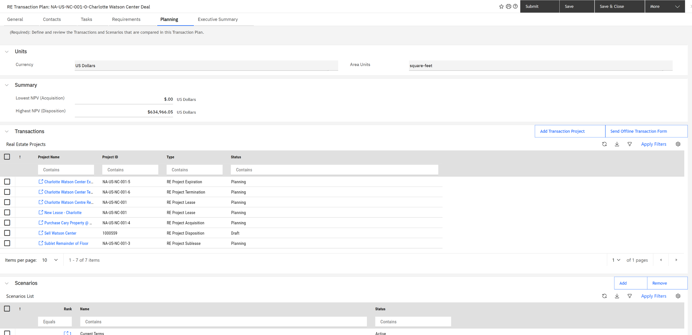

The Planning tab holds the options. Each one is a transaction project with its own type, and each type has its own financial model: a renewal has new rent, a purchase has a price and running costs, a sale has proceeds.
Planning: seven transaction projects (expiration, termination, renewal, new lease, purchase, disposition, sublease), the NPV range, and the scenarios that combine them.
Transaction project Type In plain words
Charlotte Watson Center Expiration Expiration Let the lease end and leave.
Charlotte Watson Center Termination Termination Use the break option and leave early.
Charlotte Watson Centre Renewal Lease renewal Stay, on new terms.
New Lease – Charlotte New lease Move to another rented building.
Purchase Cary Property Acquisition Buy a building and move there.
Sell Watson Center Disposition Sell an owned property.
Sublet Remainder of Floor Sublease Keep the space and rent out the part not used.

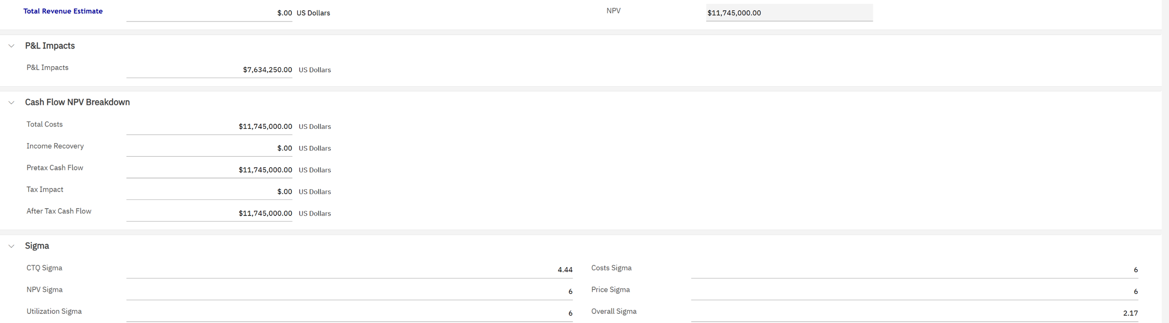

Open a scenario and its Summary Metrics show two things: the money, and a set of scores.
Scenario "Current Terms": P&L impact $7,634,250, total costs and NPV $11,745,000, and the sigma scores: CTQ 4.44, Overall 2.17.
Key idea · NPV
Net present value brings every future payment back to today's money, using a discount rate. $1M paid in ten years is worth less than $1M paid today, so NPV lets you compare a cheap-now-expensive-later option with an expensive-now-cheap-later one on equal terms. In this plan the scenarios are mostly costs, so the NPV is the present value of what the scenario will cost: the smaller, the better.
Key idea · Sigma scores
Each metric is converted to a sigma score, the Six Sigma scale where 6 is near-perfect. CTQ scores how well the scenario meets the requirements of Chapter 2; NPV, Utilization, Costs and Price score each dimension; Overall combines them. The scores put money and fit on one scale, so a cheap scenario that misses half the requirements cannot win on price alone.
Read the screen
Current Terms scores 6 on NPV, utilization, costs and price, yet only 4.44 on CTQ and 2.17 overall. Staying put is financially the baseline, but it does not meet what the business asked for. That gap is the reason the plan exists.

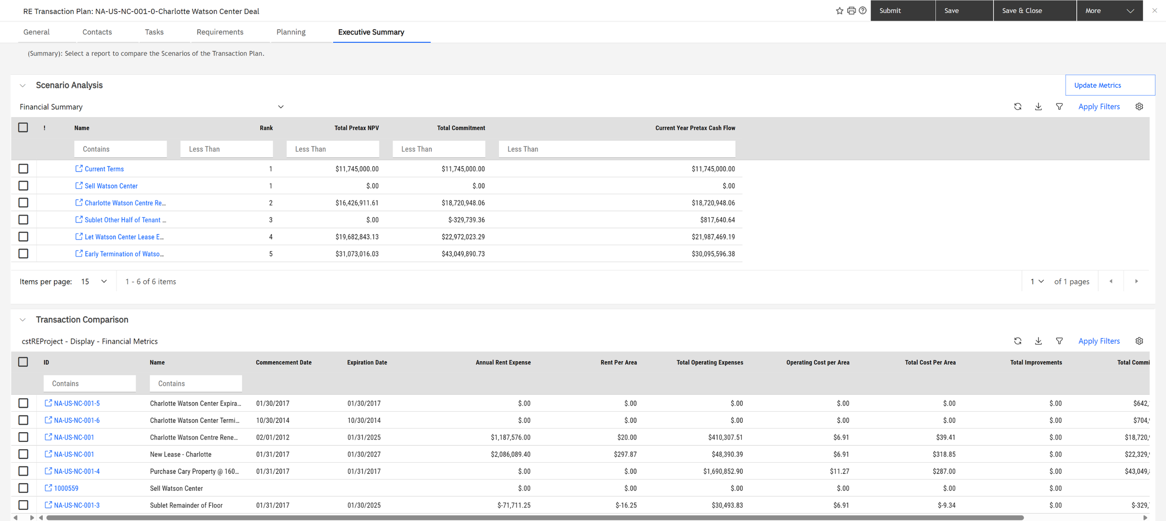

The Executive Summary tab is the page for leadership: every scenario ranked, and every transaction project compared column by column.
Executive Summary: Scenario Analysis (rank, total pretax NPV, total commitment, current-year cash flow) above the Transaction Comparison of all seven projects.
Scenario Rank Total pretax NPV Total commitment
Current Terms 1 $11,745,000 $11,745,000
Sell Watson Center 1 $0 $0
Watson Centre renewal 2 $16,426,912 $18,720,948
Sublet other half of the floor 3 $0 −$329,739
Let the lease expire (and move) 4 $19,682,843 $22,972,023
Early termination 5 $31,073,016 $43,049,891
Do the math
Commitment vs. NPV. The renewal commits $18.7M of payments, but they are spread over years, so in today's money they are worth $16.4M. The gap, $2.3M, is the effect of discounting.
A negative commitment. Subletting shows −$329,739: the scenario brings money in rather than paying it out.
Leaving early is expensive. Early termination costs $31.1M in NPV against $16.4M for renewing: the termination fee, plus paying for new space sooner. The summary makes that visible in one row.
The lower table, Transaction Comparison, is where the analyst checks the drivers: annual rent, rent per area, operating expenses, cost per area, improvements and commitments for each project. The renewal, for example, carries $1,187,576 of annual rent at $20 per sq ft and $410,308 of operating expenses; the sublease shows a negative rent (−$71,711), because it is income.
Watch the units
The renewal's rent per area is $20 (per square foot), the new lease's is $297.87. Not fifteen times more expensive: the new lease is recorded in square meters. $297.87 ÷ 10.764 ≈ $27.67 per sq ft. Check the units field of each project before comparing per-area numbers.

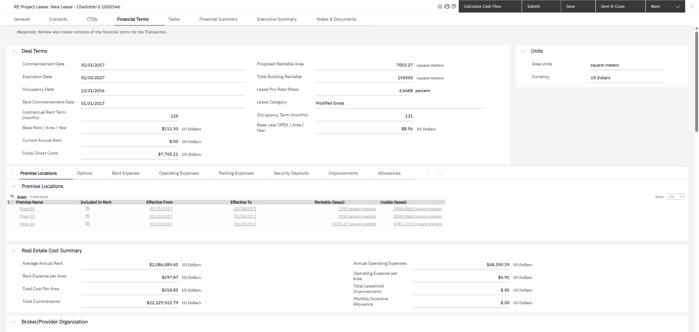

Once a scenario is chosen, its transaction projects become real deals. The new lease's Financial Terms tab holds the negotiated terms, and they become the lease abstract the lease administrator works with afterwards.
RE Project Lease "New Lease – Charlotte": deal terms, the three floors in the premises, and the real estate cost summary.
Check the terms
Area. Floors 01, 02 and 03: 2,950 + 2,950 + 1,103.27 = 7,003.27 m² rentable, the proposed rentable area.
Pro-rata share. 7,003.27 ÷ 150,000 m² (the building) = 4.6688%, the share of the building's operating costs GreenPoint will pay.
Operating cost per area. $48,390.39 ÷ 7,003.27 = $6.91 per m², as shown.
Average rent per area. $2,086,089.40 ÷ 7,003.27 = $297.87 per m², as shown.
A free month. Occupancy starts 31 Dec 2016, rent starts 31 Jan 2017: occupancy term 121 months against a rent term of 120. The tenant moves in a month before paying rent, which is a typical incentive for fit-out.
