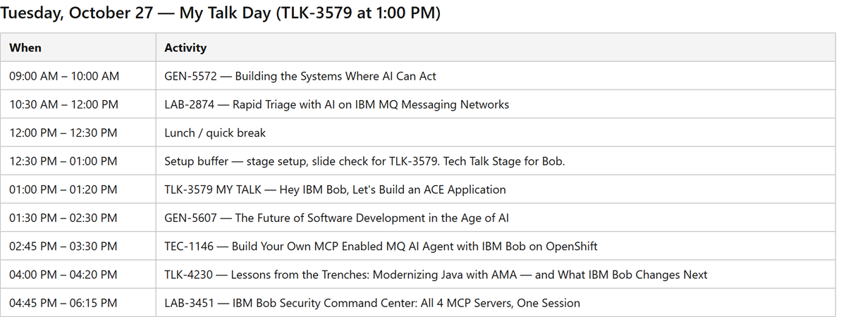

To show you what that looks like, this is my Tuesday, as Bob planned it, one session per slot:
planning
You also get the reasoning behind every choice. For my Tuesday that was:
  • My own talk is fixed, with the half hour before it kept free to set up,
  • The ACE lab I wanted runs right through my talk, so it went on the alternates list, and I do the MQ triage lab in the morning instead,
  • The 11:45 sessions overlap the end of that MQ lab and run until my setup time, so that became lunch,
  • TEC-1146 was picked over three other breakouts, and over a tech talk that overlaps it by five minutes.
After the day tables, you get fifteen alternates, each with the reason and the moment you would swap it in. The count per area: 5 Bob, 6 ACE, 7 MQ, with some sessions counting for more than one area. In total, that's 18 sessions over four days, including my two.
