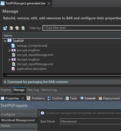

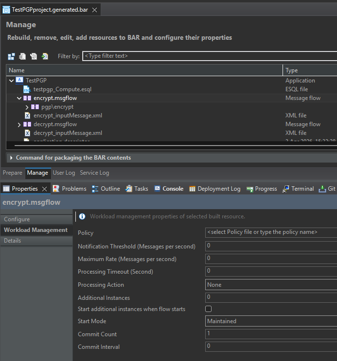

The cleanest place to set this is in the BAR file itself. Every application and message flow has a Start mode property under the Workload Management properties group.
Three values:
  • Maintained: Keeps the current state across redeploys and restarts. Only changes when you explicitly start or stop it.
  • Manual: Never starts after deployment, redeployment, or restart. Has to be started manually every time.
  • Automatic: Always starts after deployment, redeployment, or restart. No exceptions.
Maintained is the default. Nothing changes unless you change it.
You can also set this via an override properties file instead of in the BAR editor. The property is set at the application or flow level using # as a separator:
startMode = manual
pgp.decrypt#startMode = manual
