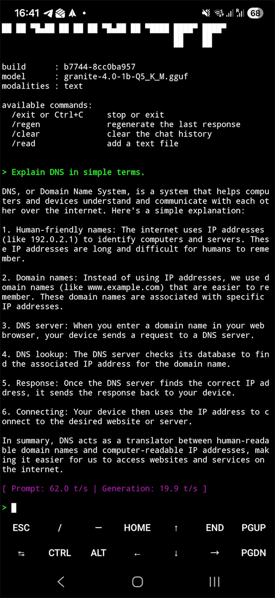

From inside the llama.cpp directory, run the following command:

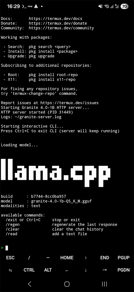

./build/bin/llama-cli \
  -m /storage/emulated/0/models/granite-4.0-1b-Q5_K_M.gguf \
  -t 8 \
  -c 2048 \
  --temp 0.7 \
  --top-p 0.9 \
  -p "Explain DNS in simple terms."
On a Galaxy S25 Ultra, you should see something in the ballpark of:
  • prompt processing around ~45–50 tokens/sec
  • generation speed around ~20–22 tokens/sec
At around 20 tokens per second, generation is already faster than most people can read:)
The context size is set to 2048 tokens as a stable default for mobile. Larger values increase memory usage and don’t buy you much for this kind of setup.
If you run into out-of-memory errors, sudden process termination, or aggressive thermal throttling, reduce the thread count.
Reasonable fallbacks are:
-t 6
or, if needed:
-t 4
If this works, the hard part is over (not that hard, really).

#!/data/data/com.termux/files/usr/bin/bash
MODEL="/storage/emulated/0/models/granite-4.0-1b-Q5_K_M.gguf"
BIN="$HOME/llama.cpp/build/bin"
$BIN/llama-server \
  -m "$MODEL" \
  -t 8 \
  -c 2048 \
  --host 127.0.0.1 \
  --port 8080 \
  > ~/granite-server.log 2>&1 &
sleep 3
$BIN/llama-cli \
  -m "$MODEL" \
  -t 8 \
  -c 2048 \
  --temp 0.7 \
  --top-p 0.9
Make the script executable:
chmod +x ~/granite-4.0-1b-start.sh
Run it:
./granite-4.0-1b-start.sh
When you exit the CLI, the HTTP server keeps running.

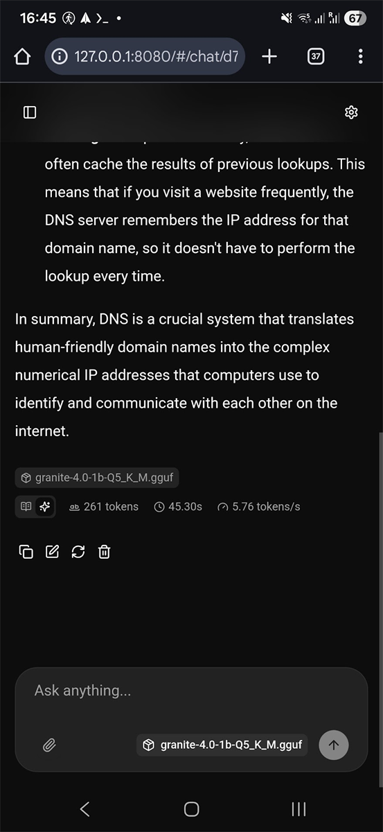

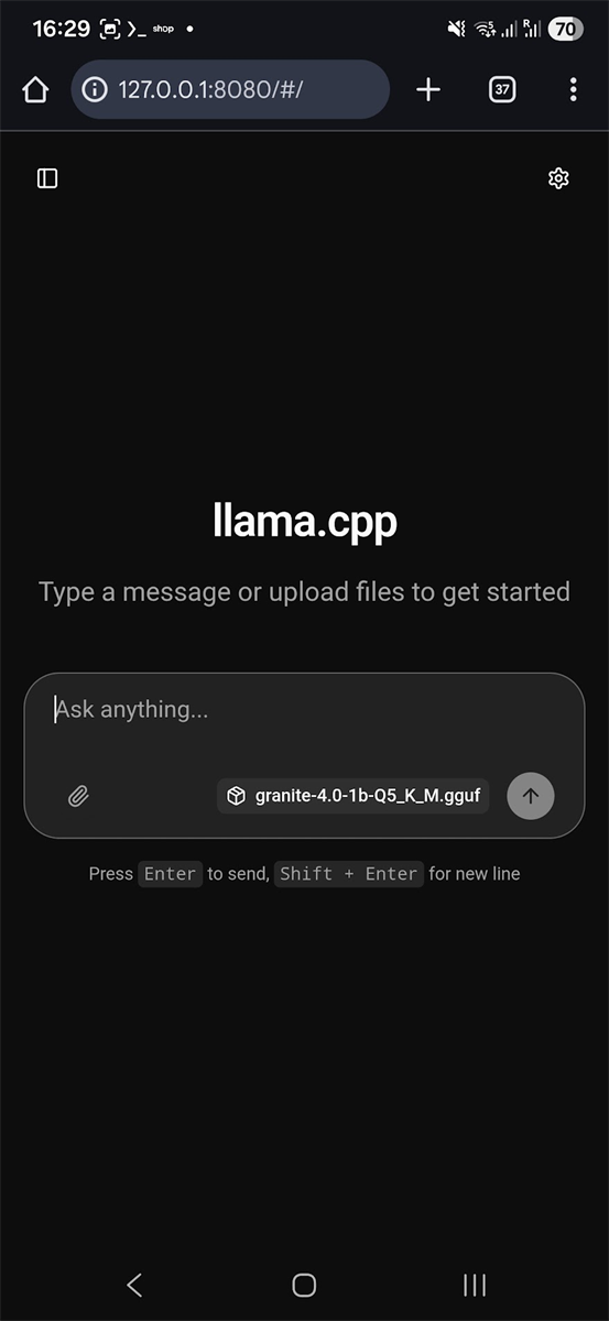

Step 8: Web UI
With the server running, open a browser on the phone and navigate to:
http://127.0.0.1:8080
That’s it.
You’ll get a web-based chat interface backed by the local HTTP server. Prompts are sent to the model, responses stream back in real time, and everything stays on-device. It is a bit slower than the CLI, but still very useful.
The interface keeps things simple, but it’s not bare-bones. You get proper chat behavior: conversation history is preserved, responses can be edited and regenerated, and you can work with multiple chats in parallel. In practice, it behaves much like the web interfaces people are already used to, just backed by a model running locally on the device.
Because the server binds to 127.0.0.1, it’s only accessible locally.
At this point, you can close the terminal if you like. As long as the server process is still running, the web UI will keep working.

  • Granite 4.0-H models use a hybrid architecture with state space layers and are not compatible with llama.cpp. This setup only applies to the transformer-based Granite 4 Nano models.
  • Q5_K_M works well on modern phones. If you run into stability issues, lowering the thread count is usually the first step.
  • The CLI and HTTP server can run at the same time. Exiting the CLI does not affect the server as long as the Termux session stays open.
  • Once the model is downloaded, everything runs fully offline. No network access is required for inference.
  • The HTTP server is bound to localhost by default. Exposing it to the network is possible, but intentionally not covered here.
  • Performance, thermals, and battery impact vary by device. Newer phones handle this comfortably; older ones may need more conservative settings.
  • This setup is not optimized for background execution or for long battery life. It’s meant to be practical, not invisible.

At this point, Granite is running locally on the device, starts automatically with Termux, and is accessible both interactively and over HTTP.
I’ve said this already, but that’s what a closing is for, right?
There’s no cloud dependency, no account setup, and no special runtime beyond what’s shown above. Once the model is in place, everything else is just process management.
It’s not particularly impressive to look at. It’s just useful.
Which is exactly what you want from a local model.
