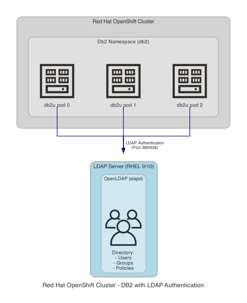

Overview
This guide provides step-by-step instructions for integrating OpenLDAP with IBM Db2 running on Red Hat OpenShift Container Platform. The integration enables centralised LDAP-based authentication, allowing Db2 databases to authenticate users against an external OpenLDAP directory server. This eliminates the need to manage separate user credentials within each Db2 instance and provides a unified authentication mechanism across your enterprise.

Architecture
