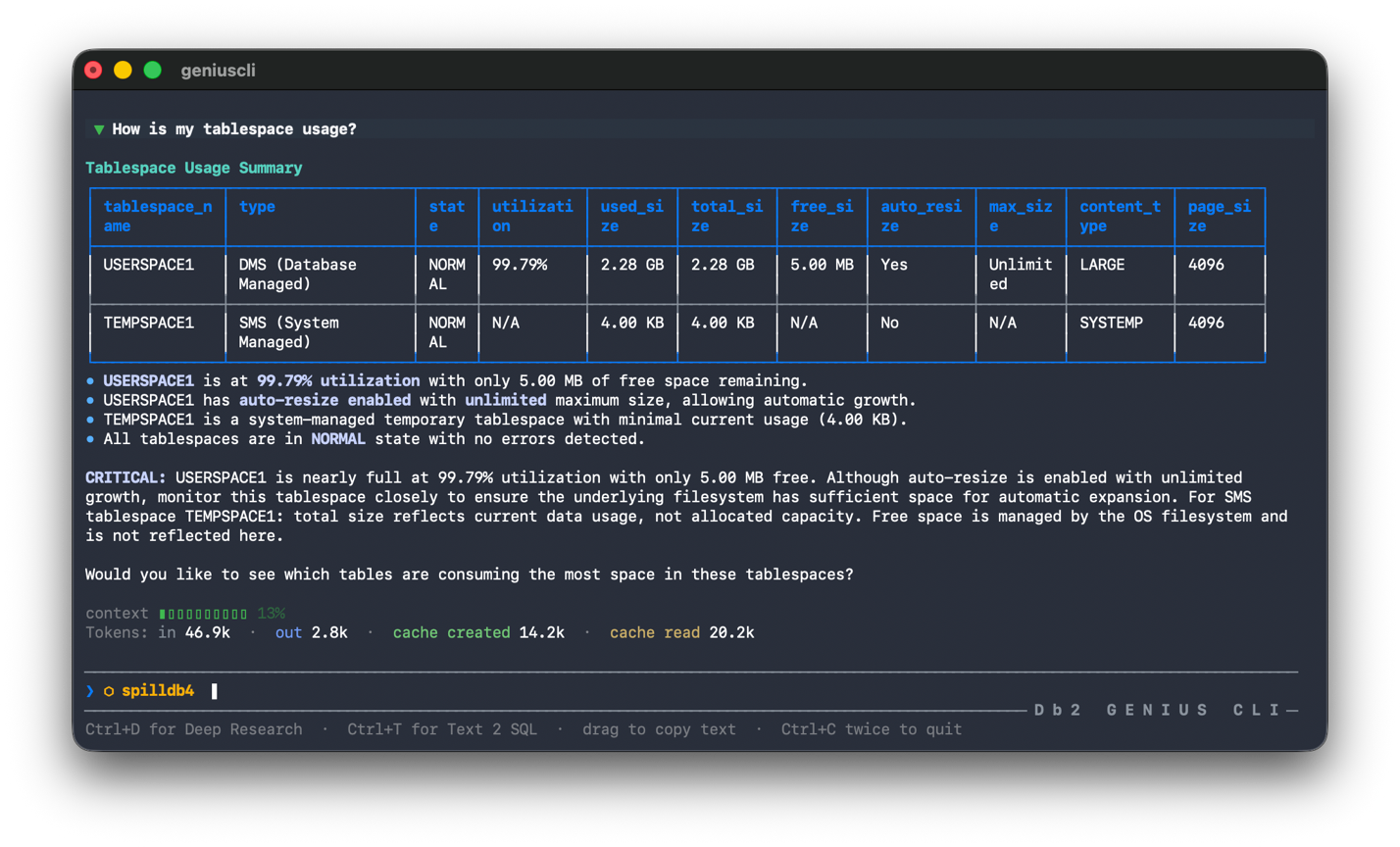

Type a question in plain English. Get a real answer, grounded in live data from your Db2 instance, streamed back in the terminal. That's it.

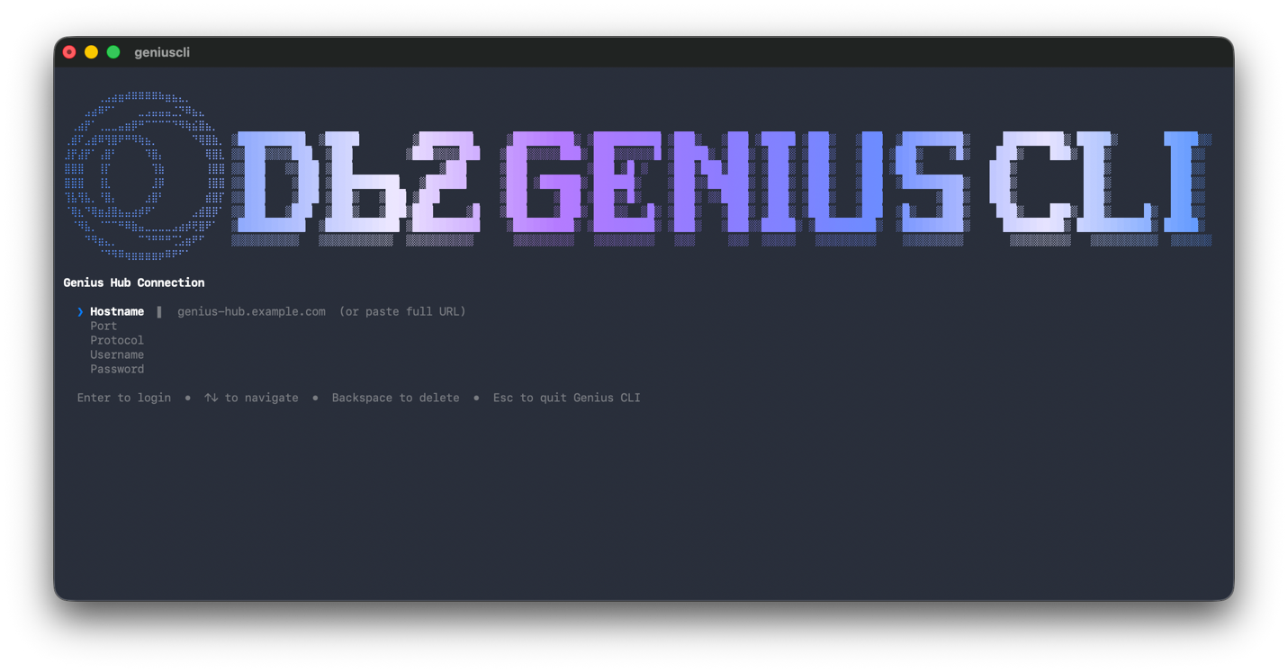

No configuration is required to get started. When you run geniuscli, a login form appears where you can enter your Genius Hub credentials interactively.
If you want to skip the login form and connect automatically every time, export your credentials in your shell:
export GENIUS_HUB_HOSTNAME=<host>
export GENIUS_HUB_PORT=<port>
export GENIUS_HUB_PROTOCOL=<https>
export GENIUS_HUB_USERNAME=<your-username>
export GENIUS_HUB_PASSWORD=<your-password>
Add those lines to ~/.zshrc or ~/.bashrc to persist them across sessions.
Note: Avoid storing passwords in shared environments or version-controlled shell profile files. Use the interactive login form when possible.
Starting a Session
geniuscli
Startup flow:
  1. Prompts you to select a theme on first launch (your choice is saved and restored automatically)
  2. Opens the login form — enter your Genius Hub credentials and press Enter. If credentials were exported in your shell, this step is skipped
  3. Chat session starts

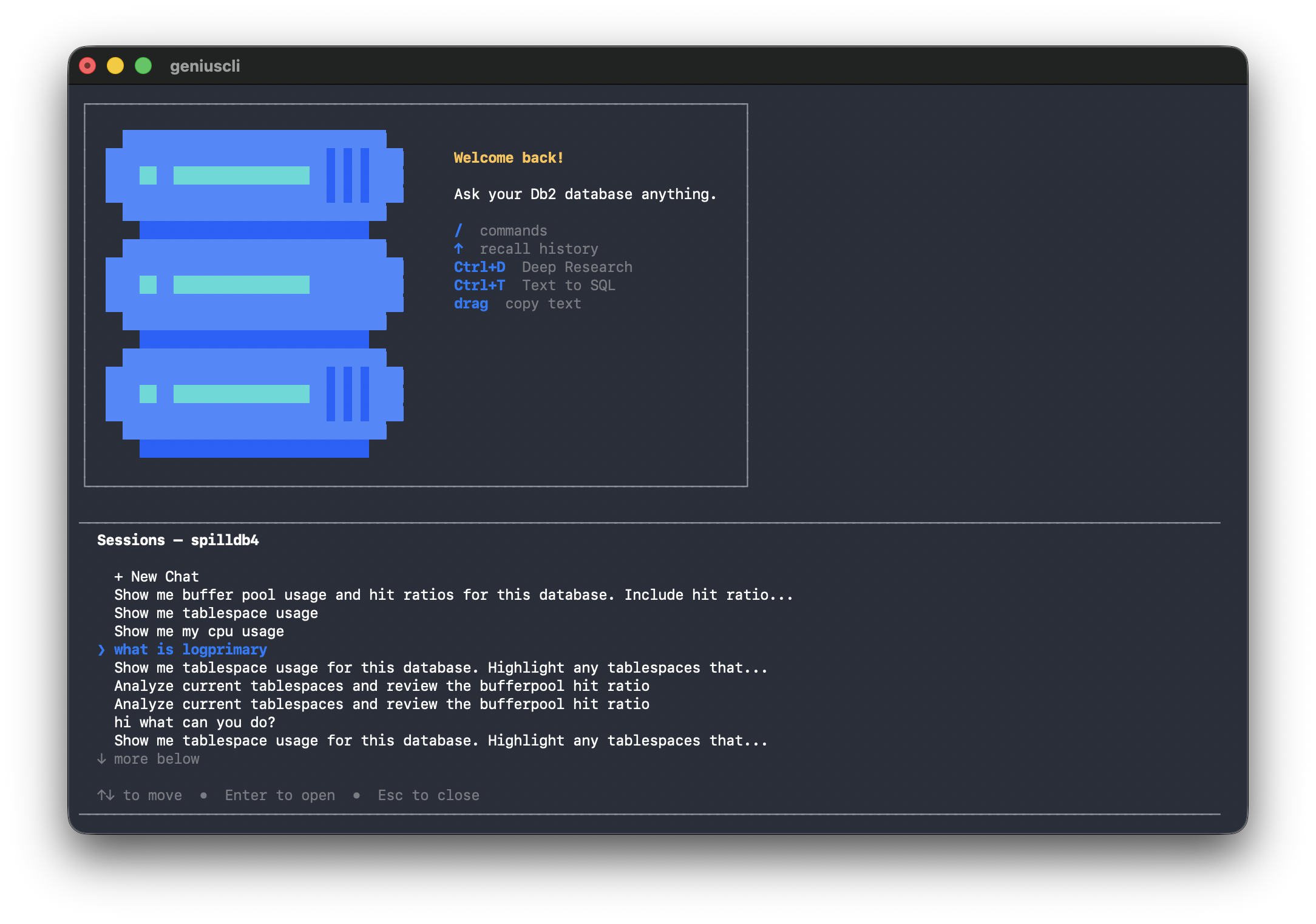

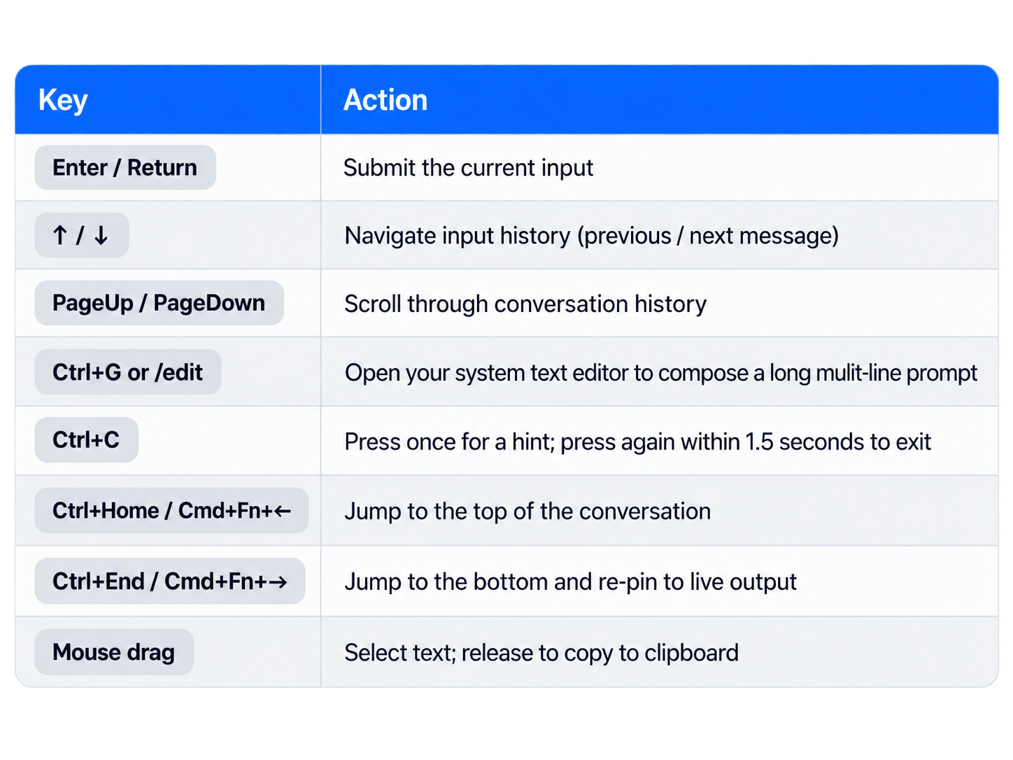

Type your question at the input bar and press Enter to submit. The AI streams its answer in real time. You can have up to three outstanding requests in flight simultaneously — further submissions are queued until one completes.

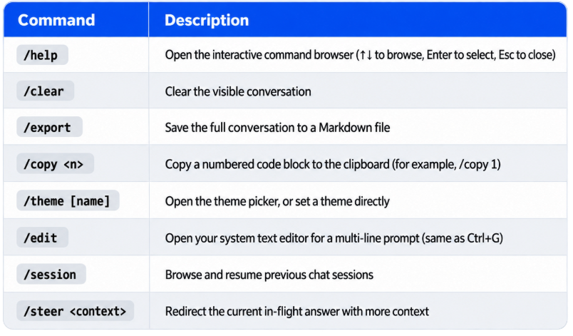

Keyboard shortcuts
Themes
Type /theme to open the theme picker. Multiple built-in themes are available. Your selection is saved and restored automatically on next launch. You can also set a theme directly:
/theme dracula
Slash Commands
Type / in the input bar to open the autocomplete command menu. Use ↑ / ↓ to navigate and Enter to insert the command. Type /help for an interactive command browser.

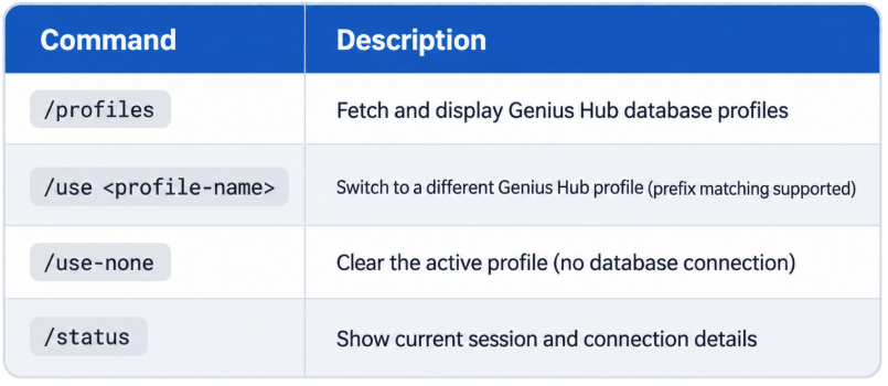

Connection management
Example:
/profiles
/use production-db

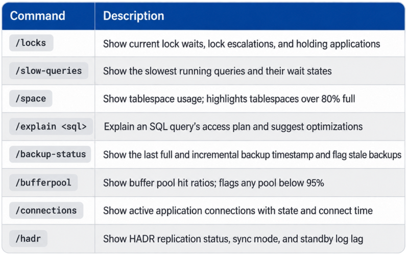

DBA shortcuts
These commands send a pre-built diagnostic question to the AI — one keystroke replaces writing out the full query.
Example:
/explain SELECT * FROM EMPLOYEE WHERE DEPTNO = 'A00'

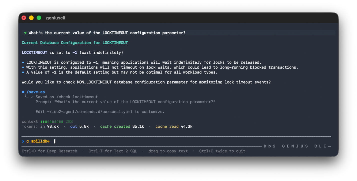

Save a query as a commandAfter sending a message, save that last query as a reusable command:
/save-as check-deadlocks
Rules for command names: lowercase letters, numbers, and hyphens only; must start with a letter; maximum 24 characters; cannot shadow a built-in command.
The command is saved to ~/.db2-agent/commands.d/personal.yaml and registered immediately. It will be available the next time you open geniuscli.

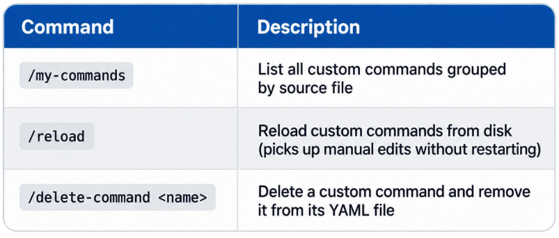

Manage custom commands

Place files in ~/.db2-agent/commands.d/ for automatic loading on startup. Run /reload after editing a file manually to pick up changes without restarting.
