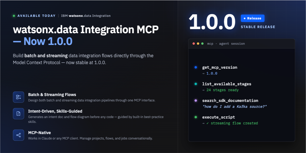

Agentic data integration is here with the watsonx.data integration MCP server 1.0.0 release
By John Wen posted 06/15/26 08:50 PM
Following our public preview earlier this year, we are excited to announce the 1.0.0 release IBM watsonx.data integration MCP Server. This MCP server connects your data integration workflows directly to the AI Agent of your choice, whether it's IBM Bob, Codex, Claude, or another compatible agent, so you can build, manage, and optimize your pipelines entirely through natural language.
The release is more than a stability milestone. It introduces a new planning workflow, expands discoverability to batch flows, adds a fourth out-of-the-box skill, strengthens on-premises support, and includes a round of usability improvements driven by what we learned during preview.
What's new in release
Agents now think before they act. The biggest behavioral change is that agents no longer jump straight to building. They draft an intent document first, sources, stages, transformations, targets, and wait for your review. Misunderstandings surface as sentences you can correct, not failed jobs you have to debug. First-attempt success goes up because the agent builds the pipeline you actually wanted.
Agents now see the full platform. Stage and property discovery, previously limited to streaming flows, now extends to batch. Agents enumerate available stages on demand and inspect each stage's required properties and preconditions, choosing configurations grounded in what the platform actually exposes rather than guessing from memory and producing malformed fields.
Agents now run reliably in real environments. Two preview pain points are resolved. The sandbox script execution tool times out far less often, so longer-running automations actually complete. And agents now reach every data center location without the connection issues that blocked some preview users.

Tools and skills at a glance
TheGA release ships with the following set of tools and skills:
Tools
  • Intent document — the planning tool that drafts a reviewable pipeline plan before building.
  • Stage and property discovery — for both streaming and batch flows.
  • SDK documentation list and lookup — find and reference the right SDK methods on demand.
  • Sandbox script execution — run SDK automation scripts in an isolated sandbox.
Skills
  • Batch flows
  • Streaming flows
  • Platform
  • Jobs
