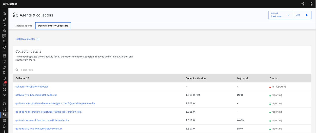

Step 2: Find your collectors in Instana
  1. In the Instana UI, go to the Agents & collectors page.
  2. Open the OpenTelemetry Collectors tab.

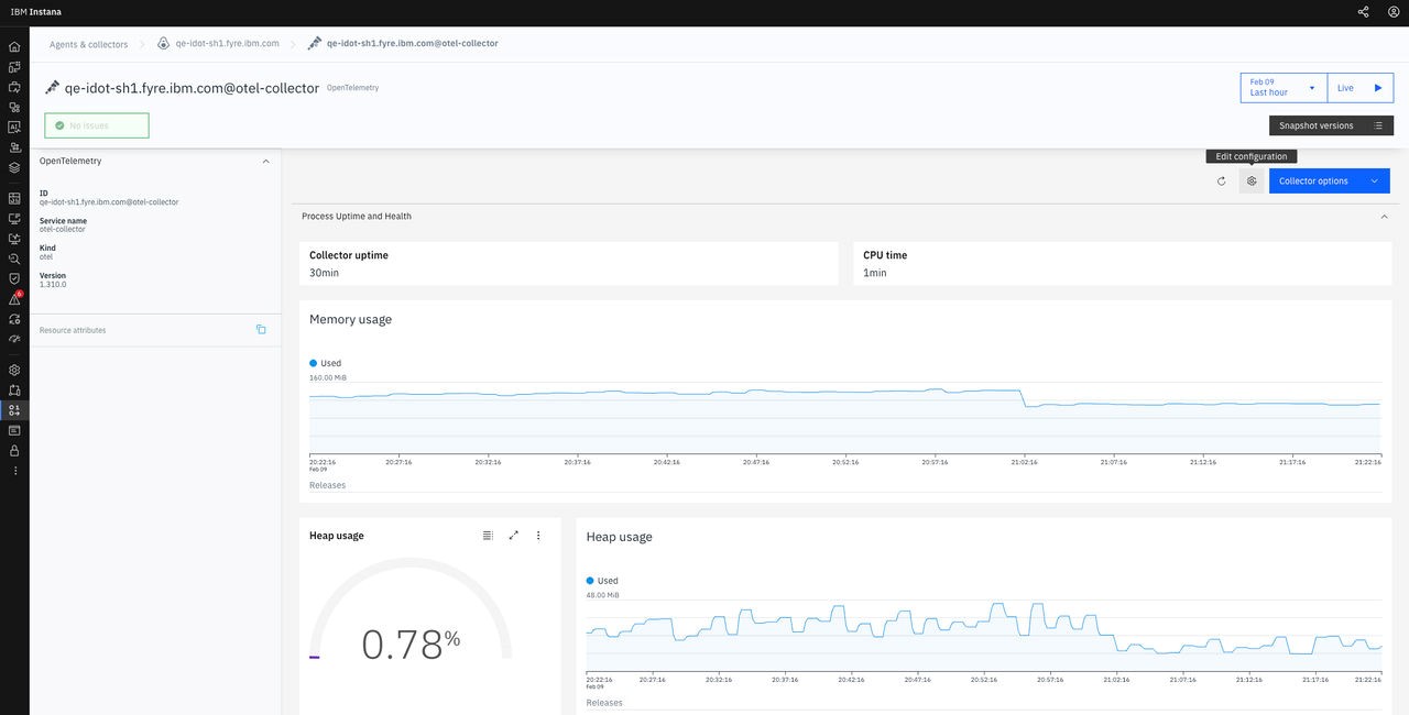

  3. Select a collector to open its dashboard.
At this point, you should see fleet-level health and per-collector internal metrics.

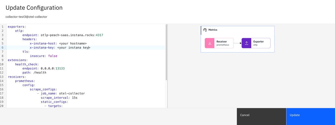

  • Edit collector configuration (with validation)

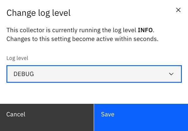

  • Change log level dynamically (DEBUG, INFO, WARN, ERROR)

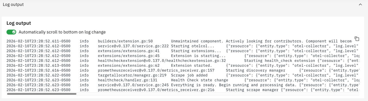

  • Stream real-time logs for faster debugging
Tip: Use log level changes + live logs as a lightweight "debug session" instead of logging into the host.

  1. Select the affected collector(s) in Agents & collectorsOpenTelemetry Collectors.
  2. Get quick state + context: version, health, and recent signals tell you whether this is isolated or fleet-wide.
  3. Temporarily change log level to DEBUG to capture more detailed diagnostic information about what the pipeline is doing.
  4. Stream real-time logs to confirm whether a processor rule is mutating attributes (rewrite/delete) in a way that breaks your tagging strategy (for example, team, tenant, and environment not present where you expect).
  5. Apply a configuration update from the UI (with auto-validation) to fix the processor rule.
  6. Verify the tags look correct again in Instana, then revert log level to INFO.
