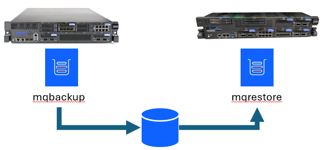

  • Back up your queue managers on your M2002 appliances using the mqbackup command, copy the backup file to the new appliances, then restore the backup using the mqrestore command. You don't have to stop the queue manager before taking the backup, but if you want to ensure that you have a consistent backup, and that persistent messages on your queues are processed exactly once by your applications, then you will want to stop the queue manager before taking the backup, and only restart the queue manager after restoring the backup on the new appliance.
    This method is fairly simple and doesn't require any direct network connectivity between the old and new appliances, but does involve an outage of the queue manager while the queue manager backup is taken, data copied to the new appliance, and restored.

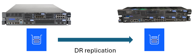

  • If the queue managers on your M2002 appliance are configured for Disaster Recovery (DR), then you can use the replication technology on the MQ appliance to copy the queue manager to the new M2004 appliance. The procedure is to switch over the queue manager to the current recovery appliance, replace the appliance at the main site with a new appliance, switch over the queue manager back to the main site, then replace the recovery appliance with a new appliance. This does involve several queue manager restarts, but each outage should be quite short, and there's no need to manually copy data to the new appliances.
  • Even if the queue managers on your M2002 appliance are not configured for DR, you can still make use of the DR replication technology on the MQ appliance to copy the queue manager data to the new M2004 appliance. You'll need to connect the DR replication network interfaces of the new and the old appliances first. By default, this is the eth20 10GB port. This can be as simple as connecting a network cable directly between the new and the old appliances, but the connection between the appliances can also go through network switches if that suits your environment better.
    When you've set up the network connectivity between the old and new appliances, you can add the queue manager to DR control, with the queue manager on the M2002 appliance initially having the DR primary role, and the queue manager on the M2004 appliance having the secondary role. You'll need to stop the queue manager to add the queue manager to DR control, but it can be restarted afterwards, so this should be a brief outage.
    Once you've configured DR replication for the queue manager, the queue manager and all its configuration and data, is automatically replicated from the M2002 to the M2004 appliance. You can then, at a convenient time, take a short outage of the queue manager to swap the DR roles on both appliances, so that the primary instance of the queue manager now runs on the new M2004 appliance. When you're happy that the queue manager has been successfully migrated to the new appliance, you can remove the queue manager from DR control on both appliances.
    This method does involve a some initial network configuration, and a few queue manager restarts, however the overall queue manager downtime is minimised compared to the backup and restore method.
