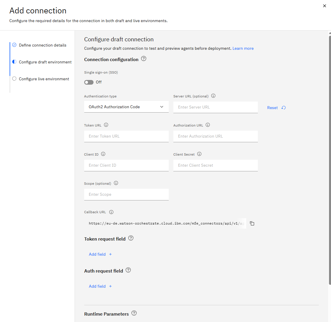

1. Navigate to the Connections section and begin creating a new OAuth connection.
2. On the connection setup page, you will see a redirect URL in the form:
   https://<wxo-region>.watson-orchestrate.cloud.ibm.com/mfe_connectors/api/v1/agentic/oauth/_callback
3. Copy this URL exactly. PA does exact-string matching on redirect URLs — a trailing slash difference or any whitespace will cause authorisation to fail.
4. Keep the wxO connection page open (or paste the URL into a notes file). You'll come back here in Step 3.

 Path A — wxO UI
In the connection setup page you left open in Step 1, fill in:
  • Type: `oauth_auth_code_flow`
  • Server URL: `https://<your-tenant>-dev.planning-analytics.cloud.ibm.com`
  • Authorization URL: `https://<your-tenant>-dev.planning-analytics.cloud.ibm.com/oauth2/authorize`
  • Scope: `v0userContext`
  • Credentials type: `member`
  • Client ID / Client Secret: the values you copied in Step 2
Repeat for the live environment (same values, drop the `-dev` suffix from the URLs).

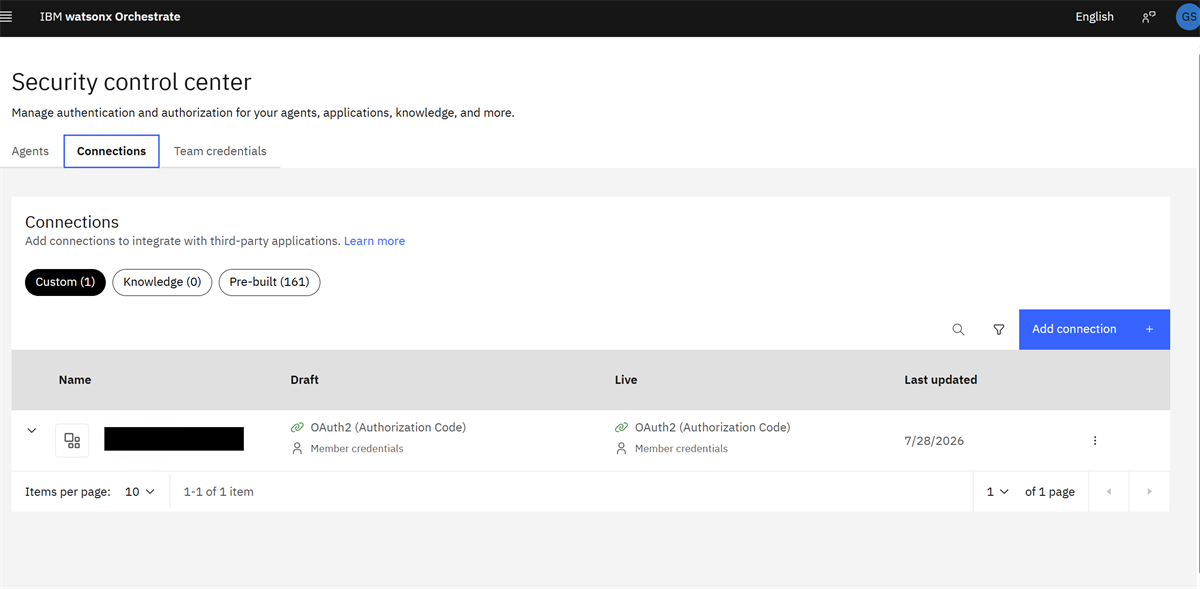

6. The connection status changes to Authorized / Connected in the wxO Connections UI:

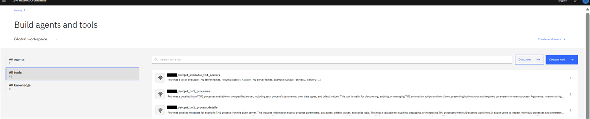

After associating the connection, you should see the full list of available PA MCP tools loaded in the global workspace:
