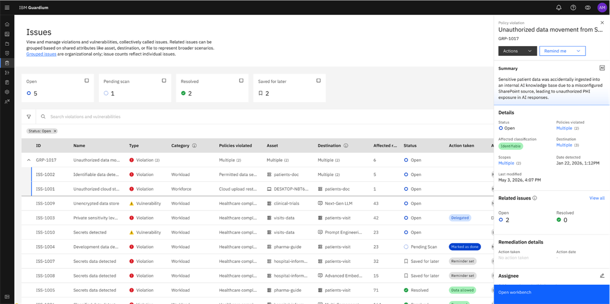

Your IBM Guardium Exposure Manager instance is continuously flagging open data exposure issues workforce (endpoints) and workload (datasources, saas applications, ETL jobs, cloud workflows). Largely where data is being accessed by Agents or possibly being used in RAG pipelines which in turn feeds context to chat bots.
IBM Guardium Exposure Manager Issues View
Your audit team needs a trail of every administrative action taken inside IBM Guardium Exposure Manager. Both of these data streams are available through IBM Guardium Exposure Manager’s REST API — but they don’t automatically land in QRadar, where your analysts live.

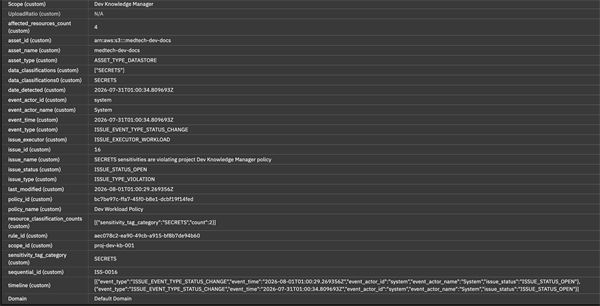

Step 6 — Create Custom Event Properties (CEPs)
Navigate to Admin → Custom Event Properties → Add and create the following properties. Alternatively, right-click an event in Log Activity → Extract Property once events are flowing.
Issue CEPs:
CEP Name Type
GEM Issue ID AlphaNumeric
GEM Sequential ID AlphaNumeric
GEM Issue Name AlphaNumeric
GEM Issue Type AlphaNumeric
GEM Issue Executor AlphaNumeric
GEM Issue Status AlphaNumeric
GEM Asset Name AlphaNumeric
GEM Asset ID AlphaNumeric
GEM Asset Type AlphaNumeric
GEM Affected Resources Count AlphaNumeric
GEM Policy ID AlphaNumeric
GEM Policy Name AlphaNumeric
GEM Date Detected AlphaNumeric
GEM Last Modified AlphaNumeric
GEM Scope AlphaNumeric
GEM Scope ID AlphaNumeric
GEM Rule ID AlphaNumeric
GEM Data Classifications AlphaNumeric
GEM Sensitivity Category AlphaNumeric
GEM Sensitivity Count AlphaNumeric

Issue events are identified by the presence of the issue_id field. The LSX maps the enriched issue detail payload to standard QRadar fields and the Issue CEPs listed above. The issue_id field maps to the standard QRadar field, and fields such as asset name, policy name, sensitivity category, and scope provide the rich context needed for rule-based offence creation.

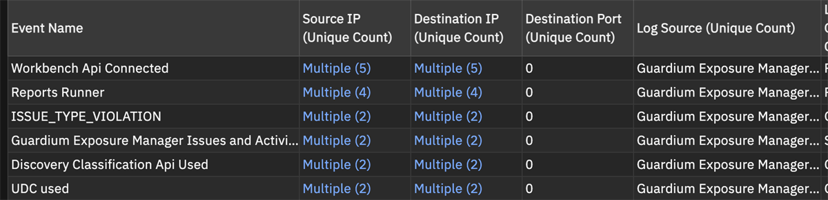

Custom Event Names for IBM Guardium Exposure Manager
