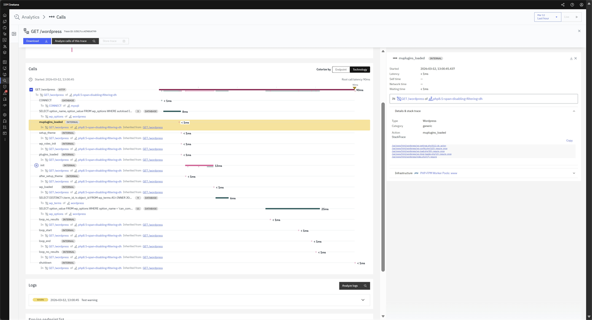

We have a webpage that creates many internal calls for the Wordpress framework and logs a warning message. The trace of the PHP script for the webpage is as follows:
PHP trace with Wordpress and logging spans

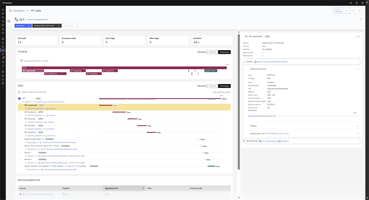

Opening the webpage now generates the following trace:
PHP trace without Wordpress and logging spans

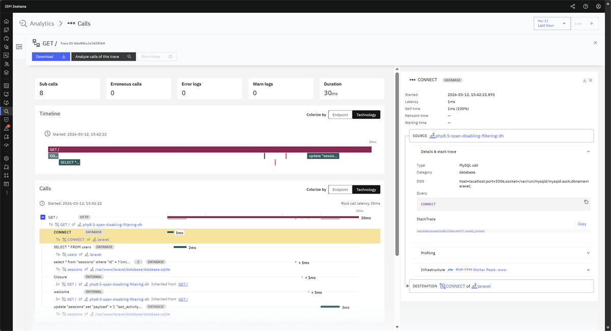

We have a webpage that makes database calls other than the MySQL calls that we are interested in tracing. The trace is as follows:
PHP trace with database spans

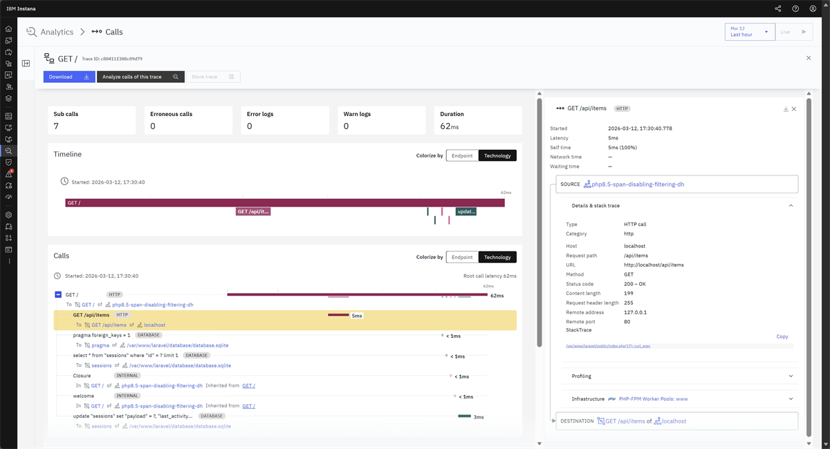

Then, the environment variable INSTANA_CONFIG_PATH=/etc/instana/config.yaml is set and PHP is restarted once. The new trace is as follows:
PHP trace with no other database spans except MySQL spans

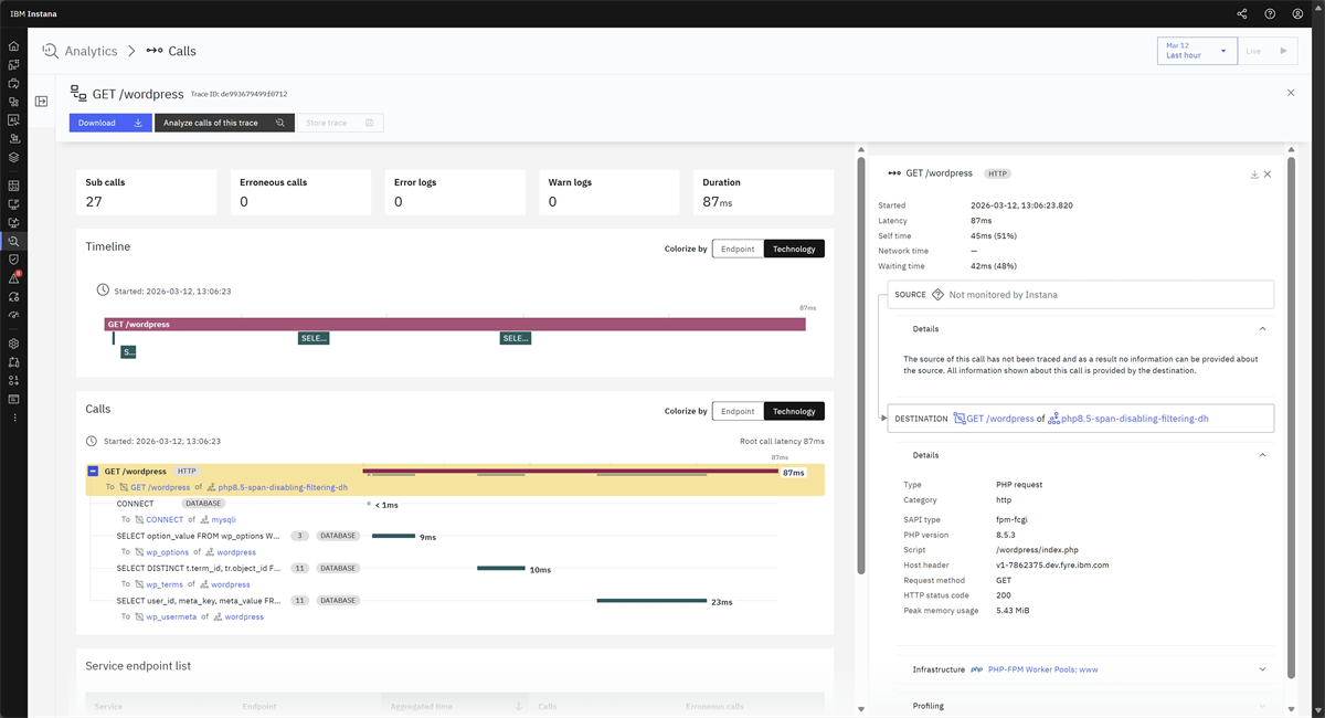

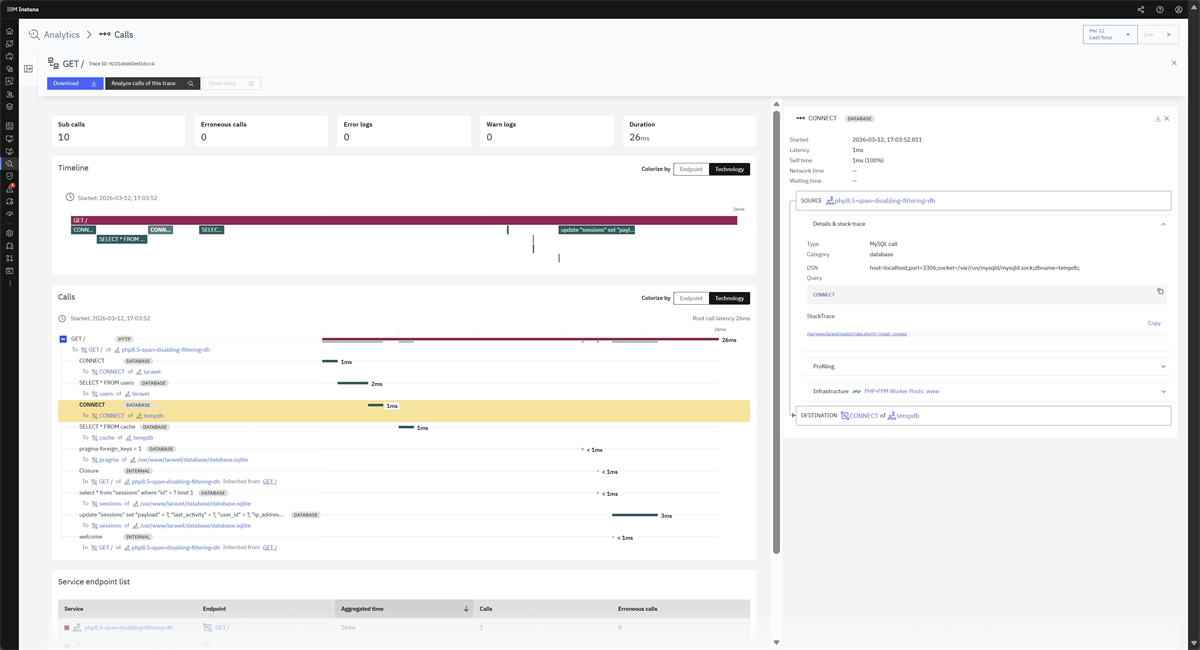

There is a webpage that queries a temporary database. We don't want to waste ingest capacity on it. The trace looks like this:
PHP trace with database calls including calls to a temporary database called tempdb
Let's filter out only MySQL calls on the tempdb database. The following is added to the agent configuration.yaml file:

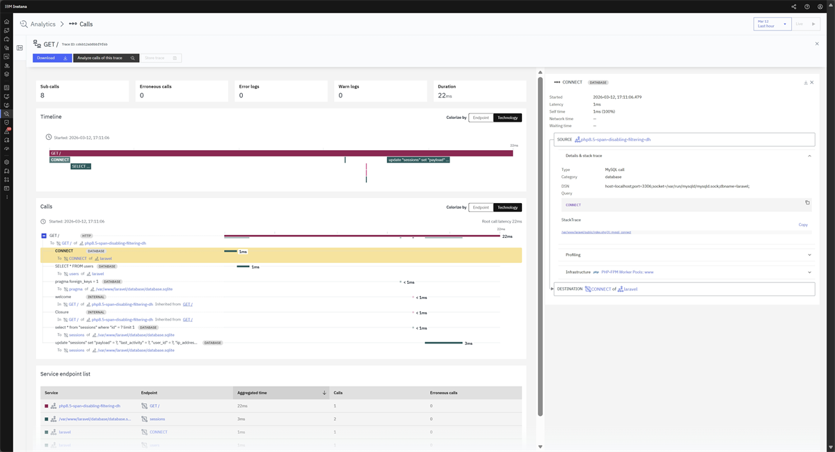

We restart PHP once and reload the webpage. The trace is now as follows:
PHP trace without calls to the tempdb database
