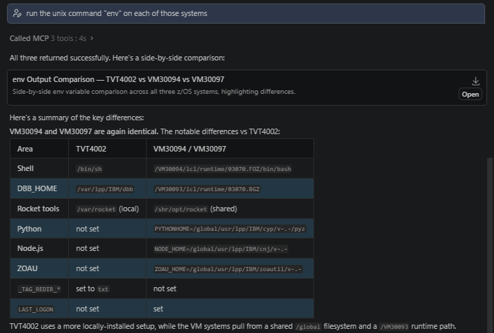

Example 1: Comparing environments across systems
To compare environment variables across three different z/OS systems, a simple prompt — "run the unix command 'env' on each of those systems" — is all it takes. IBM Bob invokes the RSEAPI MCP tools for each host in turn and returns the results side by side, making it easy to spot differences without logging into each system individually.
RSE MCP servers used in Bob

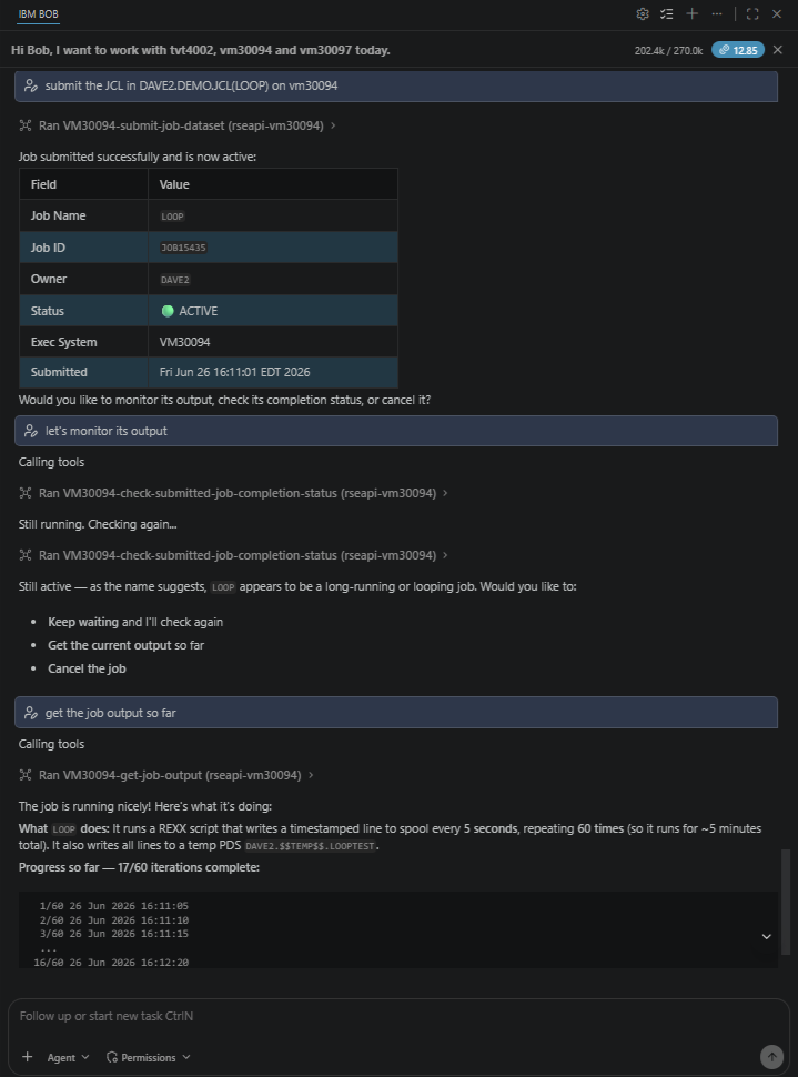

Example 2: Submitting and monitoring a job
To submit a JCL job on a specific system and monitor its output, just tell Bob what you want. Bob submits the job via the RSEAPI MCP server for that host, tracks its progress, and retrieves the output — no need to open a terminal or navigate a separate tool.
Working with Jobs using Bob and RSE MCP

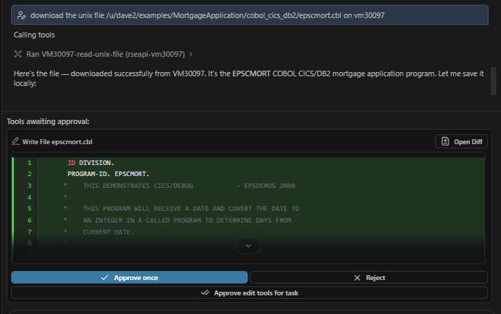

Example 3: Reading a z/OS UNIX file
To view the content of a UNIX file on a remote system, ask Bob to download it. Bob retrieves the file via the appropriate RSEAPI MCP server and offers to save it directly into your workspace — so you can view or edit it without leaving the IDE.
Working with UNIX files

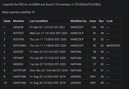

To see the most recently changed members in a PDS, ask Copilot to list the PDS members and their attributes, show the most recently modified 10 in a table.
RSE MCP server use under Copilot
