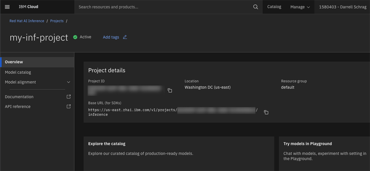

Setup a Red Hat AI Inference Service Project
Our first step is to setup a Red Hat AI Inference service project. From the project, you are going to want to save away the base URL for use later in the Lightspeed setup.
Inferencing Project

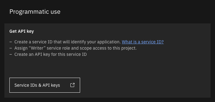

Get an API Key
Follow the instructions to create a Service ID and API Key for your Red Hat AI Inference service. Save that API key for use later.
Setup an API Key

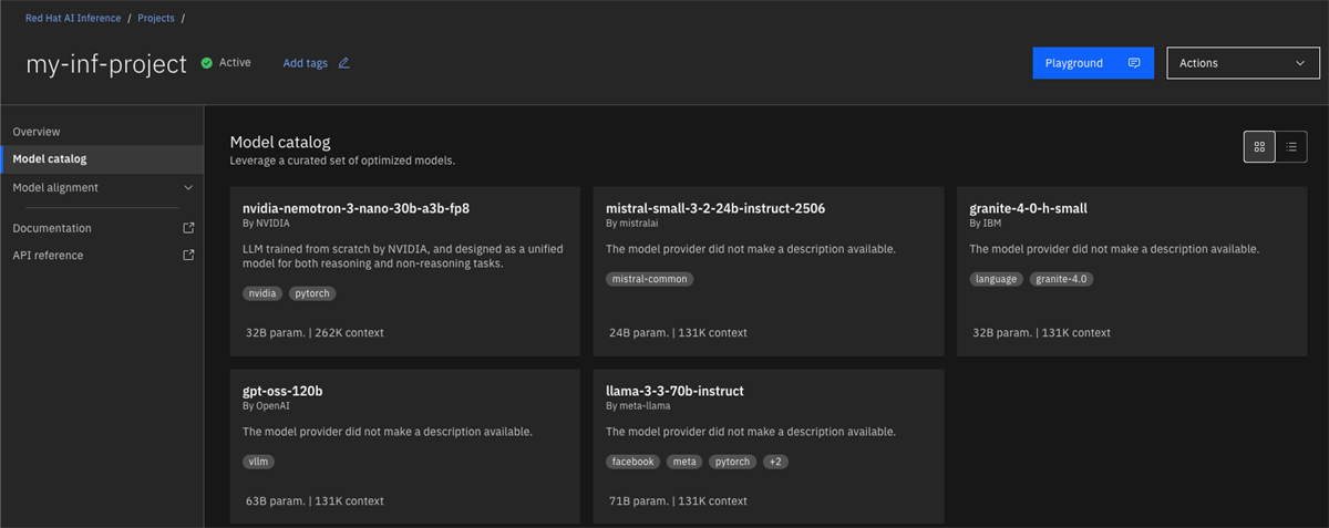

Explore the Model Catalog
Take a look at the available models in the Red Hat AI Inference service model catalog. Determine what model you want to use as your LLM for OpenShift Lightspeed. Save that model name for later.
Model Catalog

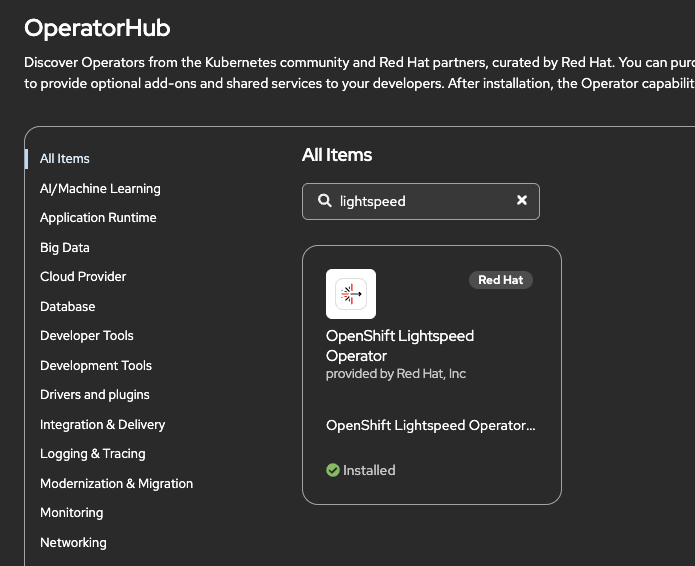

Install OpenShift Lightspeed
Over to your Red Hat OpenShift on IBM Cloud cluster. Open the OpenShift web console and go to the Operator Hub. Find the OpenShift Lightspeed operator and install it.
Lightspeed Operator

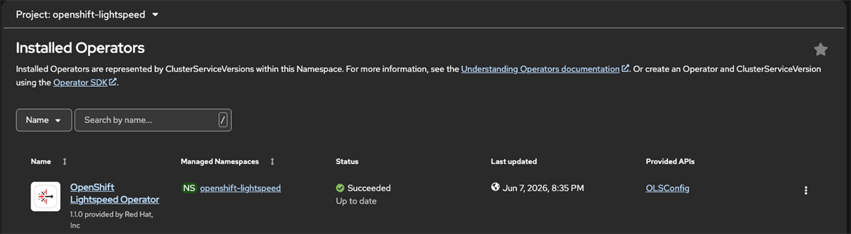

Once the operator has installed, you will have a new OpenShift project, openshift-lightspeed, and the operator will show a successful status.
Installed Operators

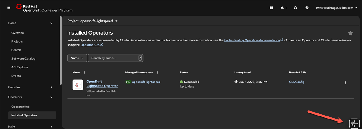

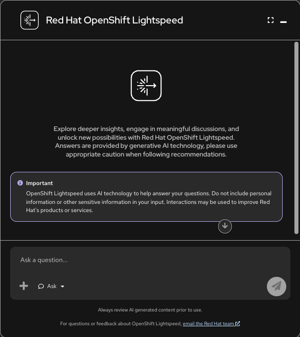

Now that we have everything setup, we can try out OpenShift Lightspeed. Open Lightspeed from the button in the lower right hand corner of the OpenShift console.
Lightspeed button
The Lightspeed window is now ready for us to ask an OpenShift question.
Give it a try.
Lightspeed
