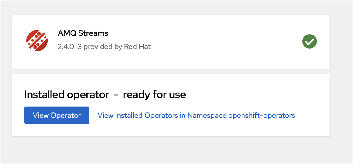

[Step1] In OCP UI, Check AMQ(e.g. 2.4.0-x) installed well within All Namespace.

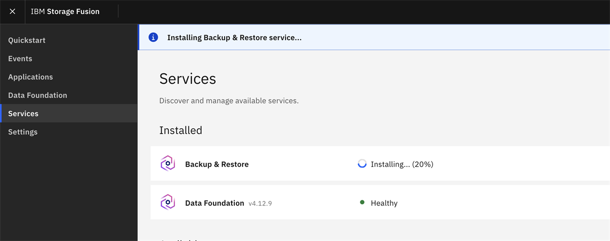

[Step2] In Fusion UI, install BnR-Hub service as normal.

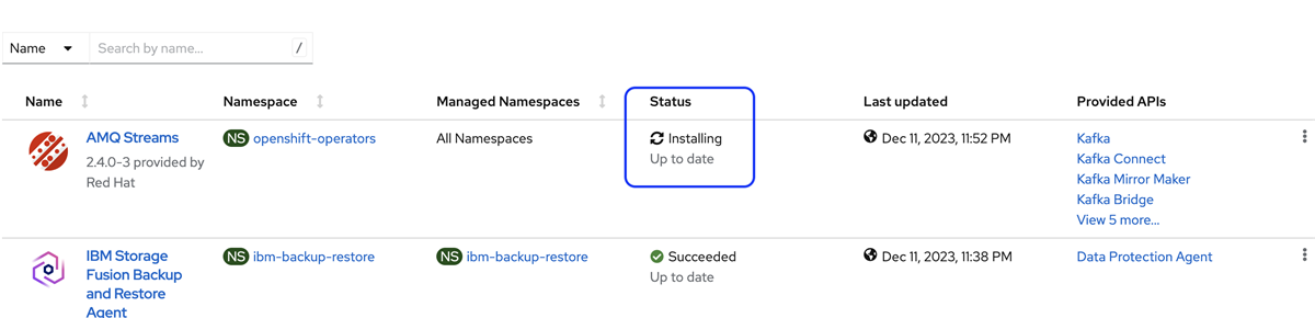

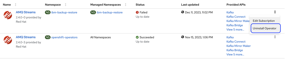

[Step3] During BnR-Hub installation, in OCP UI, AMQ Streams is installed with “Failed” in ibm-backup-restore namespace.
Meanwhile, from Fusion UI, BnR-Hub keeps installing.

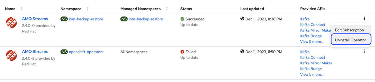

[Step4] Uninstall the newly installed AMQ Streams operator Fusion in ibm-backup-restore namespace.

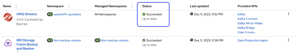

[Step5] In Fusin UI, monitor the BnR-Hub installation complete.
[Step6] In Fusin UI, try to backup an application to S3, then restore it, to verify BnR service works well. This also verify BnR-Hub co-work with global AMQ well.

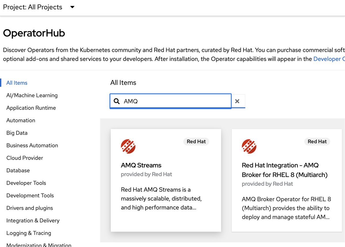

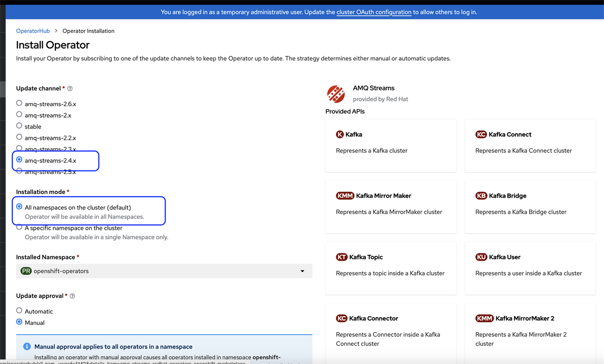

[Step2] Install a global AMQ in All Namespace from OperatorHub as normal, this is one of parts of business application. (As described above, if AMQ is installed in a specific namespace, it won’t impact BnR)

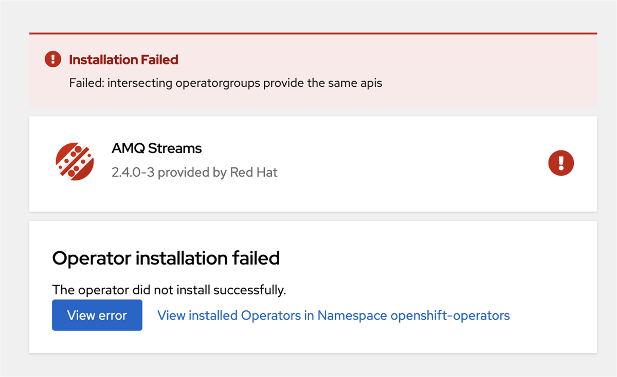

[Step3] Select the amq-stream-2.4.x, the “All namespaces on this cluster”, and “Manual” installation. Then launch installation. Encounter “Operator installation failed” error as expected.
[Step4] Uninstall the BnR’s AMQ operator from ibm-backup-restore namespace.

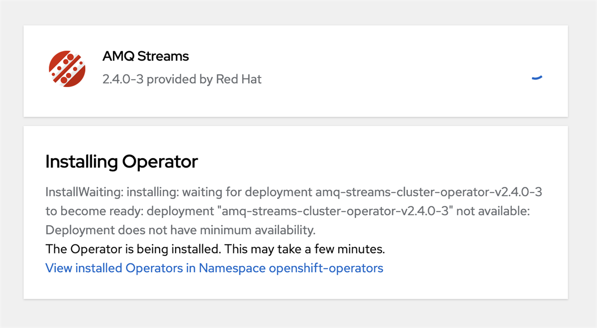

[Step5] After BnR’s AMQ installation, the global AMQ continues installation automatically until complete.

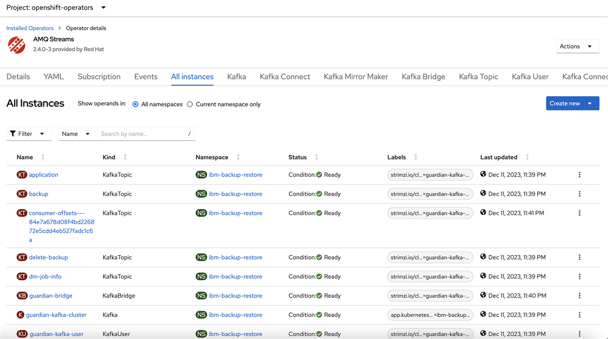

[Step6] Go to the detail page of AMQ, in the “All instances” page, verify BnR’s CRs have been generated under global AMQ.
