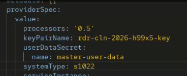

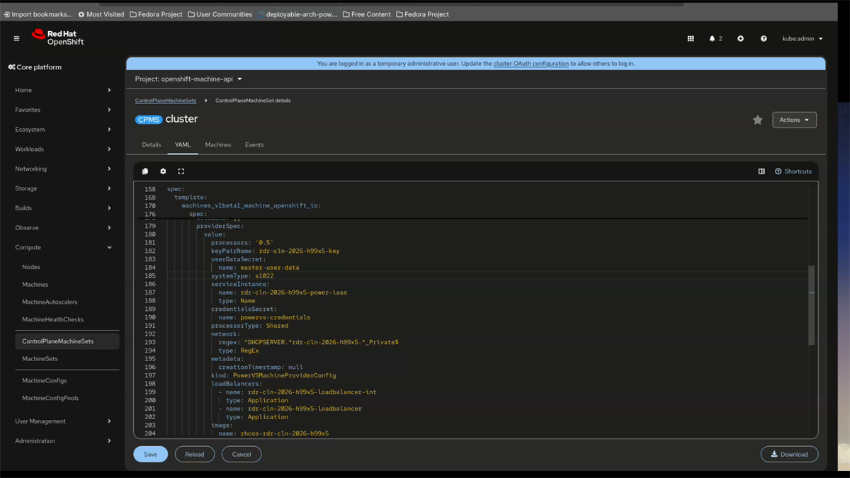

To upgrade your control plane, you only have to edit one file. You can do this by using the oc (or kubectl) CLI. I find the simplest way to make this update is using the OpenShift Console UI. Here is an image of the only change you need to make via the cluster console:
OpenShift Console displaying the control plane machineSet yaml
A zoom-in of the value to change in the yaml file
Change systemType to desired value
Locate the Compute section, expand to find the ControlPlaneMachineSets on the left, and edit. Change the systemType from s922 (or your current value), to s1022 (or your desired value), and click the Save button.
You could alternatively edit using the following oc command:
$ oc edit controlplanemachineset cluster -n openshift-machine-api
That is is it!
The control plane MachineSet has an update strategy type of "Rolling Upgrade." The cluster will now begin to provision new Machines in PowerVS and transition them to cluster Nodes.
