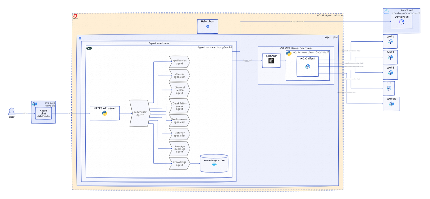

IBM MQ Agent architecture
At a high level, the MQ user/administrator simply makes requests to a chat window. This passes the requests to the IBM MQ Agent, which uses an LLM to decide what the request means, what information it needs to gather and interpret before responding to the user. Mostly the agent gathers information from queue managers, but it also has access to a knowledge store of documentation, and of course the knowledge trained into the LLM itself. As we will see, these multiple sources of information can conflict with one another in some intriguing ways.
MQ Agent
There are a few components that make up the IBM MQ Agent architecture. The agent chat extension, the agent itself, a knowledge store, the LLM, a model context protocol (MCP) server, and of course the queue managers themselves. Let’s look at each of these in turn.
Agent Chat Extension
This is a chat window that can be configured in the MQ Web Console from IBM MQ 9.4.5 onwards. It forwards the natural language requests from a user to the Agent over an HTTPs-based API.
One IBM MQ Agent can support multiple chat assistant sessions. So multiple different users can have simultaneous independent conversations with the same agent.
Agent
The Agent is a Python application based on the LangGraph framework. It receives a users’ natural language requests from the Agent Chat Extension and orchestrates calls to LLMs, knowledge bases, and queue managers, then responds to the user. This is the heart of the solution and gets a more in-depth explanation later in the article.
At the time of writing the Agent and the associated MCP Server are containers that live together within a single Kubernetes pod. This design won out for reasons of minimised latency and simplified security. The alternative of having them in separate pods, would offer independent scaling, and re-use of the MCP server, which may become more important in the future. They are installed using supplied helm charts and are currently only supported on the OpenShift Container Platform.
MCP Server
The MCP Server provides connectivity to all the queue managers, so the agent doesn’t need to worry about initiating and maintaining connections, nor how to perform the variety of different commands needed to gain status from them. The agent can only communicate with queue managers via the MCP server, which is “read-only” – in other words it can’t perform any operations on the queue managers that would change their state or configuration.
MCP provides descriptions of the capabilities it hosts. In this case, it describes type of information it can get from the queue managers. These descriptions enable the LLM to prepare a plan of action to resolve your requests.
The MCP server is written in Python and uses the FastMCP framework to simplify MCP exposure over HTTP. For those in the know, we currently use the streamed HTTP variant of the MCP protocol.
To talk to the queue managers, it uses the recently refreshed IBM MQ Python client over a TLS secured connection to send PCF commands over the Message Queue Interface (MQI). This is a well-established administrative interface to IBM MQ, and so benefits from all of the audit and security capabilities that MQ administrators are already familiar with.
Vector database
The agent, and indeed the LLM, need access to a trusted and curated set of reference data about IBM MQ. As such we have a dedicated vector database, populated with a specially prepared cocktail of IBM MQ documentation. This enables the agent to respond to questions about concepts in IBM MQ and helps with the wording of responses generally. It also gives the agent trusted knowledge about how IBM MQ works to help with its reasoning and planning of more complex queries.
The vector database is delivered as part of the agent container, helping to reduce latency of requests, simplifying the security model, and providing a simple way to deliver updates to the reference data.
LLM
The MQ Agent uses large language models (LLMs) to interpret your questions, make plans on how to gather the information necessary to answer them, evaluate the resulting information, and formulate its responses back to you. It uses different types of models for different purposes. At the time of writing, it uses three models: IBM Granite and GPT open-source models for differing types of general reasoning, and IBM Slate (embedding model) for retrieval from its internal knowledge base. The latest information on models used is listed in the documentation.
Today IBM MQ Agent accesses these LLMs from a separately obtained IBM watsonx.ai runtime in an IBM Cloud account. We are exploring other model deployment options including the use of on-premise models, which are likely to be popular, especially with the current focus on data sovereignty.
We expect we will remain opinionated on the models used for different purposes. We have tested many and the current choices give us the best value for tokens, best performance, and best quality responses.
Queue managers
The MCP server is given an explicit list of queue managers to which it can connect. It should be noted that this is a separate list to the ones accessible to the MQ Web Console, and this can be handy from a governance perspective. The number of queue managers per agent is currently limited to 20, but you can of course have multiple agents, each with a specific set of queue managers, to suit different roles in the organisation.
The various queue managers can be on a variety of different platforms and form factors of IBM MQ and can even have different security mechanisms specified if necessary. It reads the queue manager connection information from a CCDT stored in a Kubernetes secret.
The agent can connect to queue managers at any version level of IBM MQ but will of course only be able to use the features available at that level. A good example of this is the introduction of access to queue manager logs via the PCF interface in v9.4.5. This was in part introduced for the MQ Agent, to enable it to draw information from the queue manager log without needing direct access to the underlying file system.
Deep dive into the agent application
The agent itself has a modular design, with one overarching “supervisor” agent, which then orchestrates requests across a number of more targeted “specialists”. These in turn know how to make use of the MCP Server for particular types of enquiry.
The agent is built on the LangGraph/LangChain framework because it enables a combination of LLM based reasoning and deterministic behaviour. A common theme in Agentic AI design is that you only want the LLM reasoning on things that you couldn’t have done deterministically. The most efficient and effective agents have specialist knowledge burnt into them where the path is obvious and only reach out to LLMs for broader help on reasoning. We have therefore put significant investment into codifying subject matter expert (SME) knowledge of diagnostic workflows into the solution. In this first use case, this includes complex decision paths around how queue build up issues are commonly diagnosed. This both saves money on tokens (frontier models can be expensive) and improves the quality and speed of responses.
Furthermore, there are Watsonx.ai plugins for LangGraph/LangChain enabling rapid integration for the initial LLM usage whilst retaining the option to support more sources of LLMs in the future.
