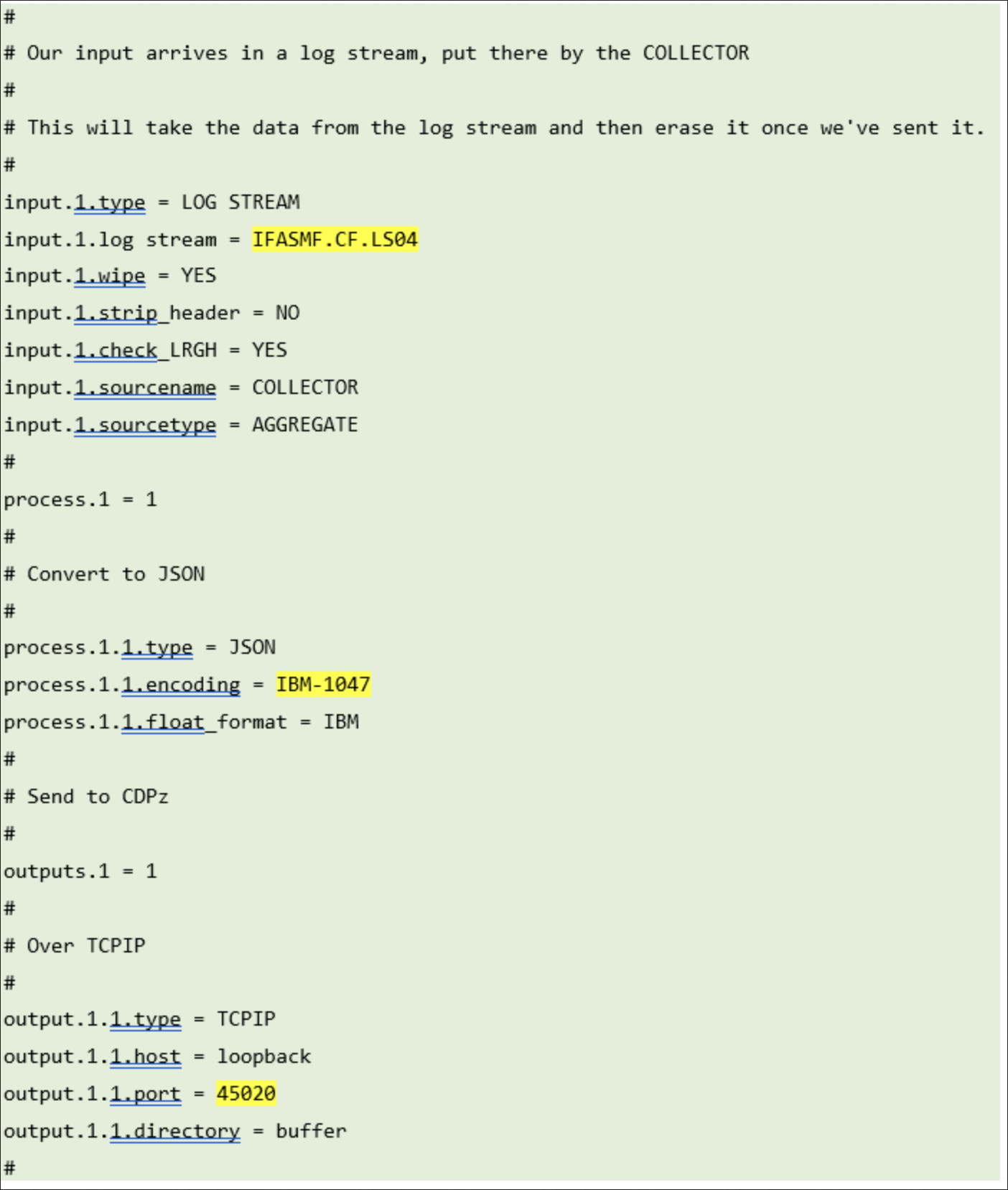

CUSTOMIZE THE PUBLICATION DATA MOVER PROPERTIES
Edit the Publication.properties file in the IZDS/publisher/config directory as follows:
• Change input.1.log stream to the newly created publication log stream name.
• Change process.1.1.encoding if your system uses a code page other than the default IBM-1047.
• Change output.1.1.port to the output port on the TCPIP stage that the IBM Common Data Provider for z Data Streamer is listening on.
