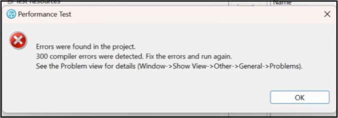

Common Symptoms of Workspace Corruption
 Workspace corruption typically manifests through generic and high-volume errors such as:
  1. Errors were found in the project. 100 / 300 compiler errors were detected
  2. Scripts failing to build even though no recent changes were made
  3. Sudden appearance of errors across multiple projects
  4. The src folder in the project contains some issues, and a cross mark may appear
The number of compiler errors may vary, from a single error to hundreds, but the underlying issue is often the same: the workspace metadata is no longer reliable.

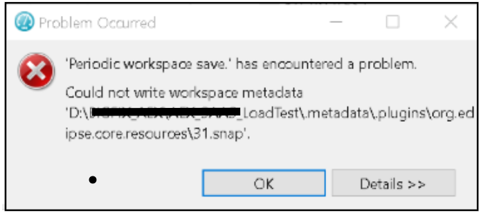

Metadata Write Failures
 A more explicit indicator of workspace corruption is an error message similar to:
 “Periodic workspace save has encountered a problem. Could not write workspace metadata … .metadata\.plugins\…”
Although the workspace name or directory path may differ, this error strongly points to a corrupted or locked workspace metadata area.

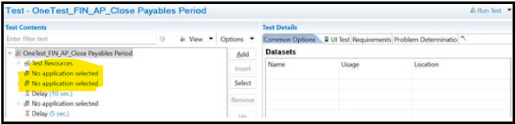

Typical Import / Export Error Symptoms
 When assets are imported without dependencies, you may see errors such as:
  1. Tests showing No application selected
  2. Build or validation errors immediately after import
  3. Missing datasets, schedules, or shared resources
These errors do not indicate workspace corruption. Instead, they indicate that required dependencies were not included during export or import.

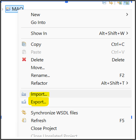

Correct Way to Export Test Assets
 To avoid dependency-related issues, always export assets using the Test Assets with Dependencies option.
  1. Right-click the project.
  2. Select Export.
  3. Choose 'Test Assets with Dependencies'.
  4. Complete the wizard and save the archive file.

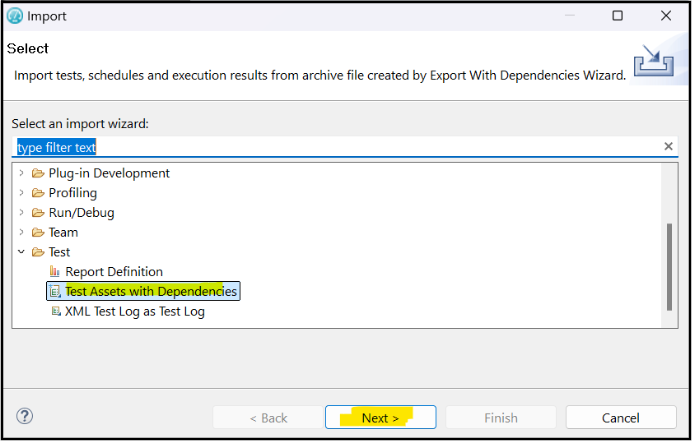

Correct Way to Import Test Assets
 In the target workspace:
  1. Right-click and select Import.
  2. Navigate to Test → Test Assets with Dependencies.
  3. Browse to the exported archive file.
  4. Finish the import and allow the workspace to rebuild.
Important Clarification
Errors such as 'No application selected' or build failures after import are dependency issues, not workspace corruption. Re-importing assets correctly usually resolves them without requiring a new workspace.
