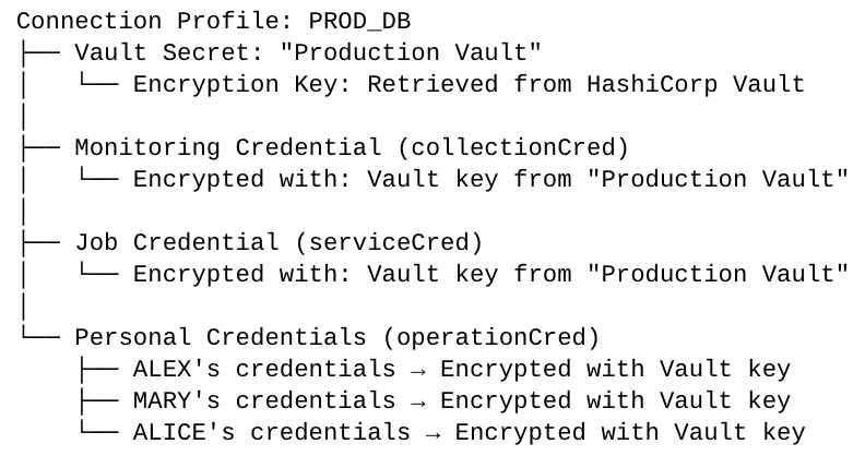

Encryption Scope
When you enable "Use password encryption key store" for a connection profile, all credential types are encrypted with the Vault key:

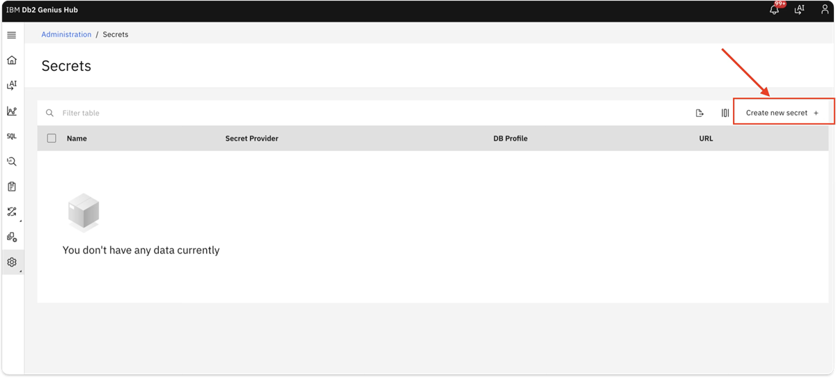

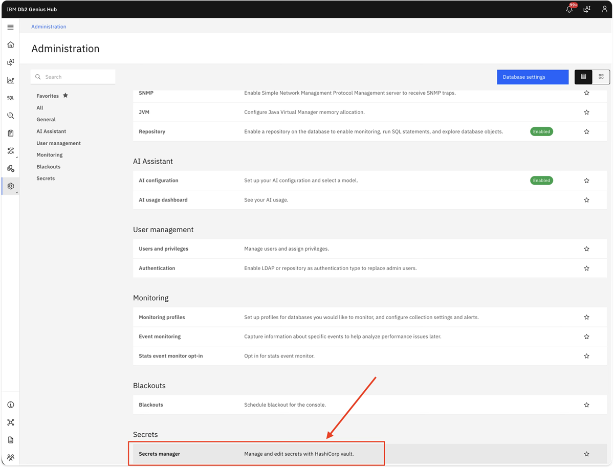

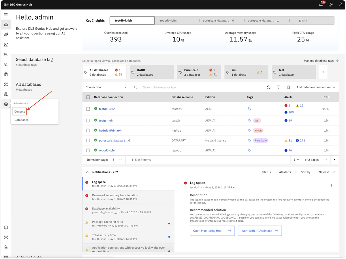

1. Navigate to Administration > Console > Secrets Manager
Navigate to Administration > Console > Secrets ManagerNavigate to secrets manager

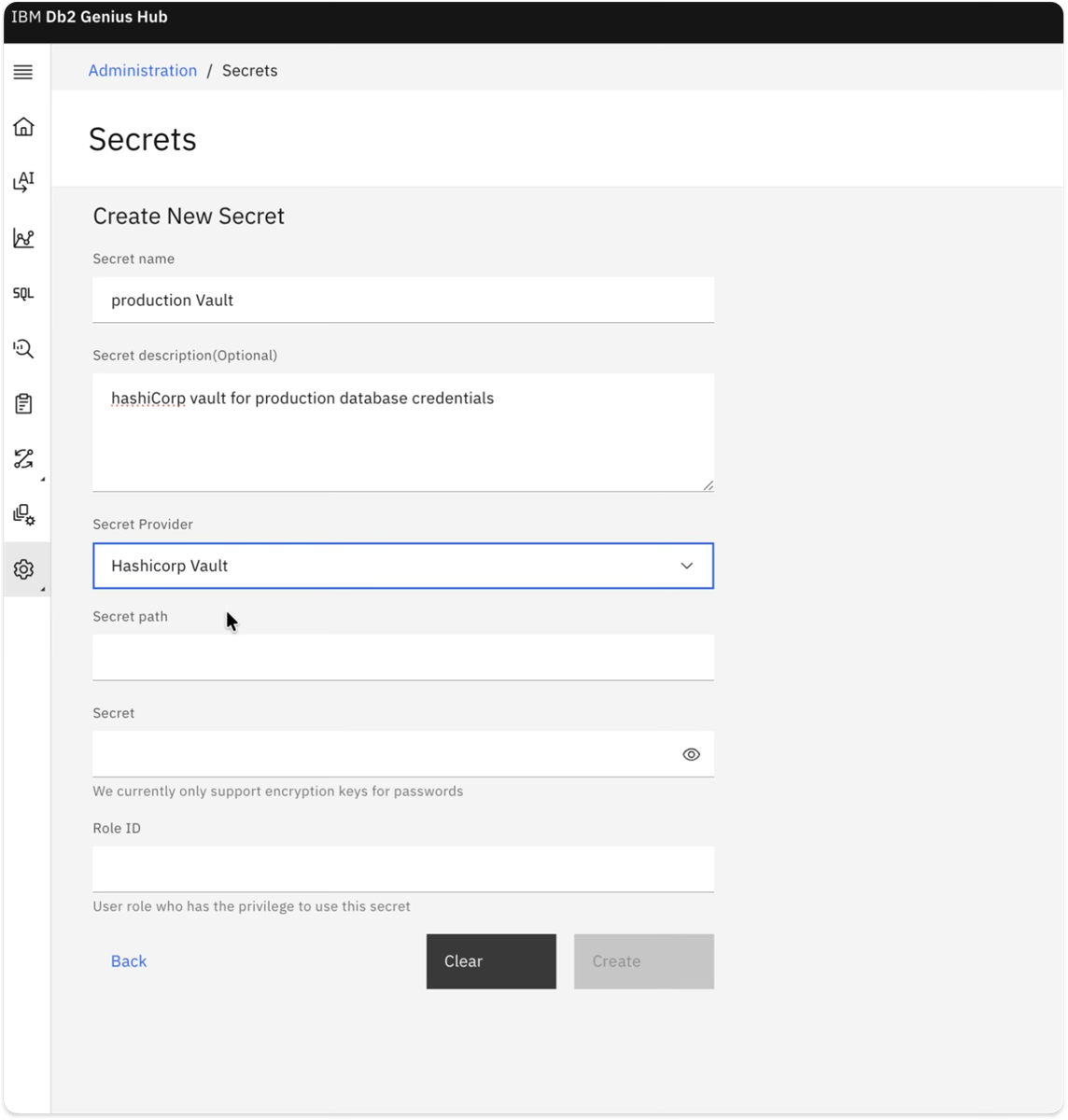

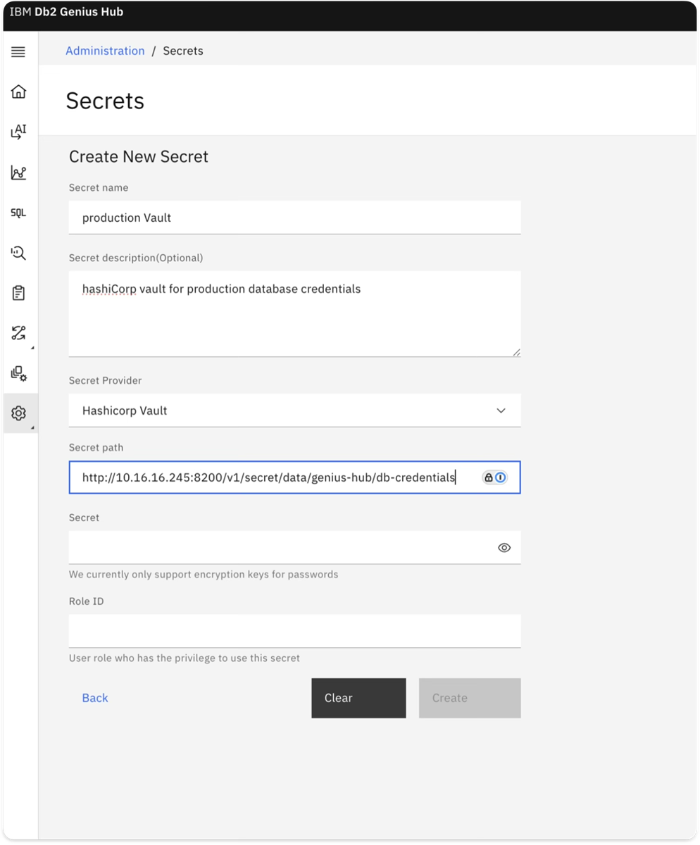

2. Click Create New Secret
Create new secret

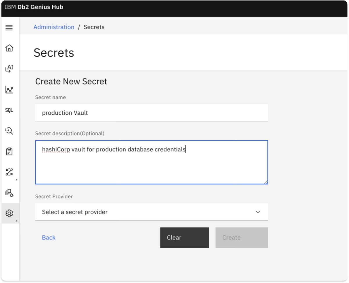

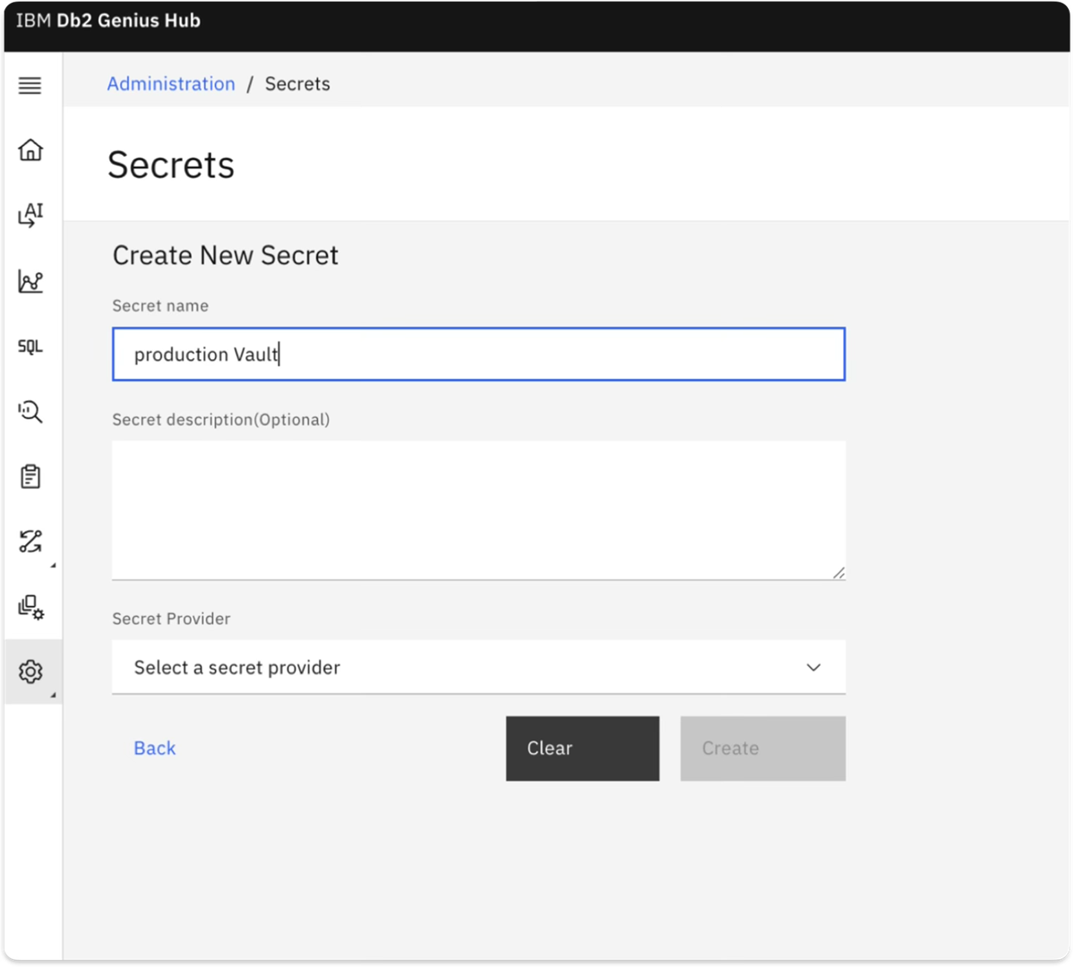

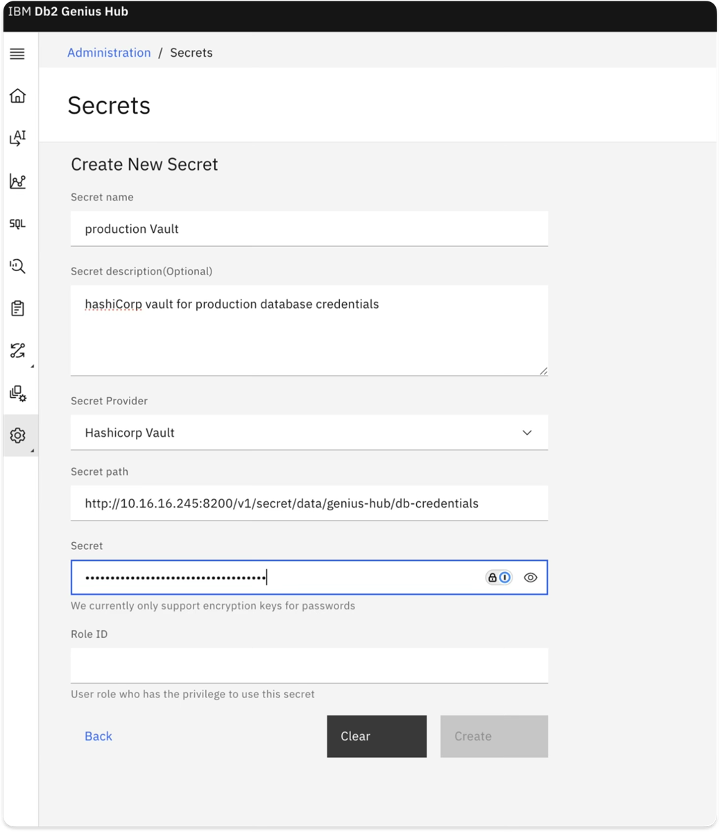

3. Fill in the required fields:
(i) Secret name: Descriptive name (e.g., Production Vault)
Enter secret name
(ii) Secret description: Optional documentation
Enter secret description
(iii) Secret Provider: Select HashiCorp Vault
Select secret provider

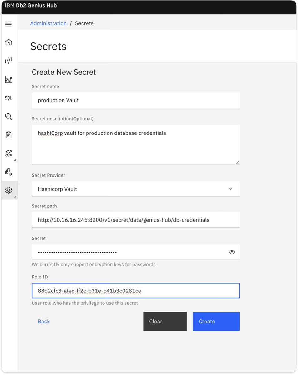

(iv) Secret path: Full Vault URL with API path (e.g., https://vault.example.com:8200/v1/secret/data/genius-hub/db-credentials)
Enter secret path
(v) Secret ID: AppRole Secret ID from Step 1
Enter Secret ID
(vi) Role ID: AppRole Role ID from Step 1
Enter Role ID

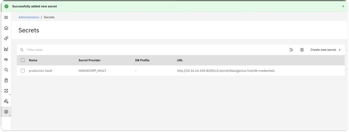

4. Click Create to save

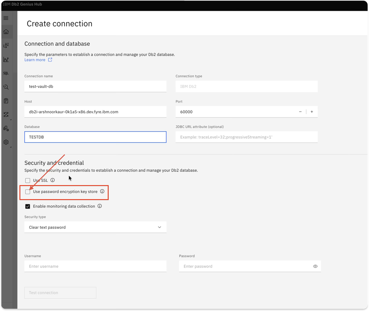

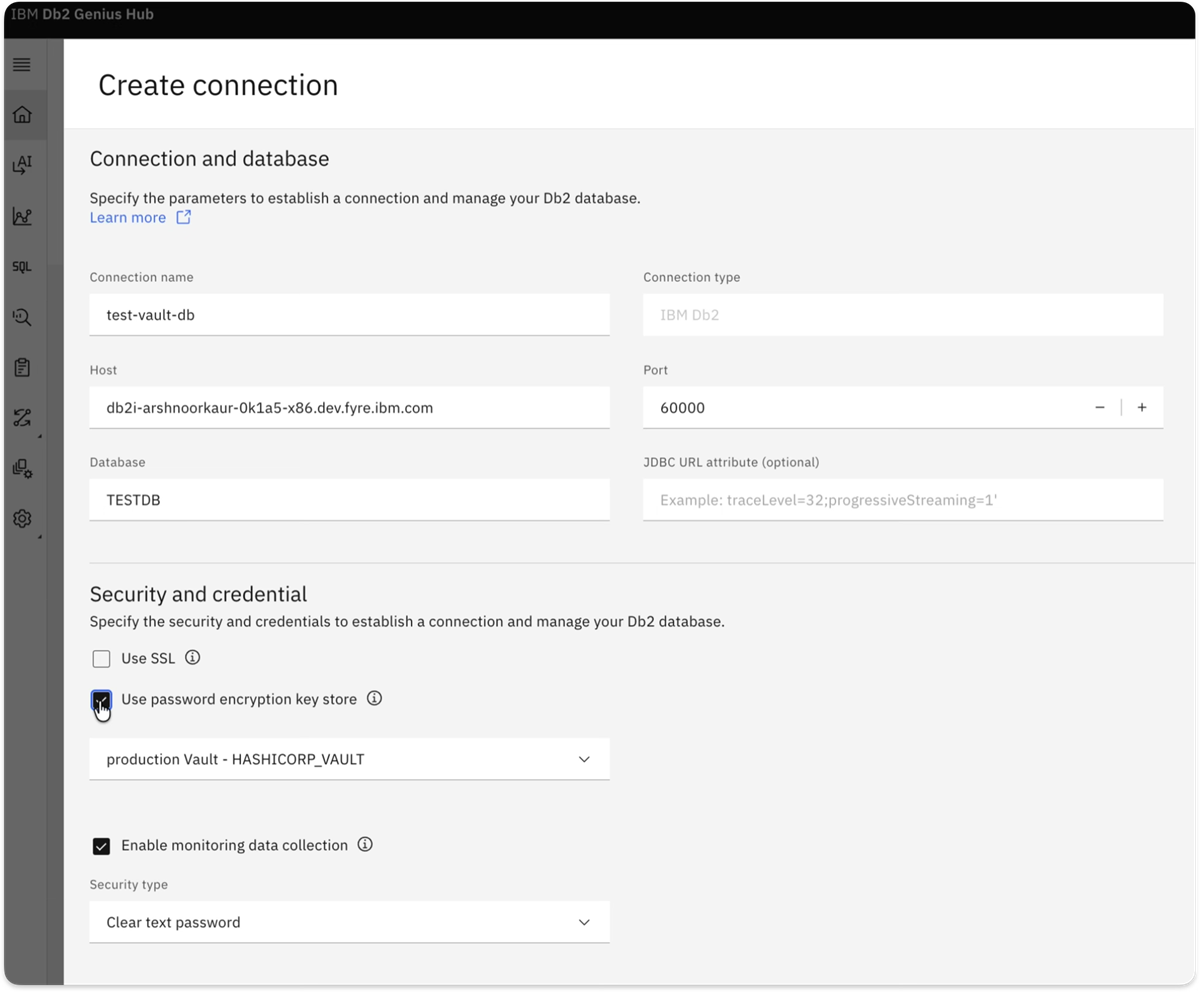

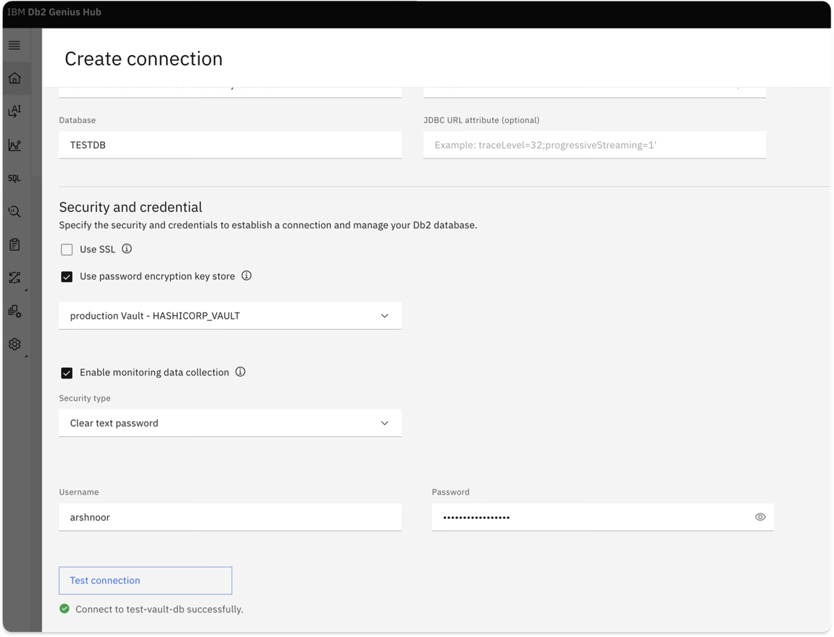

Step 4: Use the secret for database connections

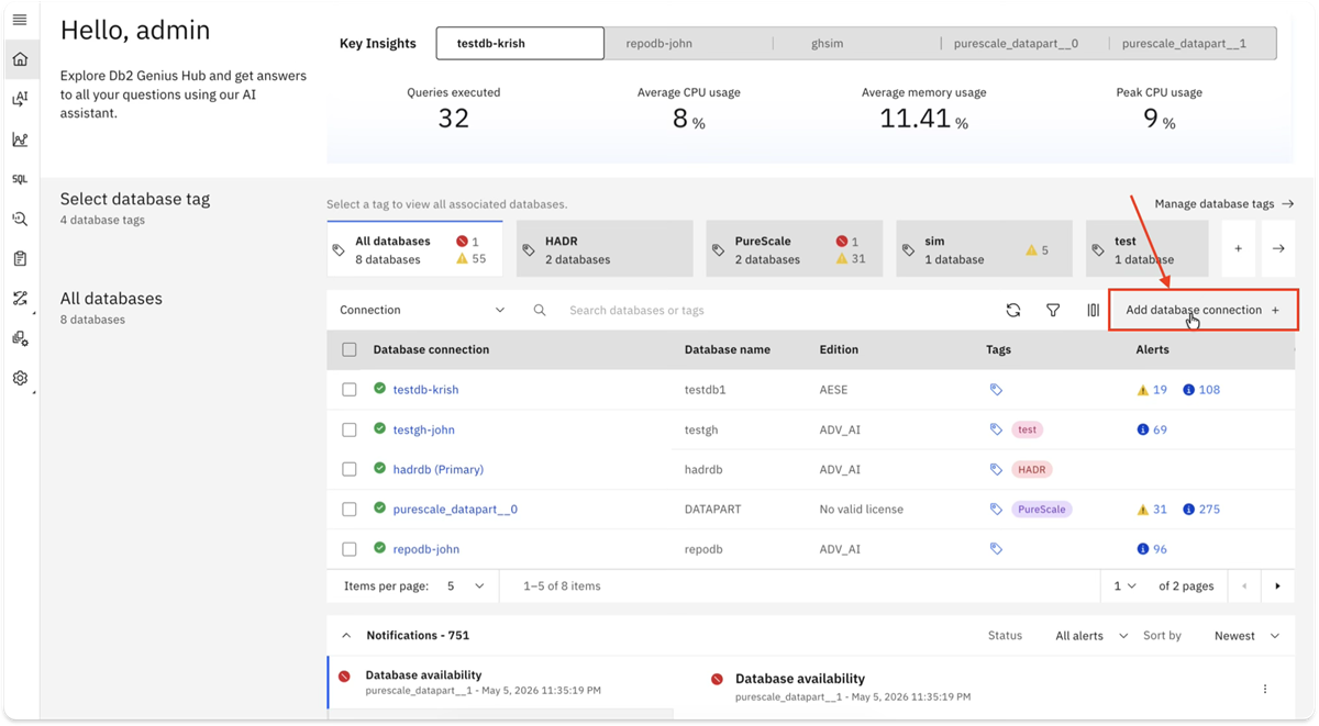

When creating or editing a database connection:
  1. Navigate to Connections > Add database connection (or edit existing)
  2. Fill in connection details (hostname, port, database name)
  3. Enable Use password encryption key store
  4. Select your secret profile from the dropdown (e.g., Production Vault)
  5. Enter credentials for monitoring, job, and personal access
  6. Click Save
All credentials for this connection are now encrypted using the key stored in HashiCorp Vault.
