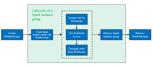

The flow chart below demonstrates the lifecycle of a Spark instance group, from creating a notebook type to deleting that notebook type. In this post, we are going to take a closer look at the process within the dotted lines: assigning and unassigning users to notebooks, and using notebooks.image

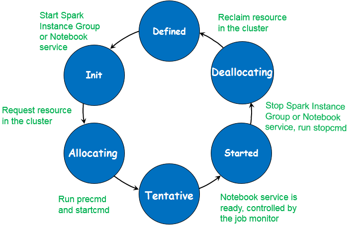

When a user is assigned to a notebook, Platform Conductor allocates resources to create the notebook service, then dispatches the notebook service to an available node in the cluster. When the notebook service starts, it is listed in the “DEFINED” state. The diagram below illustrates the lifecycle of a notebook service. States are defined inside each circle (in white), and the action that triggers the transition of each state is outside each circle (in green).
Once started, the notebook service quickly transitions to the “STARTED” state, meaning the notebook daemon started successfully and the notebook is ready for the assigned user to use it. You can now launch the notebook from the browser.

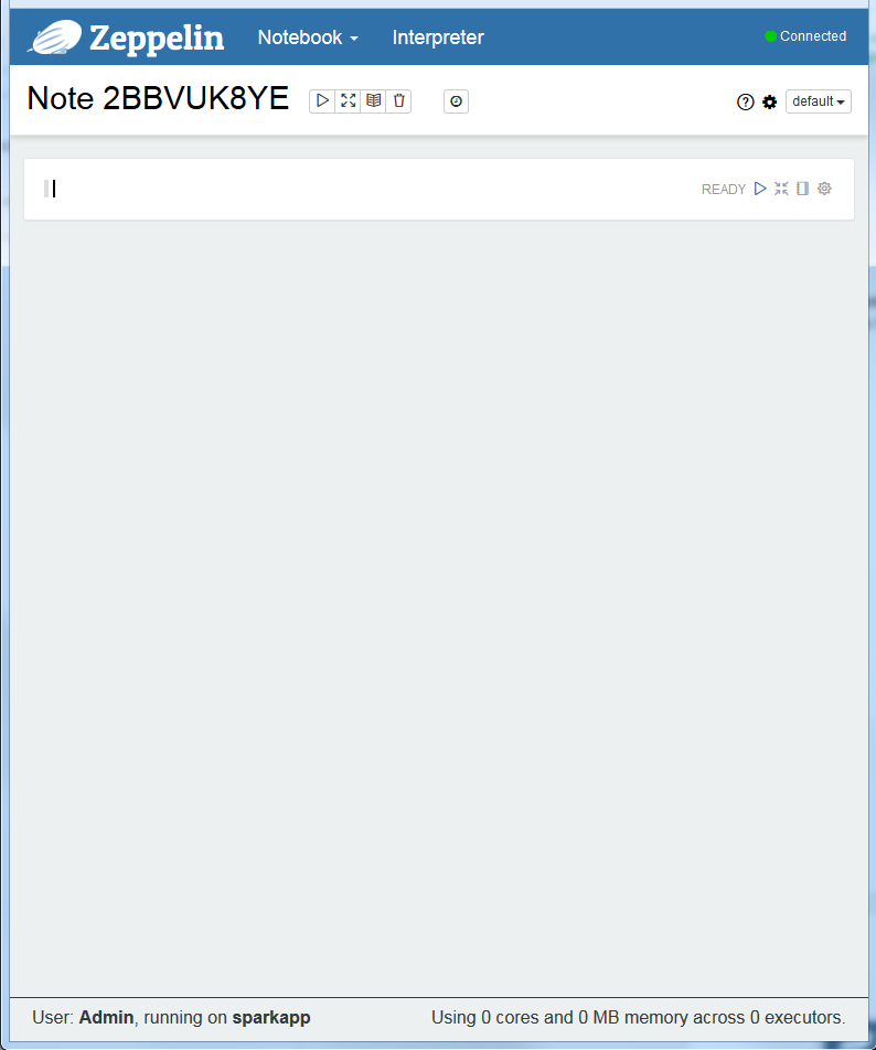

Here’s a sample interface of the built-in Zeppelin notebook:

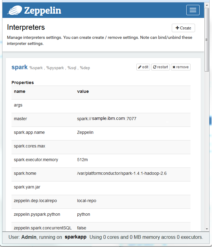

Notebooks introduce the notion of “interpreters”, which are plug-ins for language and data processing. Zeppelin notebooks, for example, support Scala, Python, SparkSQL, Hive, Markdown, and Shell interpreters.

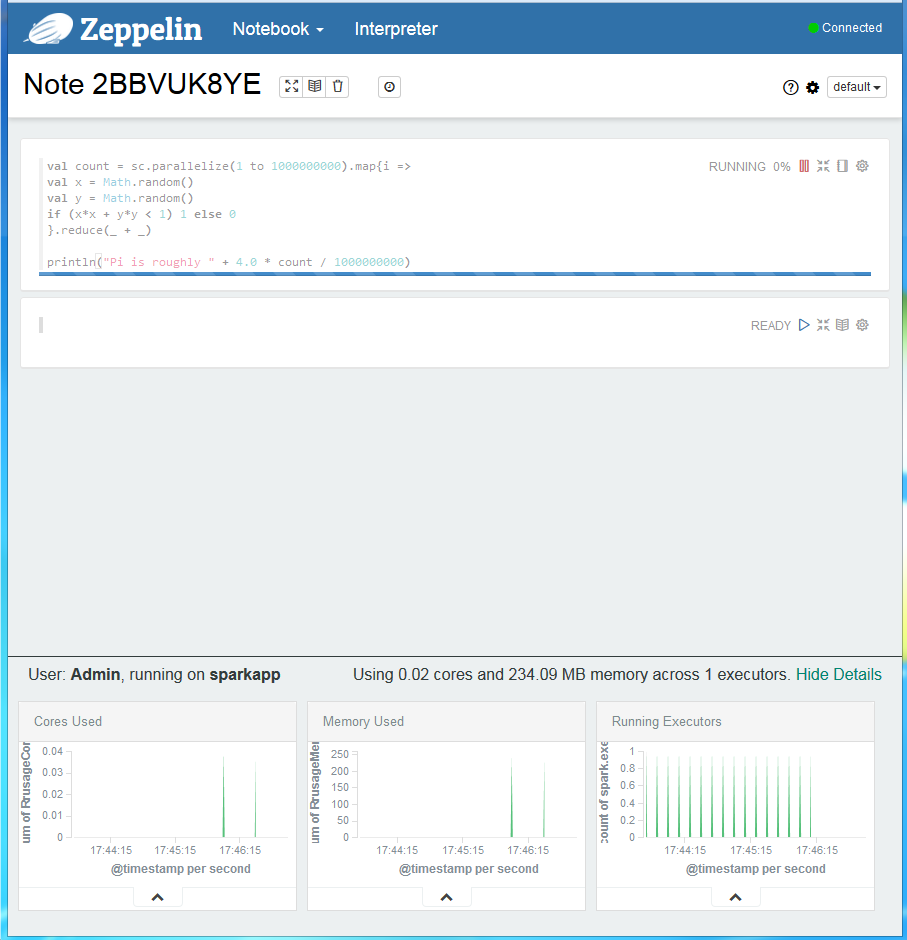

Sample code for Zeppelin notebook
The following is an example of a Spark application that calculates the value of Pi:
val count = sc.parallelize(1 to 1000000000).map{i =>
val x = Math.random()
val y = Math.random()
if (x*x + y*y < 1) 1 else 0
}.reduce(_ + _)
println("Pi is roughly " + 4.0 * count / 1000000000)
More sample code can be found in the following Zeppelin tutorial:
https://zeppelin.incubator.apache.org/docs/0.5.0-incubating/tutorial/tutorial.html

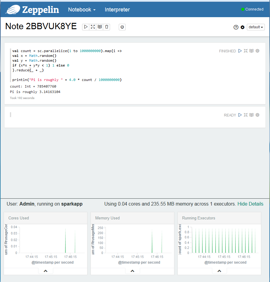

After a short while, the result is outputted as follows:
Note that Platform Conductor monitors the cluster CPU, memory, executor, host, and other usage statistics at all times for analytics. These functionalities are enabled through the ELK stack integration.
