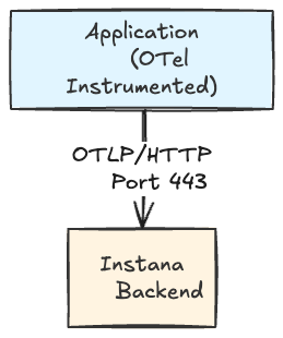

Sending traces directly from your application to Instana
This diagram shows the direct export flow where your application sends traces straight to Instana's OTLP endpoint without any intermediate components.
This is the simplest possible setup: your application sends traces directly to Instana's OTLP endpoint. I started with this approach because it provides the fastest way to verify that the instrumentation is correct, traces are being generated, and data is successfully reaching Instana.
