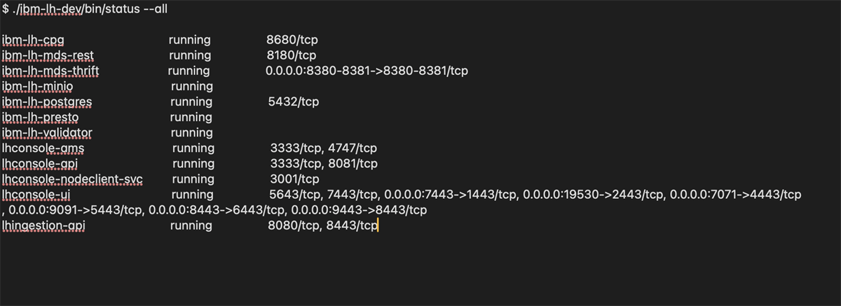

6) Verify Milvus service status
$LH_ROOT_DIR/ibm-lh-dev/bin/status --all
$LH_ROOT_DIR/ibm-lh-dev/bin/start-milvus   # start if needed
$LH_ROOT_DIR/ibm-lh-dev/bin/stop-milvus    # stop when needed
Once startup is complete, check the status and note the ports

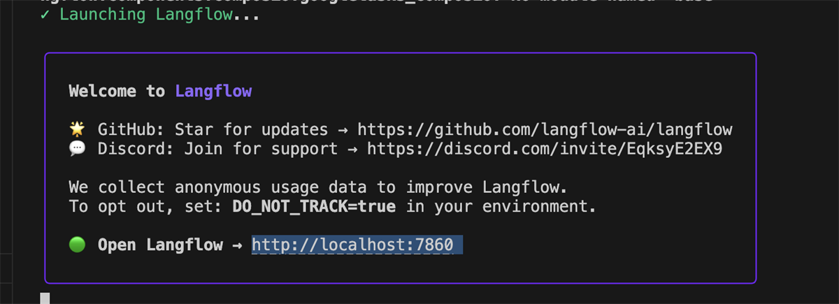

Run Langflow
langflow run
# By default, Langflow launches at: http://localhost:7860

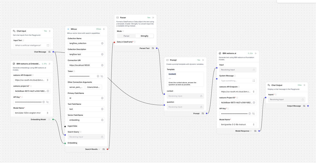

Connecting Langflow to IBM Milvus
  1. Open the Langflow Playground (http://localhost:7860).
  2. Drag the Milvus component to the canvas.
  3. Enter connection details:
  • Connection URI: https://localhost:19530
  • Collection Name: langflow_collection
  • Primary Field Name: id
  • Text Field Name: text
  • Vector Field Name: embedding
Then add IBM watsonx.ai Embedding and Model components, configure API endpoint, project ID, and API key. For embeddings use ibm/slate-125m-english-rtrvr; for LLM use ibm/granite-3-2-8b-instruct.

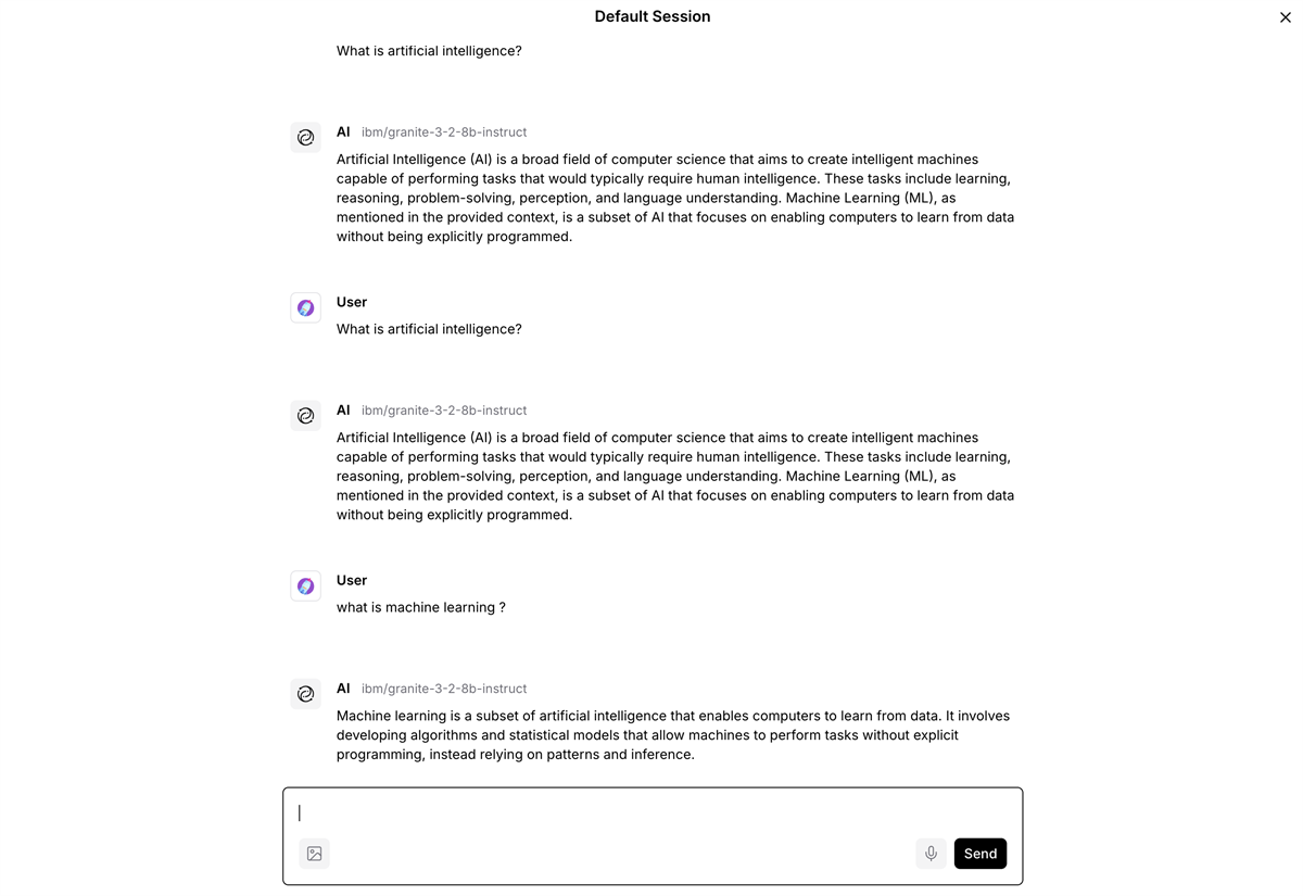

Step 4 — Try Langflow Playground
Try the playground option on the top right corner of the langflow window and start querying there.
